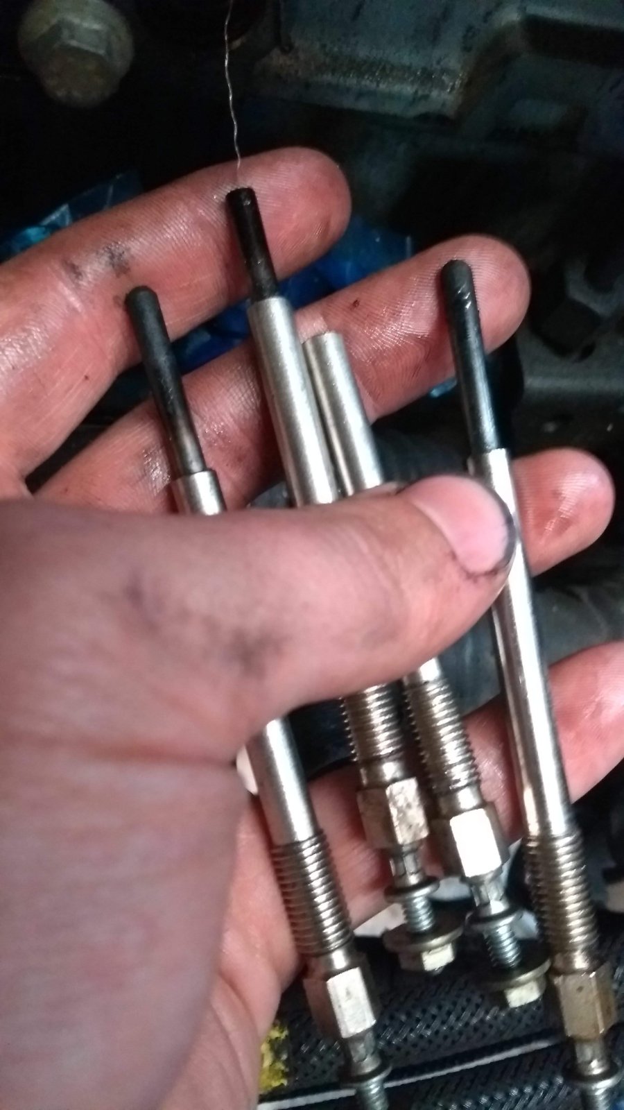

I agree. This was result of carefully trying to remove mine (2004 206 1.6 HDi DV6)
Tested all and none were working. Car started fine in that state. I decided to check and change them whilst doing other work (turbo failure) - ended up taking head off to retrieve the bits missing from the pictured old glow plugs.
