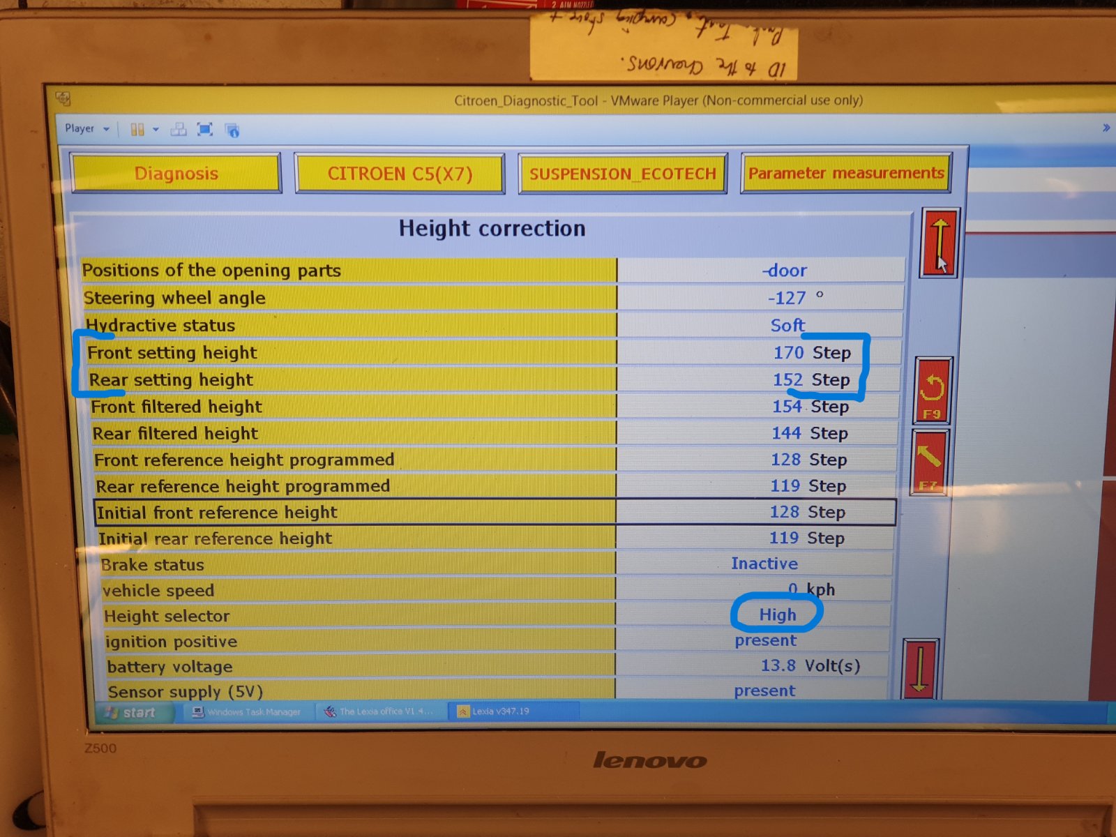

I was changing the transmission fluid today and had the Lexia connected to observe the fluid temperature reaching 60 degrees C. After the longwinded fluid change I had a look at the suspension diagnostic and looked at the readings for the ECU. This is the data for the suspension at normal height. As far as I can tell the 2 lines 'Front setting height/ Rear setting height' are the number of steps of each height sensor data for the set position of the 'Normal' position. I know this because these values change to two higher numbers when you press the up button once to raise to the intermediate position and their values increase further when you press up again to raise to maximum height.
The 2 lines 'Front Filtered height/ Rear filtered height' appear to be the actual data from the front and rear sensors. Pushing the suspension down makes them change live and you can see they have a value that's close to the 'setting heights'. Presumably there's a type of fuzzy logic or range that is acceptable to be 'close enough' to the set heights likely because the data will be always changing with the vehicle in motion.
What I found when raising the height to intermediate and high positions is that the steps data from the front height sensor stops at 154 step where the 'High' setting wants it to raise to 170 step. The rear continues up to the demanded step of 152 and appears to function normally. Why does the front data not go beyond 154? This is obviously the reason why it never stops the pump - it doesn't think it ever reaches the 170step value at the front..
Here's the picture of the data at 'High' position: It is like the data runs out after the front suspension raises by an amount and the ecu keeps trying to raise the front above 154 step to get to 170 but never does.

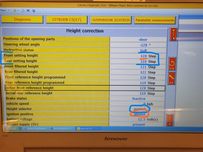

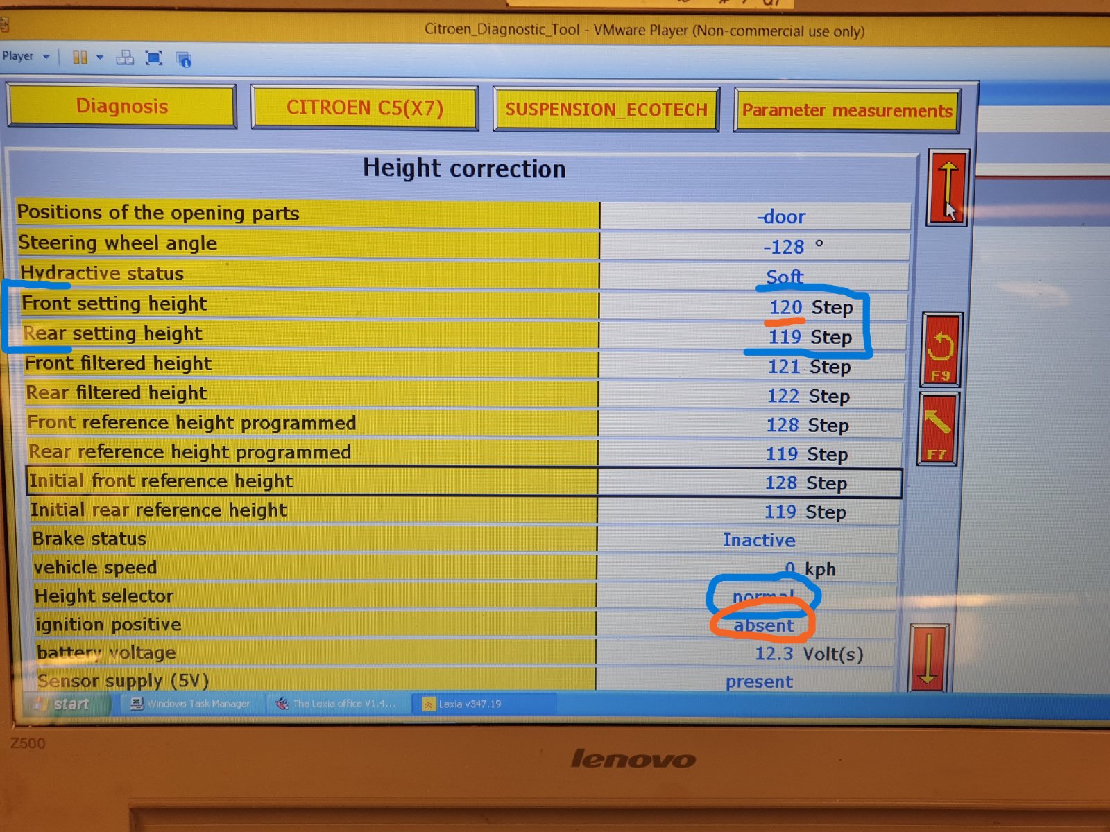

Anyway, I don't know what's wrong with mine (it's a brand new front sensor) but might be related issue?
I did discover something that answers my question from another thread. I wondered why the front suspension drops down a bit when the ignition is turned off. Well, I turned it off with the diagnostic hooked up and as soon as the ignition is turned off - indicated on the diagnostic as: "ignition positive - absent" - you see that the 'setting height' for the front changes from a normal height of 128 steps to 120. So the drop down is designed in. I assume then that Citroen decided to give the car a bit of 'stance' for when it's parked....

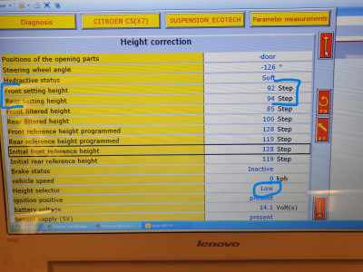

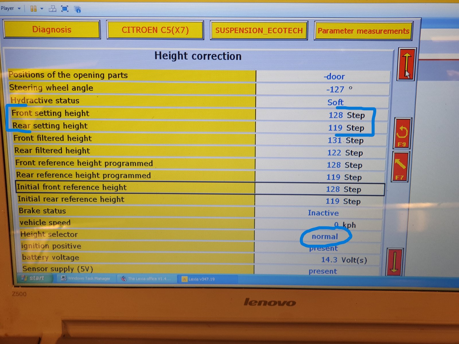

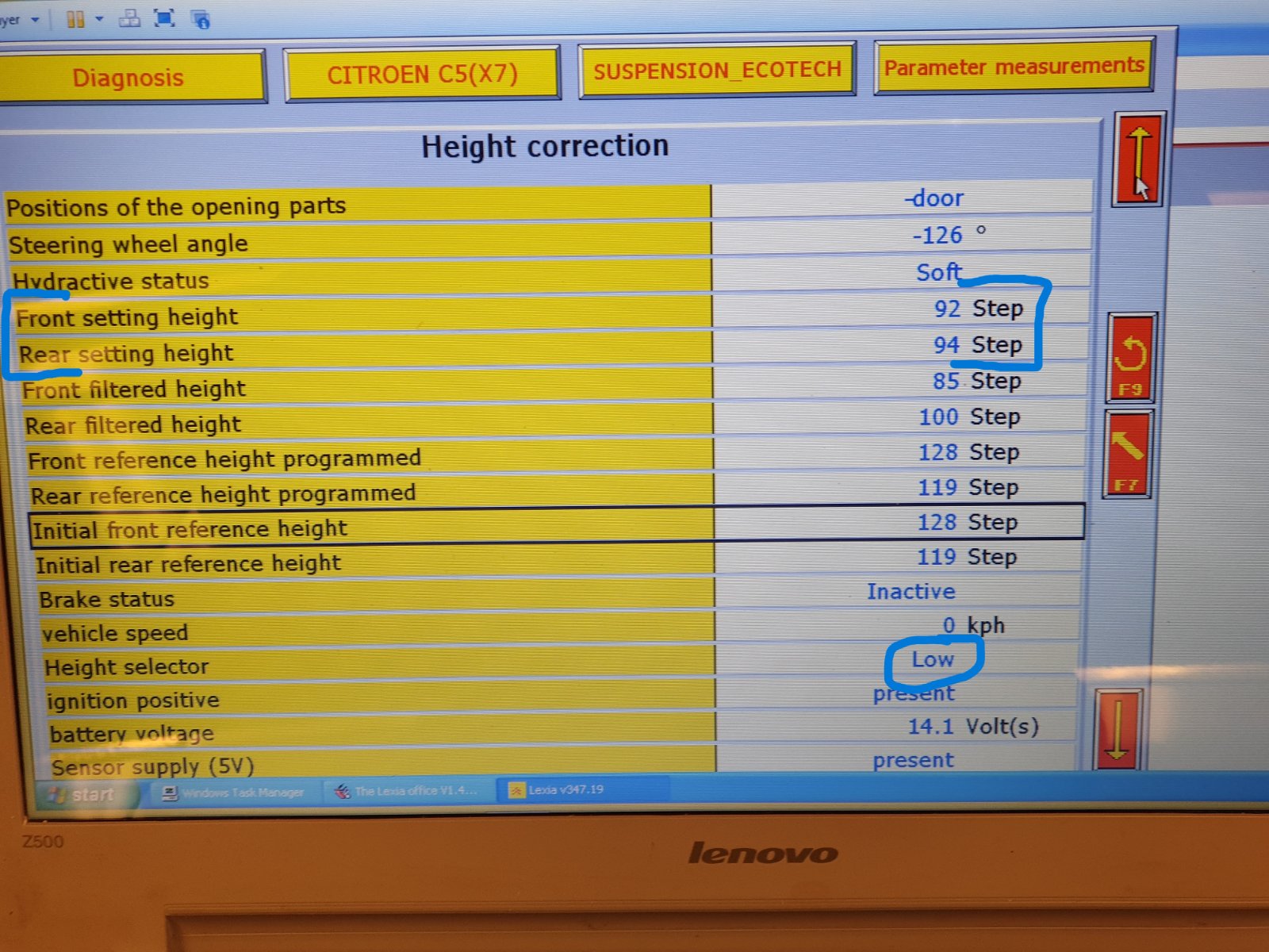

Indeed, I just looked at the other pictures I took of the data and notice that when it is set to 'LOW' height the front sensor goes to a value much lower than the 'setting' step for the low demand.
Low selection calls for the front step data to be 92 but when the front drops down to low position it goes further than that right down to 85 step. It almost seems like my front setting is out of phase I wonder if the physical rod attached to the front anti roll bar was disturbed in some way causing the sensor to be moved too far one way and not far enough in the other? This problem on my car began after I got it back from the so-called Citroen specialist who fitted the replacement steering rack. I just don't know though..
