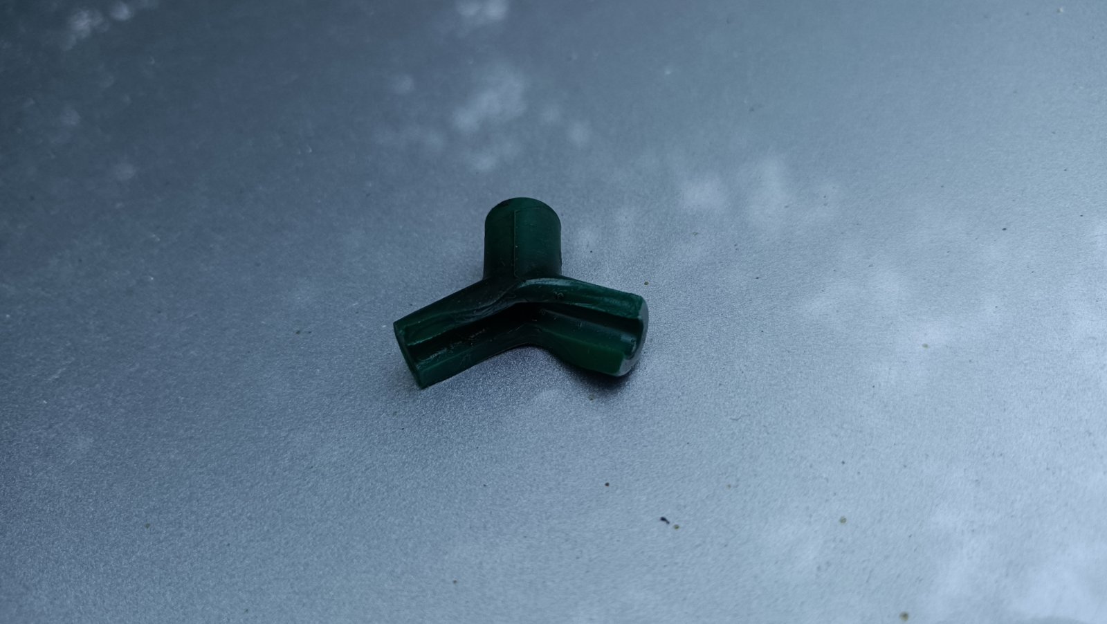

I mentioned previously that the car was losing some LHM, I put it up on stands at Jim's and crawled underneath to find an LHM return line hanging unconnected behind the front subframe.
The cause was... We had a good rummage through Jim's boxes of stuff left over from broken Xantias, but could not find a replacement, until Jim remembered an old subframe rusting away at the back of the garden. Fortunately it had a Blue connector which could be made to fit (the colour denotes the pipe diameters).
That should reduce LHM consumption a little.
