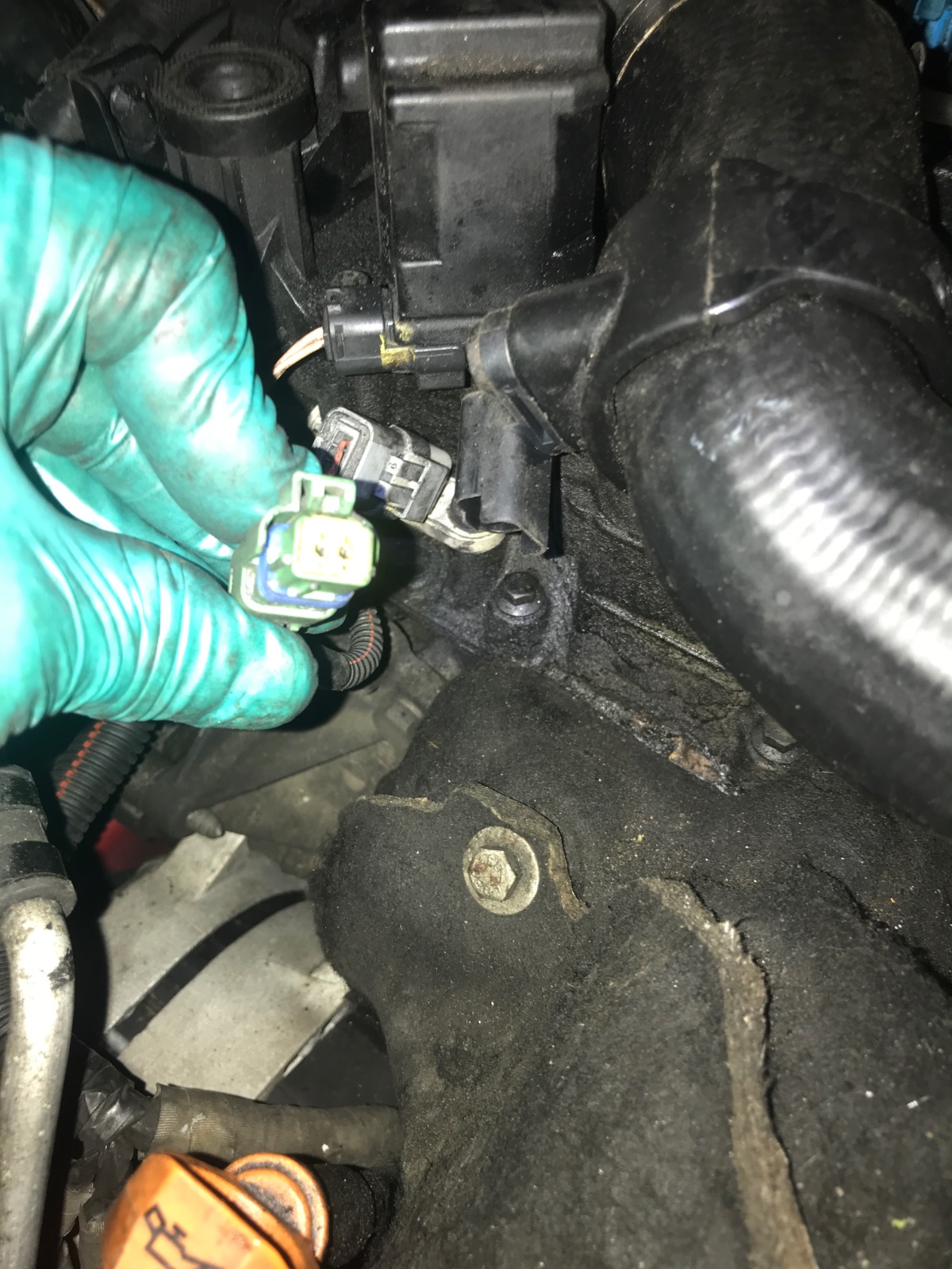

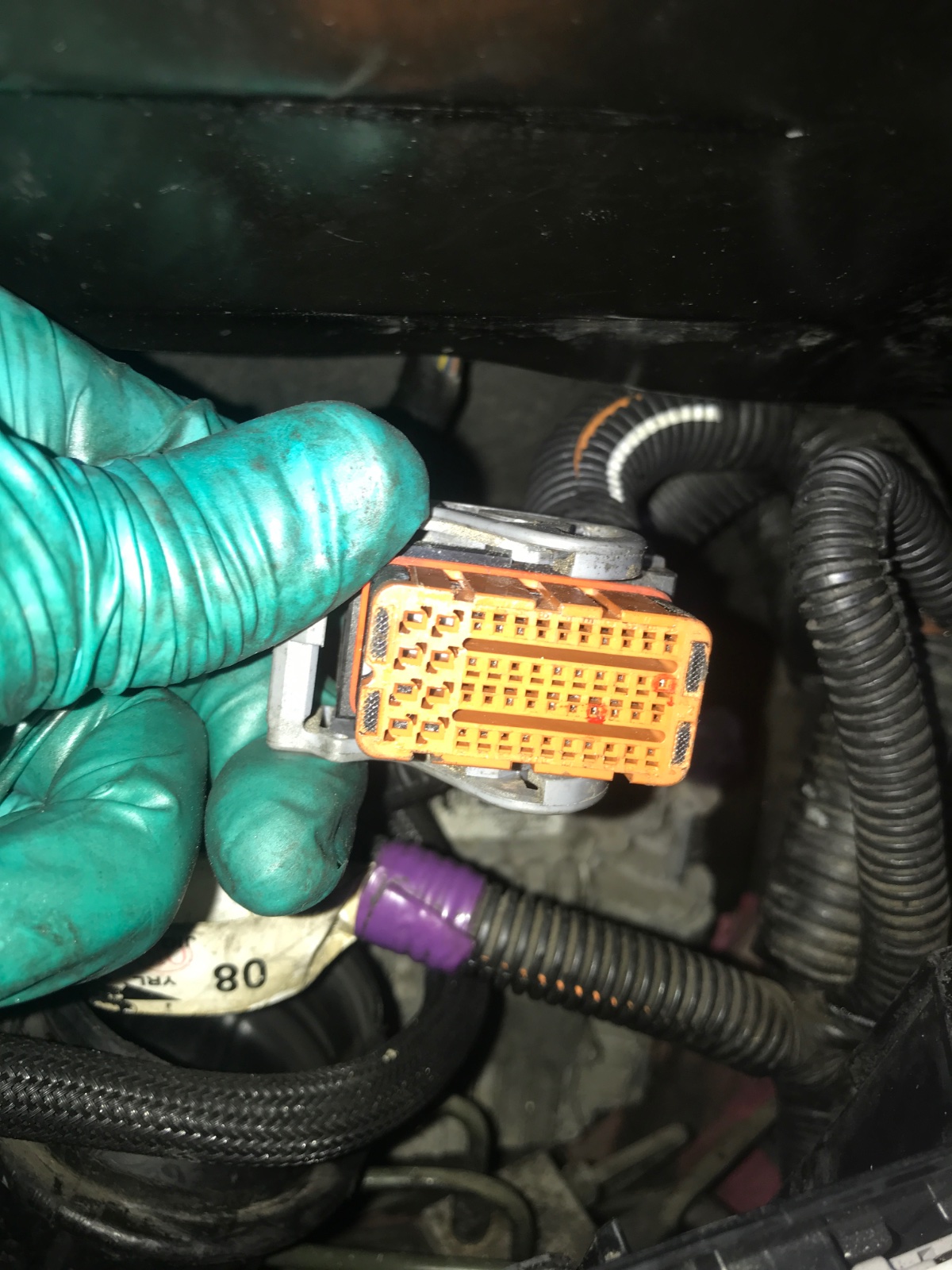

Sense check please. Regarding the post attached, I have confirmed continuity from the 2 wire Air Intake Sensor to the ECU plug which should eliminate the wiring from sensor to ECU and also the AIT sensor as I tested it previously with a hot air gun and an ohmmeter.

Photos attached. Pins marked red are the ones that prove continuity from AIT to ECU.

If you measure the resistance across pins A2 & D3 of that brown ECU connector (with the ECU disconnected but the AIT sensor plugged in) then warm up the sensor with a hairdryer does the resistance reading drop then go back up when it cools again?
