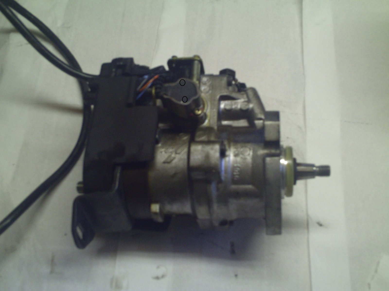

Been a while Jim but here's the info on what I mentioned the other day.
The hidden O rings inside the solenoids
https://citroen.cricou.net//epic/change ... vannes.pdf
And here is a pic, though crap and not dismantled that I found for the 'unknown leak'. It leaks from the edges of the potted resin. Underneath each circle is a T7 screw. I warmed the resin with a soldering iron until I could get the T7 bit in. Once both screws were removed I used a 6 or 8mm rod or more probably an allen key from the other side inserted into the sleeve that goes into the pump and gave it a quick smack. The innards come out along with the resin as an ensemble. This exposes further o ring(s).
I am going back a bit and haven't got any Epic bits to check anymore.
If you know of anyone with a 'spare' may be worth testing my memory on that first.

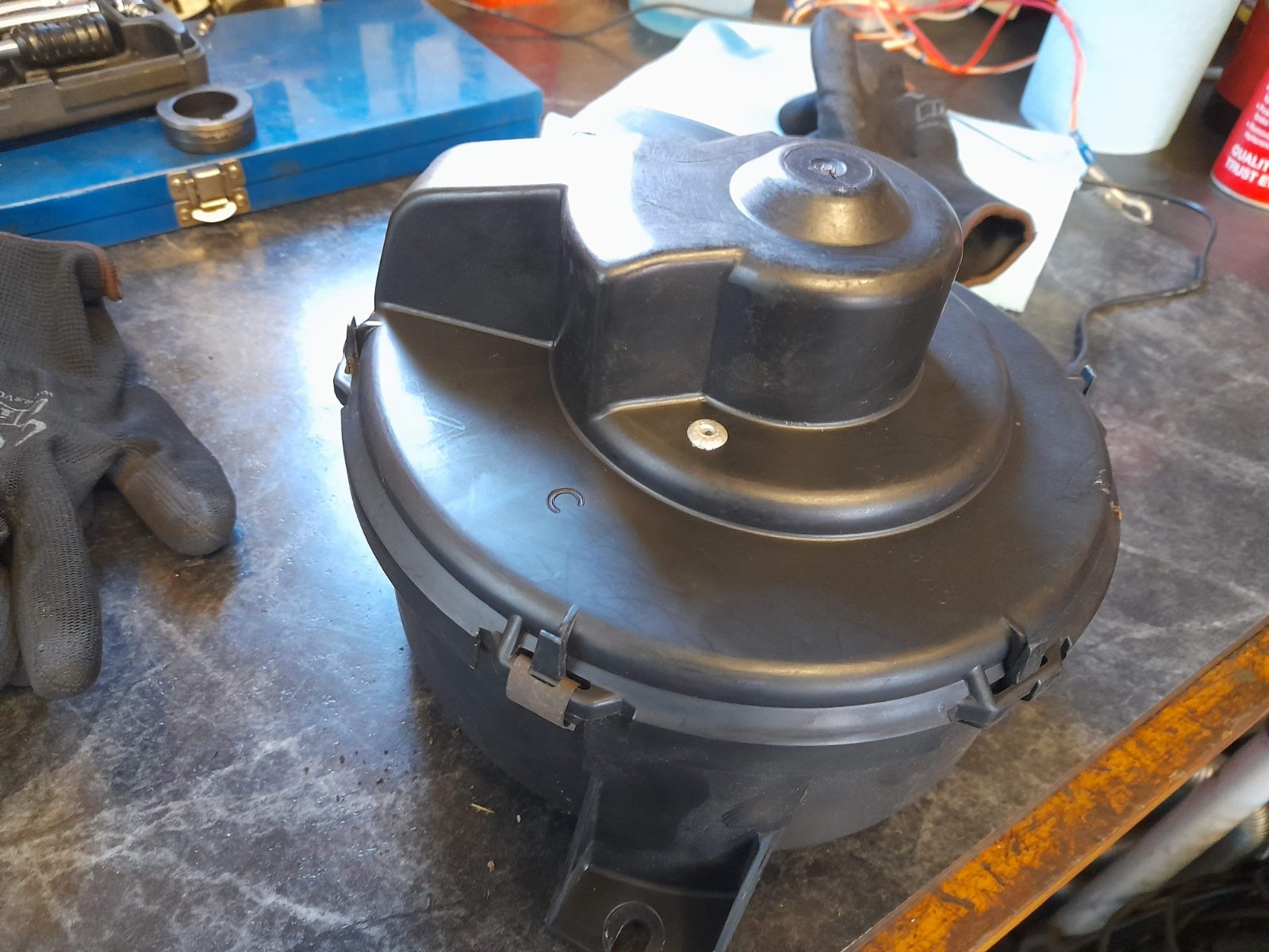

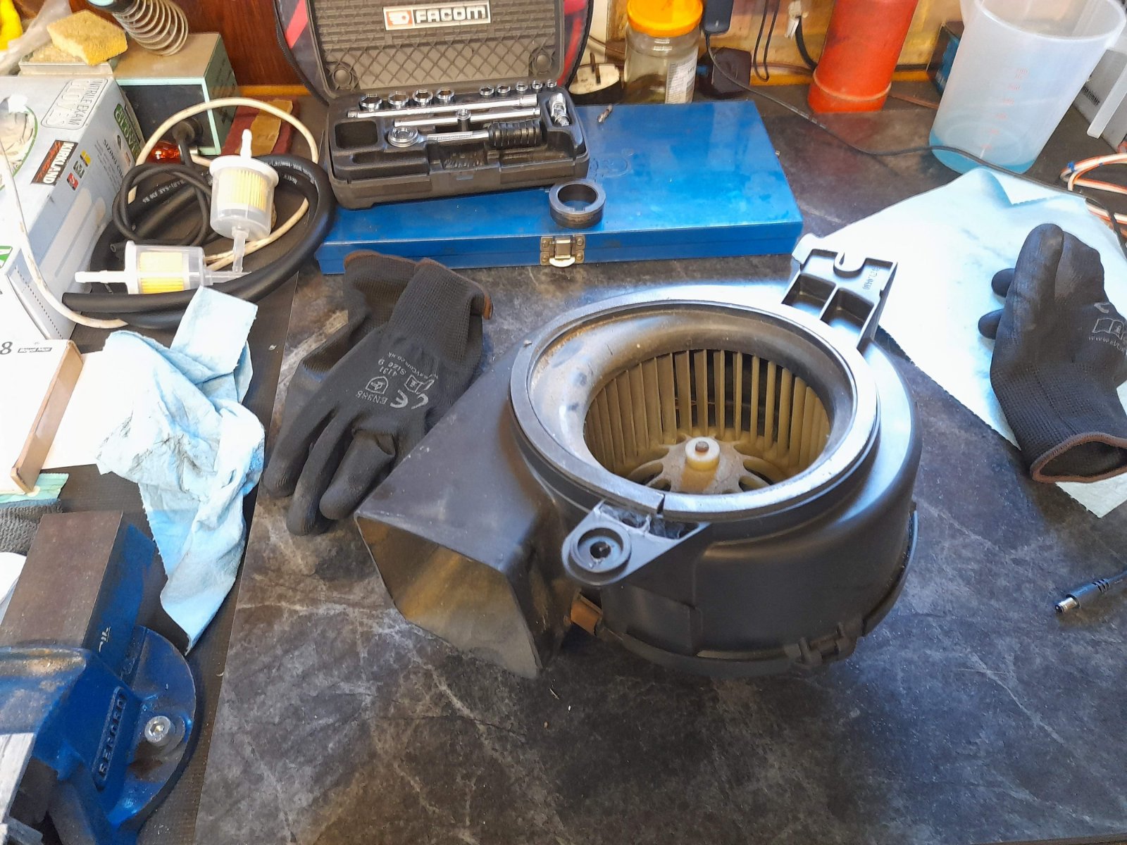

Today, it being lovely, I pulled Bluebell out of the garage to have a look at her sick heater blower... It works only on its top speed, very noisily and not happily...

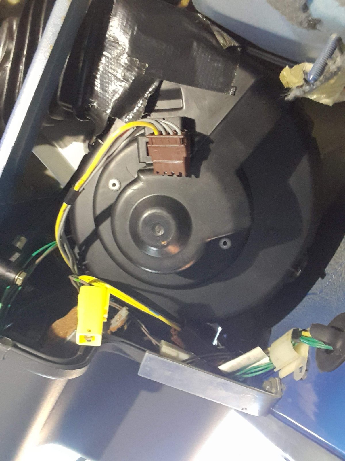

The blower lives under the dash on the driver's side... A 10mm socket on a very long extension soon has it removed...
Two of its speed control resistors are open-circuit and the motor bearings are dry and stiff...
The two halves of the case are clipped and held together by barbs... And the motor pop-rivited in. Not intended to be repaired...
In the cold of my workshop the plastic is brittle and more like bone china. I broke a bit off by gently trying to ease the slot apart to release a barb...
I've now brought the whole assembly indoors so that it can warm up and hopefully then the plastic will soften and allow disassembly... I feel a little extra heat may be needed to assist the process...
