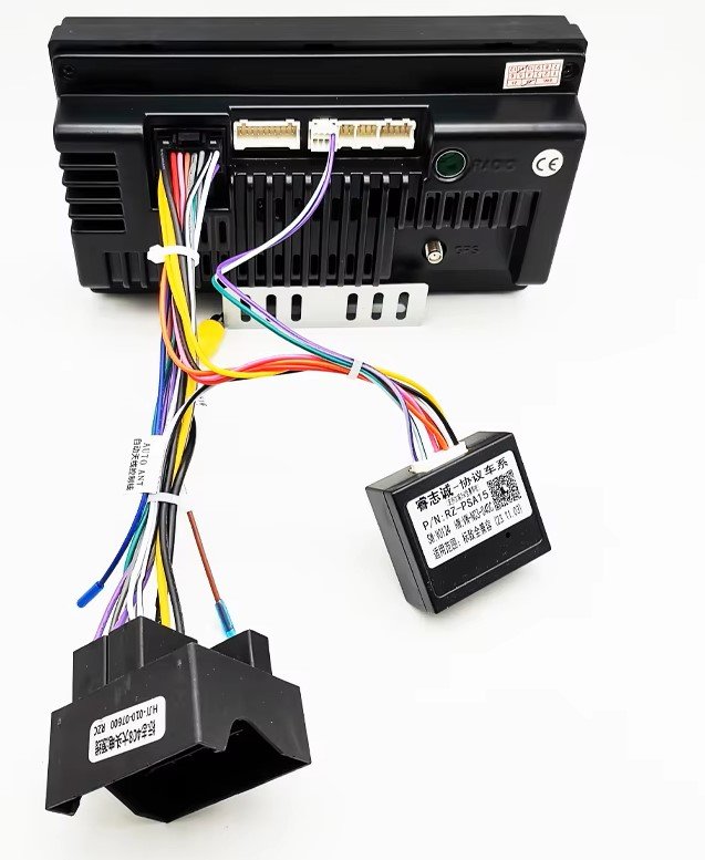

Hi guys, I asked the seller, I will copy the answer, hope you don't mind.
"Dear, put the power cord I marked, put the original car CD back, and use a multimeter to measure whether there is 12V voltage on this line when playing music, and there is no 12V voltage when no music is playing, it proves that this is the line, connect to our power supply The wire is marked ANT blue wire, thank you"
This connector is from RT4 (marked with "a") number 9. We are going to give it a try tomorrow, fingers crossed.
Mladen
Mladen
