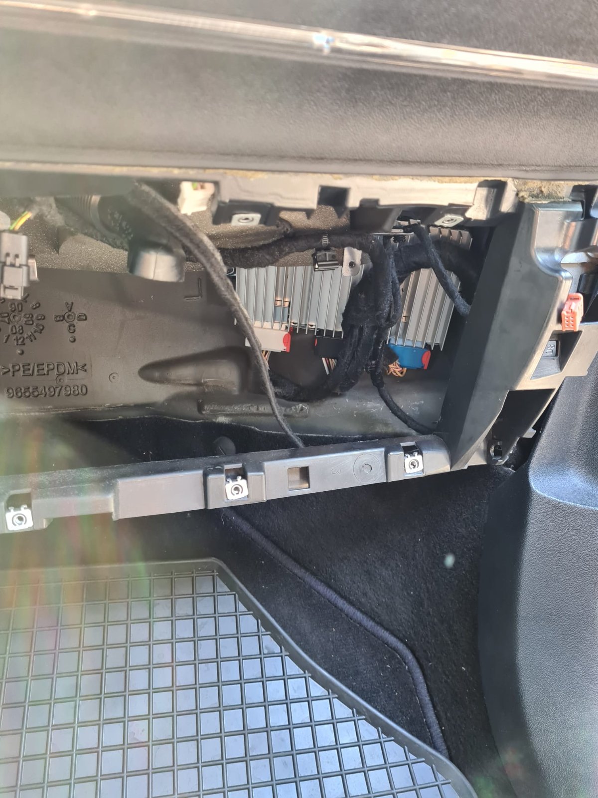

It´s nearly impossible to use that standard amplifier with aftermarket HU. Best option is just to bypass it, but you loose subwoofer, and need to add crossover for front speakers. This also requires a little bit of modification for speaker wiring.ExOduS442xb wrote: 16 Mar 2022, 20:01 Hi Marc, thanks for the advice, but I am afraid those guys wont help me much, I will try. I believe I will make it work, it will probably take some time, if I do I will add instructions on how I made it work.
Is it possible to identify via photo which amplifier is this? I hope I attached it correctly. Or maybe via VIN number?
Thanks,
Mladen
