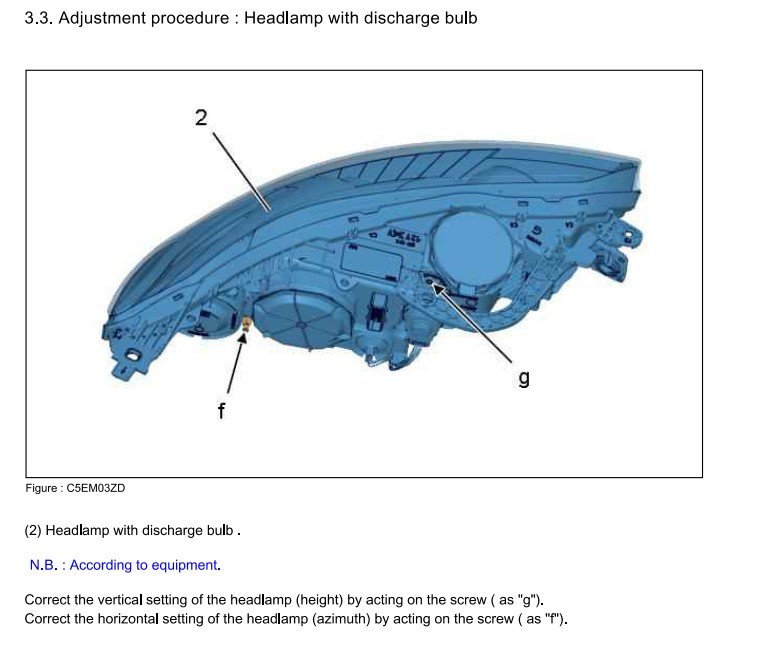

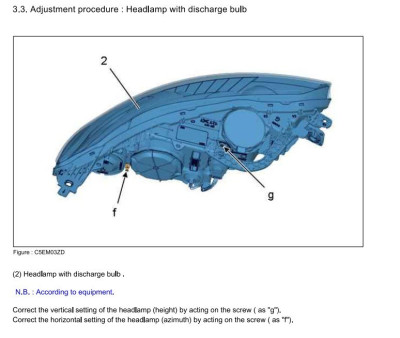

Dear Marc,
referring to your reply to Scott,
I had my left headlamp replaced. I have a feeling it lights too low. I know it levels automatically. I did some search and now I am pretty much convinced that some initial adjustment is needed.
Could you take a look at the following figure and confirm that I am correct and those are the two screws for the initial level adjustment.
Kind regards,
Przemek
Update 2025/04/22
Just small updated from my side - my left headlight was to low, as I thought. The adjustment was done at the MOT station with this 'g' screw. Now it seems to be ok.
