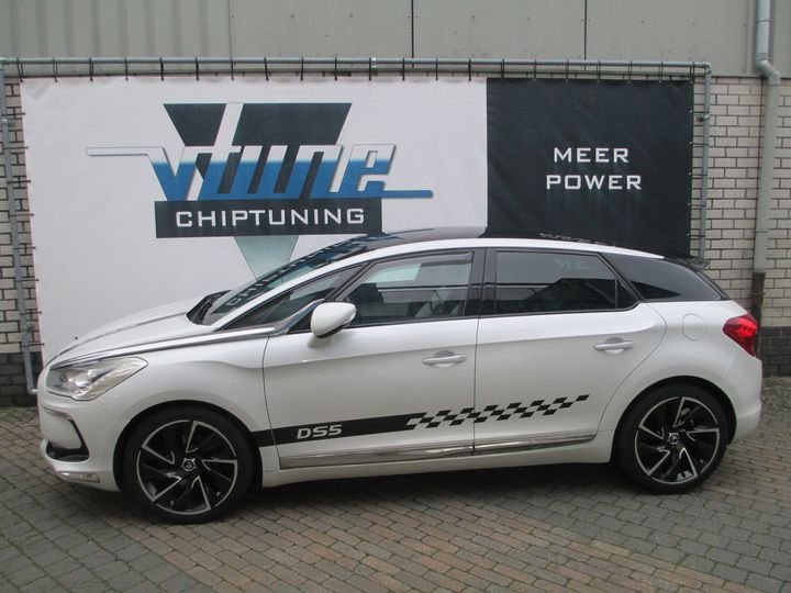

i have a DS5 from 2013 and there are normal halogenlights in it, i believe H7.
I really want to have some more light, can anyone tell me wich led lights i need to buy for the headunit, without any problems??
I saw the nighteye H7, are these the one i need??
Thanks.
Michael.
This is my lovely DS5
