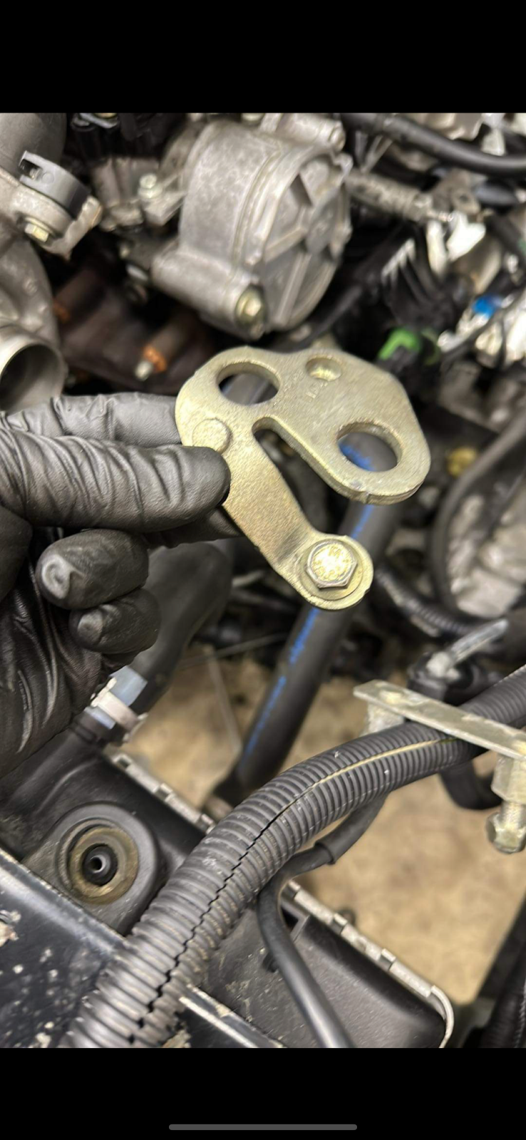

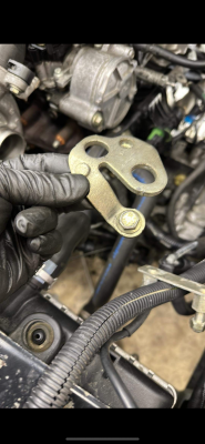

It’s been off fir two weeks as I’ve been replacing the clutch and waiting for parts. Which reminds me, can you identify where this part goes ?
