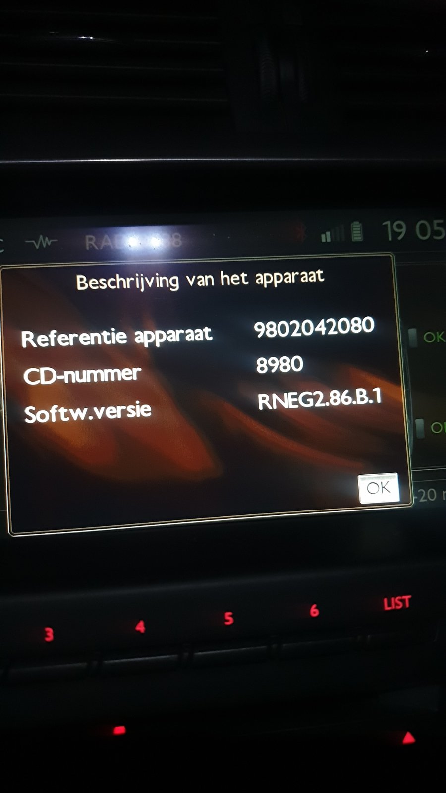

Is that the big number on the sticker on the unit???
That 98........number i see on the display, is that the unit number???
Michael
Michael
- Posts: 42019
- x 6955
Re: RT6 unit
Yes, that's the one. Make sure you get a matching part number if buying second hand to ensure compatibility.

Re: RT6 unit
Perfect Mark, thanks, so the 98.......number is the partnumber of the unit?? and thats it?
- Posts: 42019
- x 6955
Re: RT6 unit
Yes use that number to search for a replacement. It will still need VIN coding to your vehicle and possibly configuration to your vehicle's options, - that I obviously can't confirm as I won't know what vehicle any replacement has come from or what options the vehicle had, but at least the unit is correct for your vehicle.

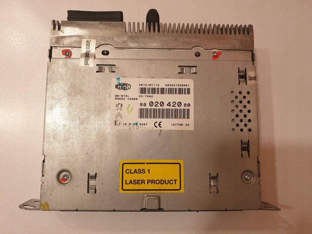

I can buy this one very cheap, it works, so i think this is the right one, do you think that also??
Michael
