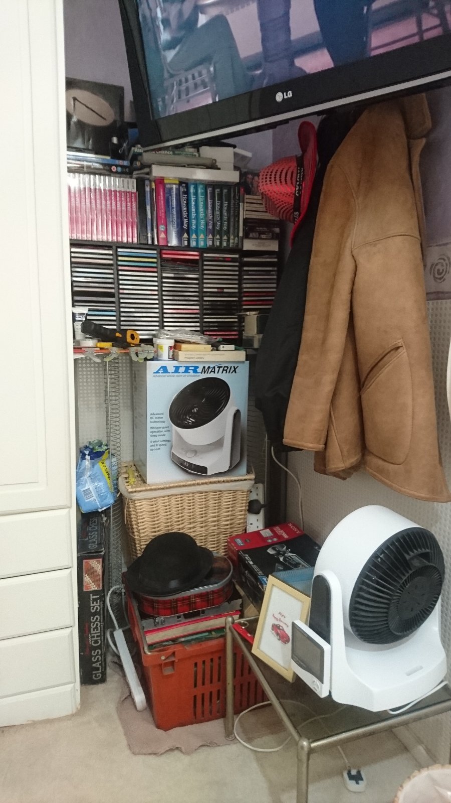

I woke up the other morning and realised my "tat" corner needed some sorting:

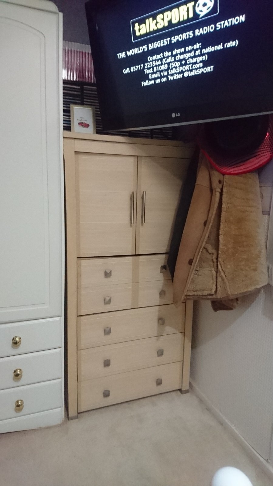

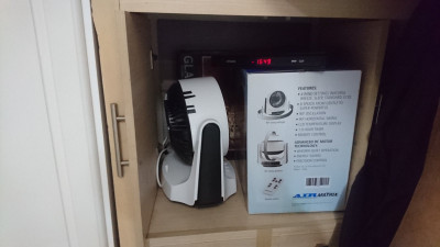

So I had a good hunt and found an almost suitable solution on ebay. It was actually 3 cm too wide at the top and 4cm too high but close enough so I bought it and collected it yesterday. I removed a 4cm strip from to top ro give me a little wriggle room and cut the legs down by 4cm too. I then installed it today and now it looks like this:

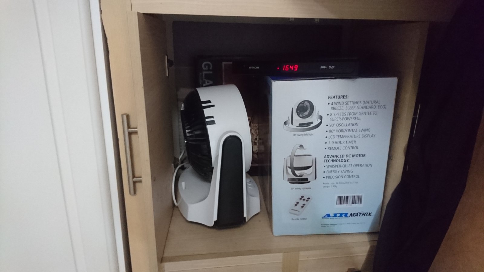

I can give myself brownie points too because the doors are designed to open and then slide back along the insides to leave the space clear for a TV, but in my case it will open to reveal my freeview recorder for when I have the need, not to mention all my fans!!

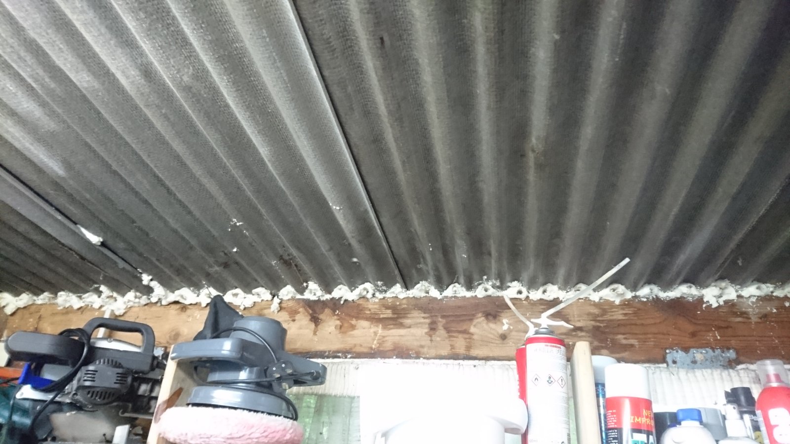

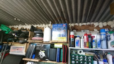

I'm sure my two, possibly three readers, will remember my work on the garage roof during the summer which culminated in sealing the sheet to rafter gaps with expanding foam as detailed at viewtopic.php?p=730837#p730837
Well it turned out that I did too good a job without paying sufficient attention to the part those gaps played in the ventilation of the garage!! Once the weather started getting cold and SWMBO was garaging her car after driving in the rain we began to notice the odd pool of water on the floor which I initially put down to her car dripping dry. However yesterday I had need of my oil sucking kit which was in its cardboard box on the top shelf at the back of the garage. I went up my two step to discover the bottom of the box was sodden!!
A bit of head scratching followed as I was totally convinced I had sealed all the leaks! I had, too well!!! I realised that the underside of the roof was wet at the back, lower, end and then it dawned on me that we had an evaporation-condensation cycle going on with the rainwater from the car evaporating during the warmth of the day and then condensing on the underside of the roof once the cold night set in. Because the roof slopes down towards the back that moisture was following its natural path until meeting my foam barrier at which point it was collecting in sufficient volume to drip down onto the shelves!!
So this morning I have been out and driller ventilation holes through each of the foam fillers in the hope that with a flow of air restored the water will get extracted as it presunably used to!:
I may have to add some further ventilation at the front to give us a flow through but for the time being we will leave the roller shutter an inch off the ground until the intial dampness has dried out!!

Well spotted! Ventilation is very important! The driest garages all have good ventilation.

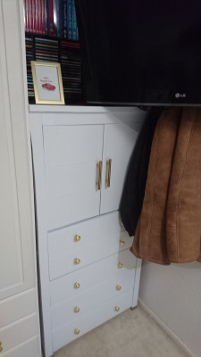

Having done my best for the garage this morning I decided to tackle the other issue which has been niggling since I rearranged my "tat" corner. You may remember I ended up with it looking like this:

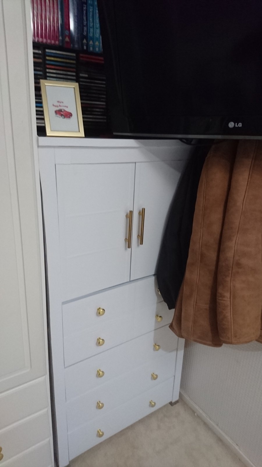

However since then while ostensibly praising my efforts SWMBO has mumbled about it being better "if it had been white with gold knobs to match the rest of my room!!" Needless to say in line with the thread title I was happy with the function without finesse condition I had reached.
This morning then after doing the garage I set about seeking some more brownie points while she is out volunteering at the dementia club. Suffice to say as far as I am concerned it is now definitely finished but I'm going to wait for her to spot it without telling her!!:
