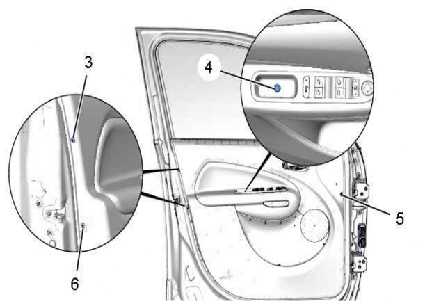

The other thing is that the constant opening and closing / banging of the doors can cause one of the electrical connectors in the driver's door control panel to work loose. It happened to me.
On the C3 Picasso, you'll need to remove the black triangular trim from the window corner with trim tools, then remove the door release trim surround with the same.
Next there are 3 bolts - 1 in the oddments recess in the actual window door control pad and another 3 shown below:
Once that is done you need to unclip the door card carefully from the trim clips. Carefully support it as you gently pull it away and you will get access to the underside of the electric window / door control pad. Check to make sure they are all correctly connected. Test the window to see if this fixes it. If not, you'll need to check the wiring as it enters the door from the A pillar to see if any of the wires have broken from the constant opening and closing of the doors.
You may want to try the wiring in the door aperture first if it's easier.
