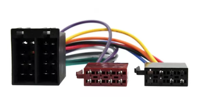

On the cable going in the back of your radio, you need to find the "ignition" 12V wire (use a multimeter to figure out which this is), cut it and solder in the feed from the lighter.
You probably don't want to cut the factory-installed wire, so buy a sacrificial ISO -> ISO adapter cable and cut that instead:
