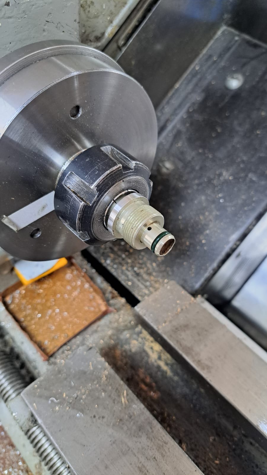

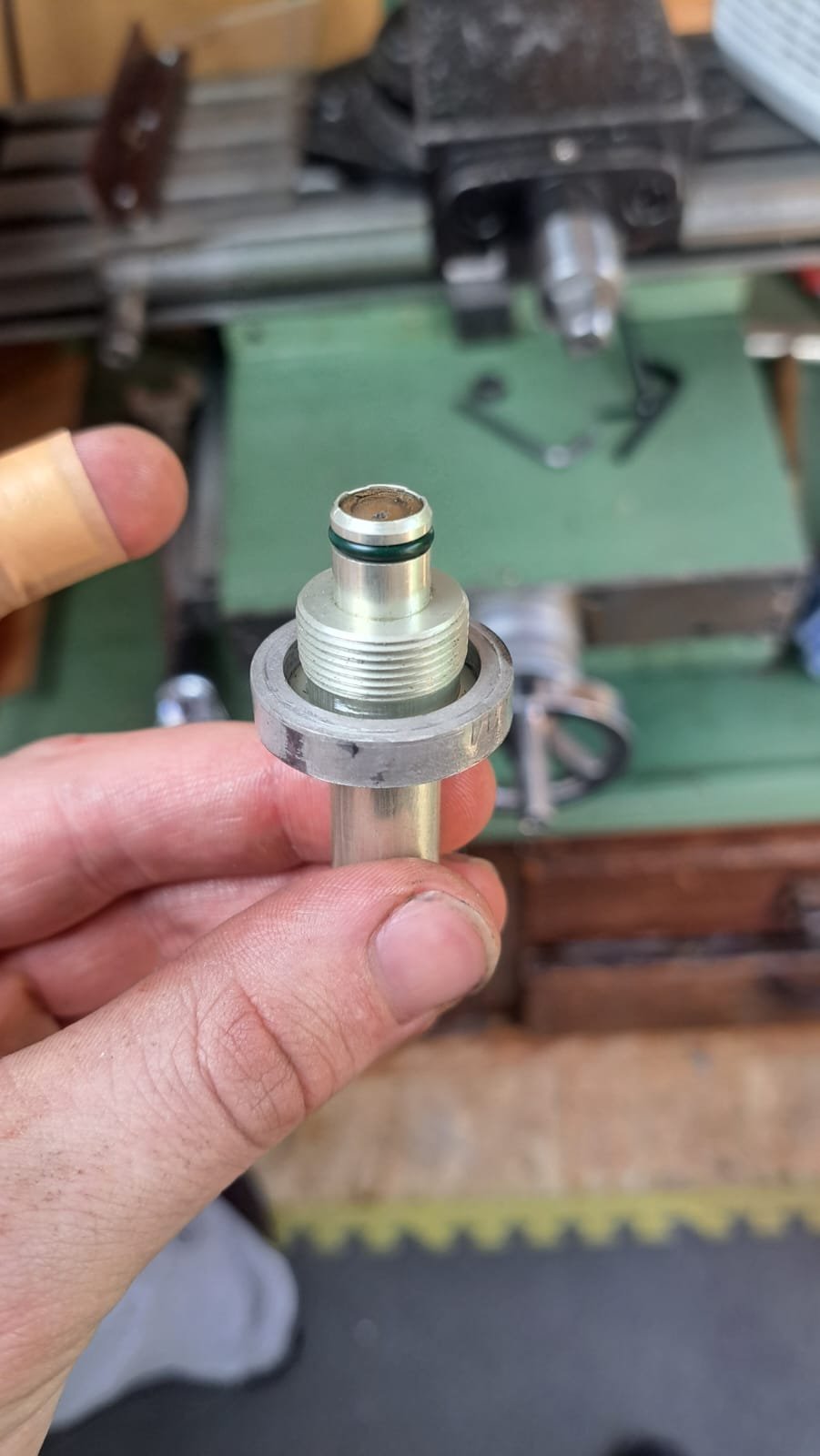

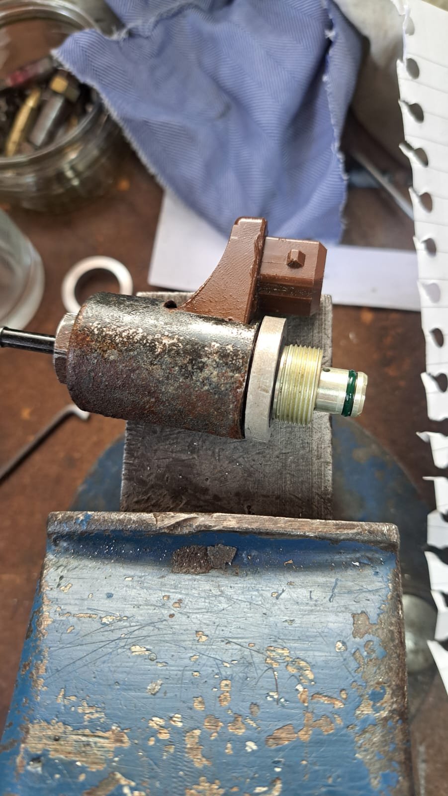

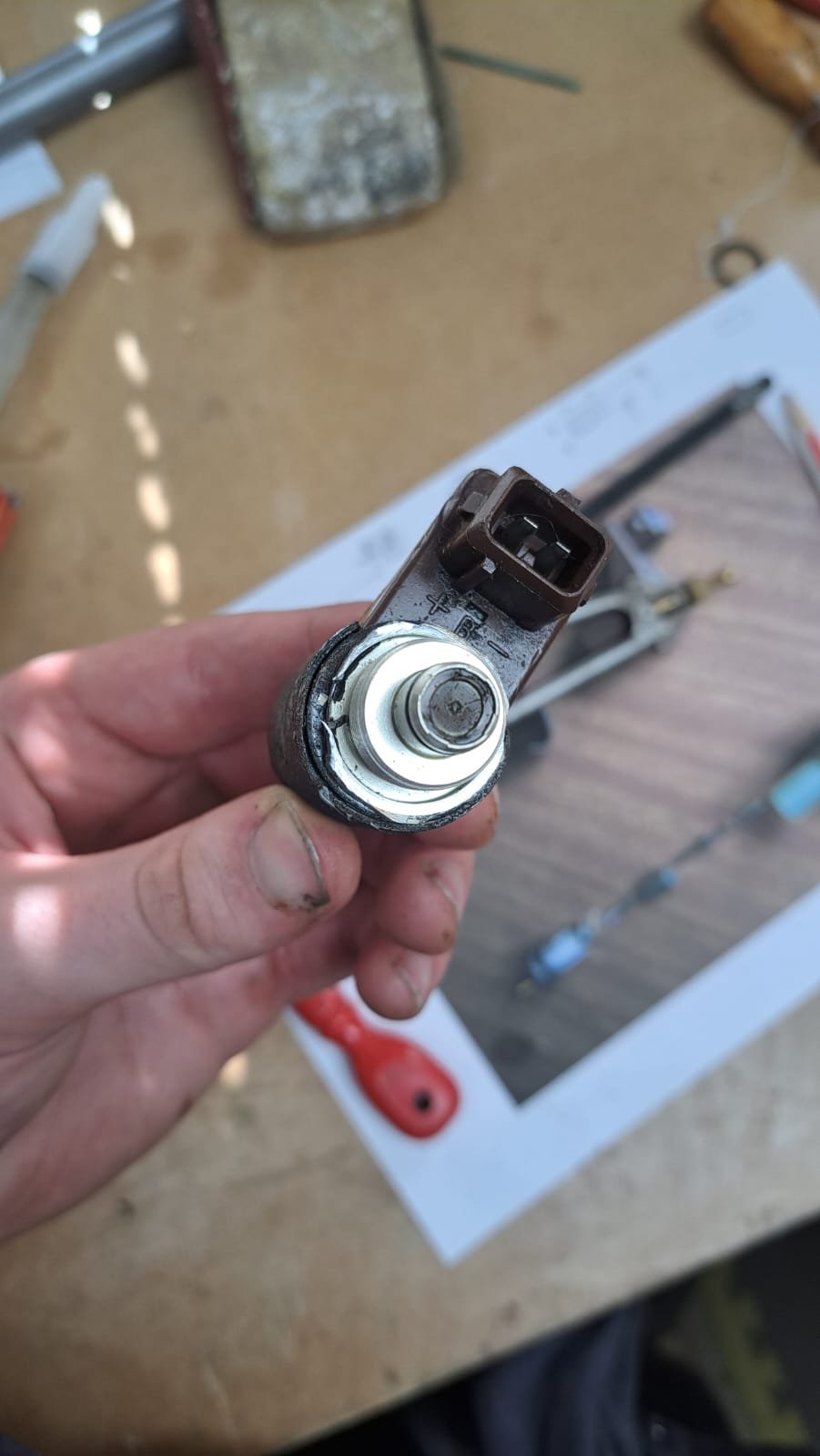

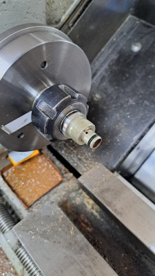

Hello!
I know this topic hasn't been discussed in a while but I've had a go at the fix myself by interference fit (heat shrinking) and thought I should share what I've found.
The previous owner had stopped the leak by putting some JB weld around the area and after I went prodding around, I dislodged it and LHM spewed out everywhere. The original condition of the valve was pretty bad so I'm not surprised it leaked.
As precision is very important with interference fits, I did all the machining I could with a collet chuck
For the fit to work, the new collar I machined was 0.04mm bigger internal diameter than the external diameter of the machined valve
I struggled to get the tolerances right even with a digital readout on my lathe so it took me four attempts but I got there eventually. I put the valve back in the collet chuck and faced it off to guarantee a flat surface (the heat from the interference fit can distort the aluminium and it doesn't always go on flush)
I ended up using an ID 14x2.5mm nitrile o-ring and after installing now doesn't leak!
