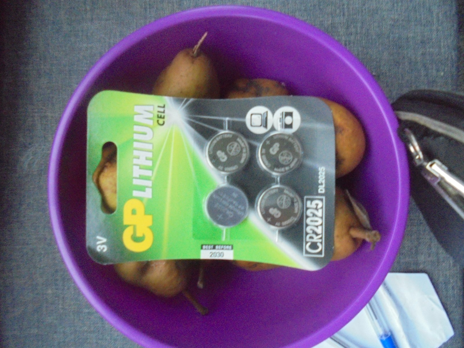

Did some maintenance on the Leaf on Monday fixed this
Finally got round to buying a four-pack of CR2025 batteries from tool station for the price as indicated, and changed one in the fob which the car was reporting as marginally down on charge.
NewcastleFalcon wrote: 24 Jul 2022, 23:20 Intelligent key for the Leaf is showing Low Battery.
The Manual says use CR2025 or Equivalent. Seeing the shelves festooned with CR2032 coin batteries and a bit of a dearth of CR2025 Batterie I wsas thinking maybe the CR2032 is equivalent. Almost but not quite,
CR2032 is 3.2mm thick, CR 2025 is 2.5mm thick, and the 20 bit is the diameter in mm, The letter “C” is the letter code assigned by the International Electrochemical Commission (IEC) This is to designate the battery’s chemical composition, which, in this case, is lithium. The “R” is for the battery’s shape, which is “round.”
The CR2032 has a battery capacity of roughly 235mAh. Meanwhile, the CR2025 can carry a charge amounting to 170mAh. The CR2032 should last longer. Both batteries put out around 3 volts. Technically, you can use them interchangeably if not for the thickness difference.
Guess I will go for the CR2025 as stated in black and white, but what's 0.7mm, maybe enough to make the intelligent Key case not click closed right.
I would never have thought of trying ScrewFix/Tool Station so thanks Bobins.bobins wrote: 25 Jul 2022, 06:49 Screwyfixy have 2x CR2025 £2.56, Toolstation 1x CR2025 £1.49, 4x CR2025 £3.79

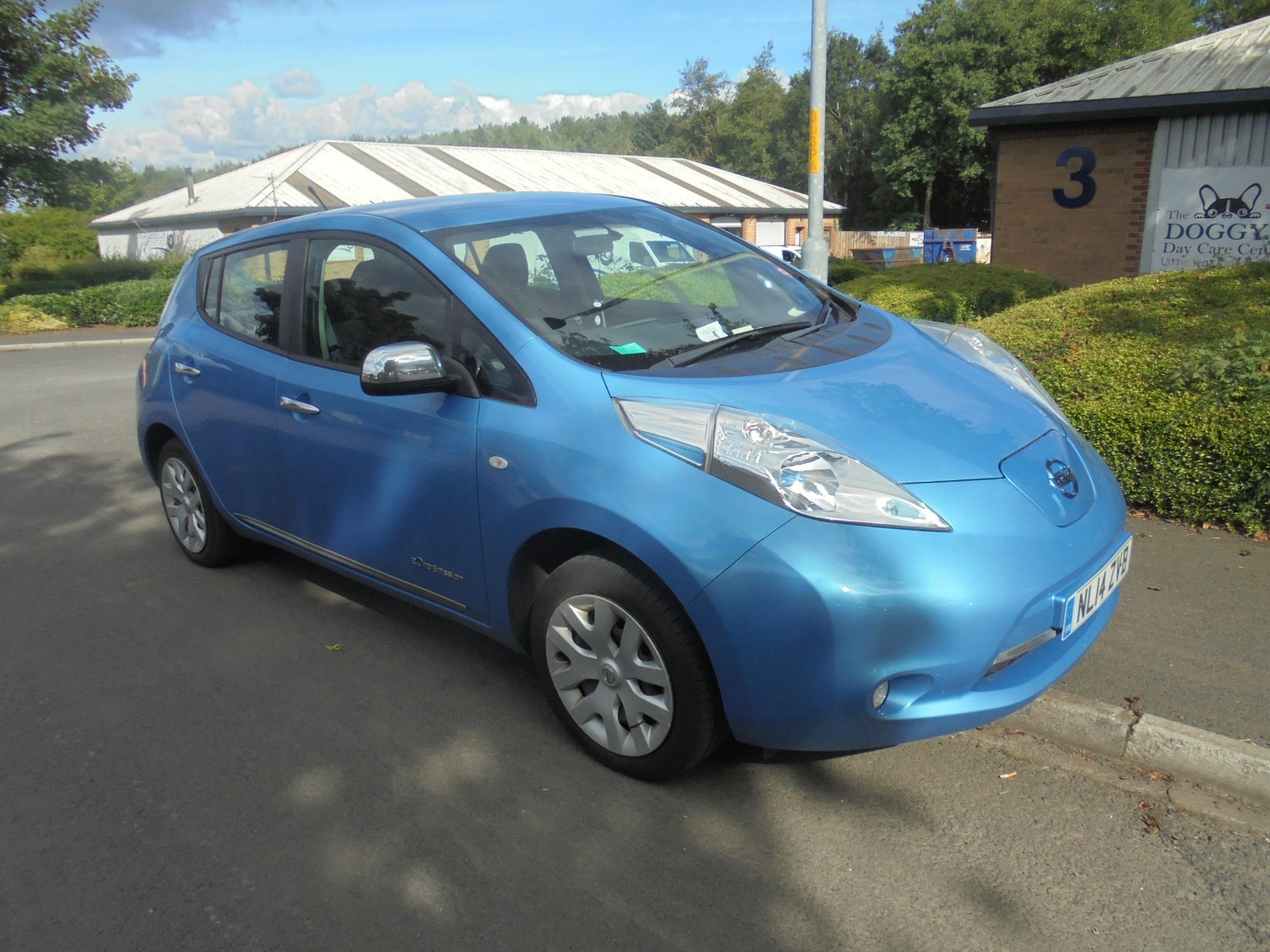

I have grown both to like the Alizarin Crimson, and the classic lines of our classic leaf but, I always like to spot one in this shade of blue.
In all its gorgeousness, the blue classic leaf is a sight to behold, shiny ears as well, and still the best bet for bargain basement electric motoring.

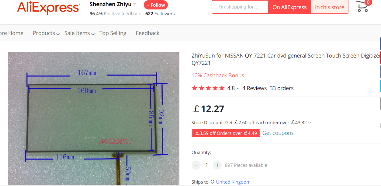

- Posts: 26425
Re: Bargain Basement Electric
Part of the link I posted for my own selfish needs on the "touch screen" righthand side malfunction includes a link to a generic part which some posters have sourced, which with a moderate degree of carefulness and skill solves the irritation and inconvenience.
Note it is just the touch screen, none of the gubbins in the box behind it, or the entire head unit or whatever its called. So a new touch screen from China, delivered to the UK....how much....
Less than £20.
Less than £20.
Regards NeilSuccessfully fitted here by Piper64 https://www.speakev.com/threads/touch-s ... st-3268227I've just replaced the touchscreen on my 2015 Leaf Acenta and wanted to add my thanks to Art for sharing his info, and to encourage others to take the plunge!
The suggested screen arrived from AliExpress within two weeks - about £12 exc coming to £17 with tax. When I finally plucked up courage to get on with the job it turned out to be fairly straightforward. I didn't need to remove the ribbon cable covering plate from the main unit; I didn't need to do any soldering or make alterations to the four pin cable and I didn't need to do any calibration of the screen. The only cables I needed to disconnect were the wide ribbon one from the back of the screen unit and the small one connecting the touchscreen itself to the pcb.
Screwdriver sizes PH00 for the smaller screws and PH1 for the others - boy were those on the ribbon cover tight! I noticed that of the 5 screws holding the black plastic bezel, the central one was slightly different with a shoulder which didn't fit properly in other holes - don't know why they did that.
I'd love to know why the right side of all these screens are failing - any comment from Nissan?
Good luck!
