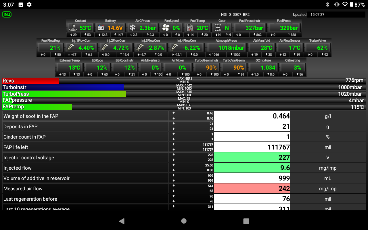

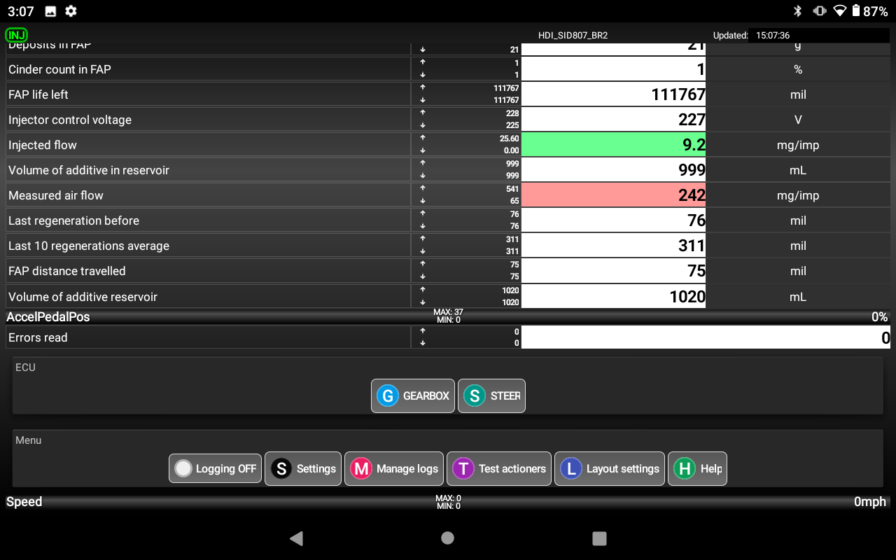

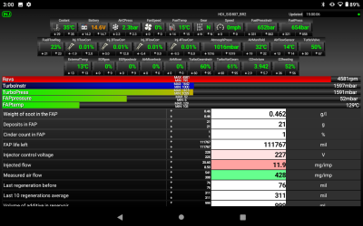

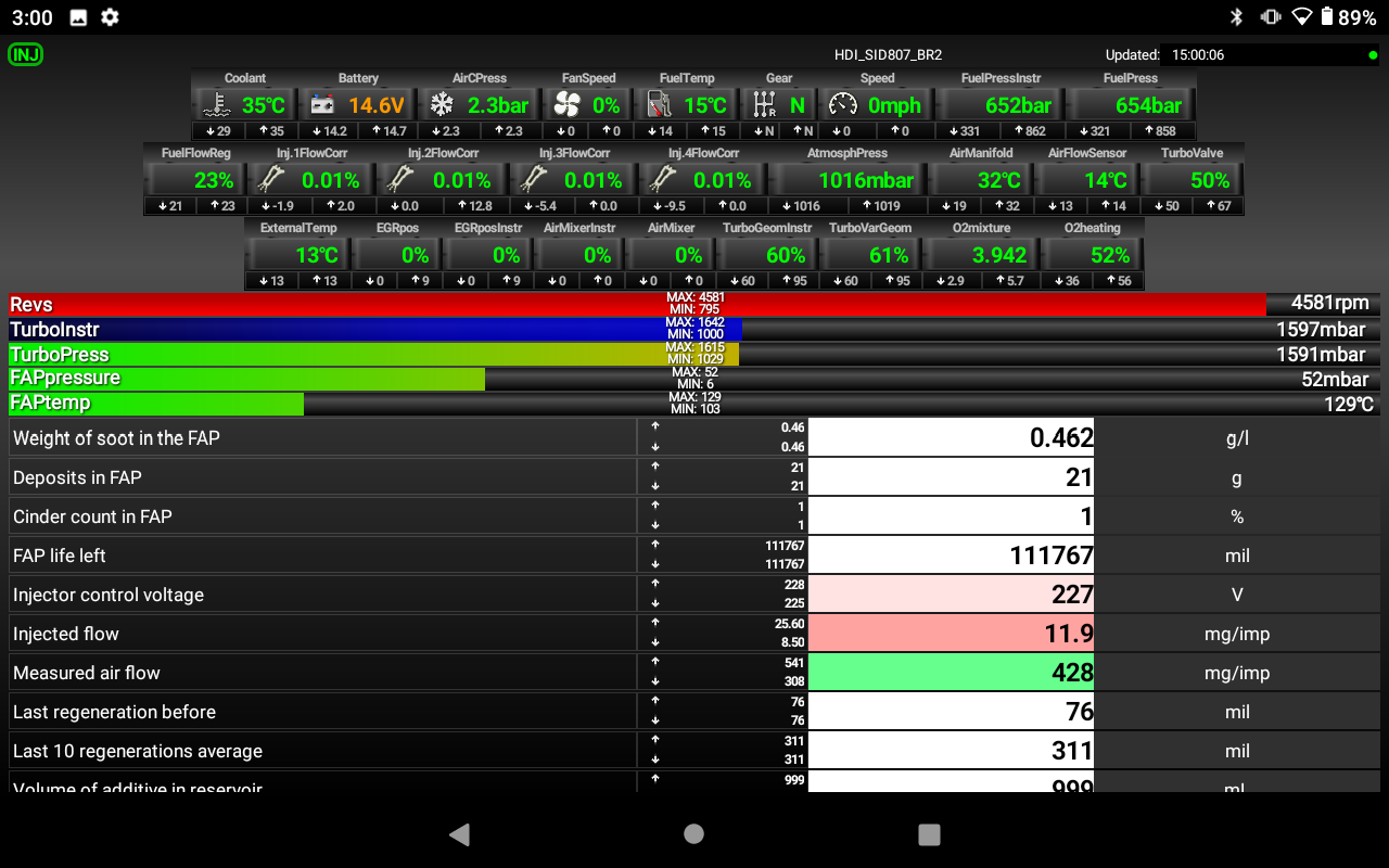

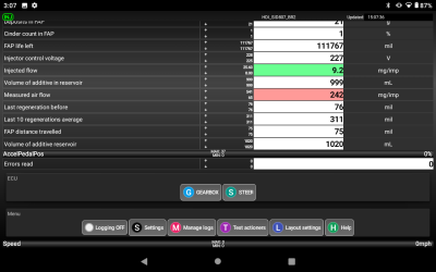

There are no faults showing. I have used the Citroen/Peugeot FAP app to see if it shows up any problem. I don’t really know how to interpret the figures, but nothing looks too unusual to me. I’ve attached screenshots to this post (I think the red/green highlights just indicate rising/falling values?). The ‘deposits in FAP’ is reading 21g. I’m interested to know how this figure is measured, I assume there’s no sensor weighing the DFP, is there just a lookup based on pressure/flow? Also are the DPF reading’s given by the ECU reliable? Could there be an issue with the DPF and the readings still be low like this?
