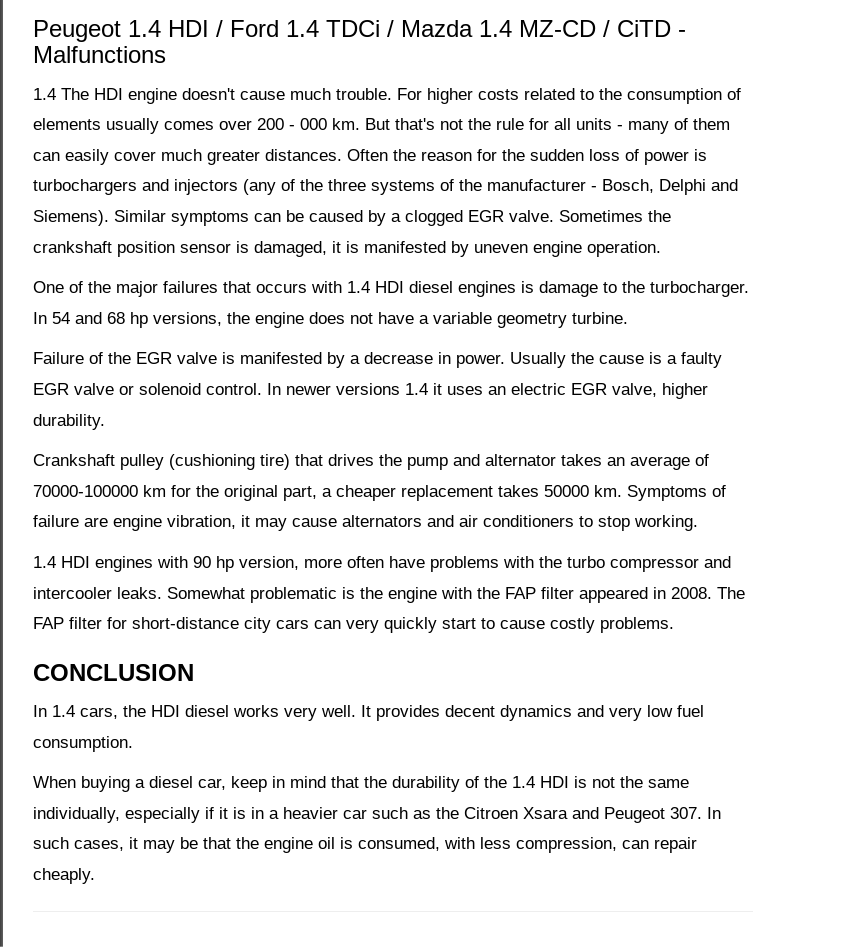

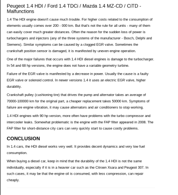

Has anyone suggested an EGR fault? That is where i would start.
Also, have you read this article. It means that Ford specialists will be equally able to help as the 1.4 was a joint collaboration between PSA and Ford. Not that I am suggesting that the members of this forum are not more than capable, it is just that the quicker you get clues the better.
Do you have any fault codes to share?
