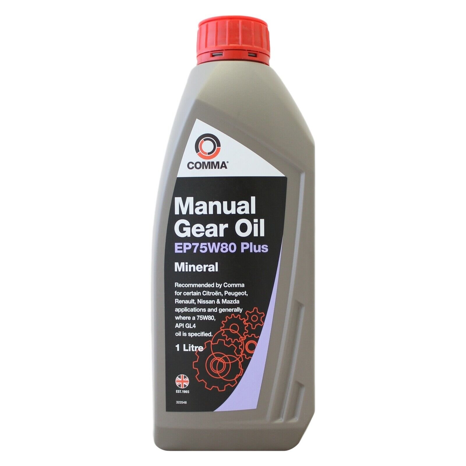

That's a good find.. No, there should not be a lot of 'play' and excess play will certainly affect gear engagement - see my earlier post in this thread...Theflyingpostman wrote: 08 Nov 2022, 09:49 I have found the link from the gear knob to the lever rubber ball joint have excess of playing, is this normal? https://www.ebay.co.uk/itm/184339850867
Wrong oil. Despite saying it's a GL4 specification it's fully synthetic and therefore an older gearbox may not be happy with it. Also note the list of recommendations does not include Peugeot/Citroen...Theflyingpostman wrote: 08 Nov 2022, 09:51https://www.amazon.co.uk/Comma-MVP75801 ... 27&sr=1-24xantia_v6 wrote: 07 Nov 2022, 12:21 Are you sure that the oil you put in is GL4 specification, NOT GL5?
The mineral version of the Comma 75W/80 oil does...

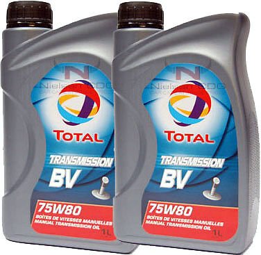

This is the one to use...
It's my experience that 90s PSA gearboxes are very fussy of their oils...
A similar state exists with certain autoboxes that are designed to use mineral Dexron II ATF... Although later versions of synthetic Dexron are said to be backwardly compatible, they are not and I'd be inclined to think the same applies here...
If in doubt, use the genuine stuff... The Total BV oil is OEM...
