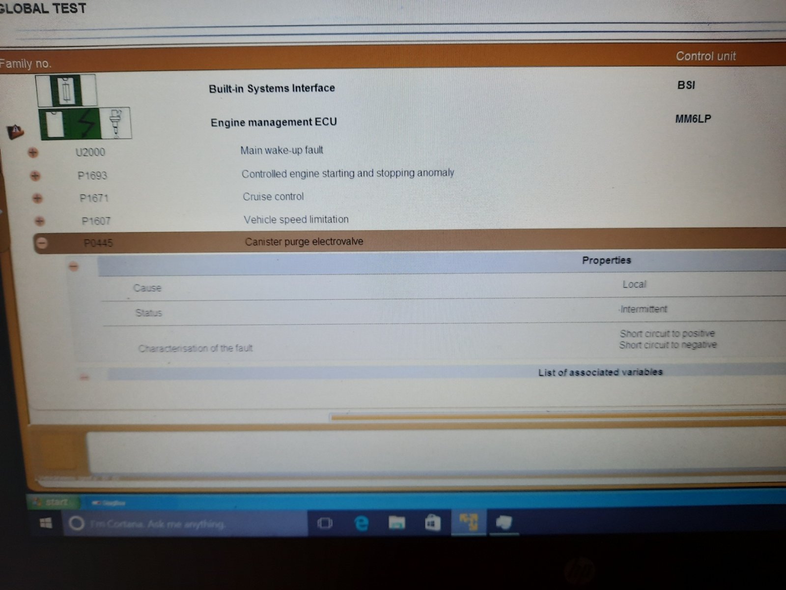

Hello guys, I have a problem with my c4 2.0vts. It has been 2 years now that I wasn't using it. So a week ago I bought a brand new battery to take it for a ride. First problem that I found out was that the fuel pump was dead checked fuses and everything, even connected it directly from the battery but still dead, so I bought a new one and it was working. Now the problem is that the car still not working for some reason. I connected it with diagbox and I got the following errors.

Hi
Have you tried the BSI reset procedure
It shows a wake up fault so worth a shot as it costs nothing but 30 minutes of your time.

c4akias
Posts: 12
Joined: 30 Oct 2022, 10:06
Re: Engine cranks but doesn't start
Unread post by c4akias »
Thank you Colin
just tried it but still the same, is there anything else I could try?
