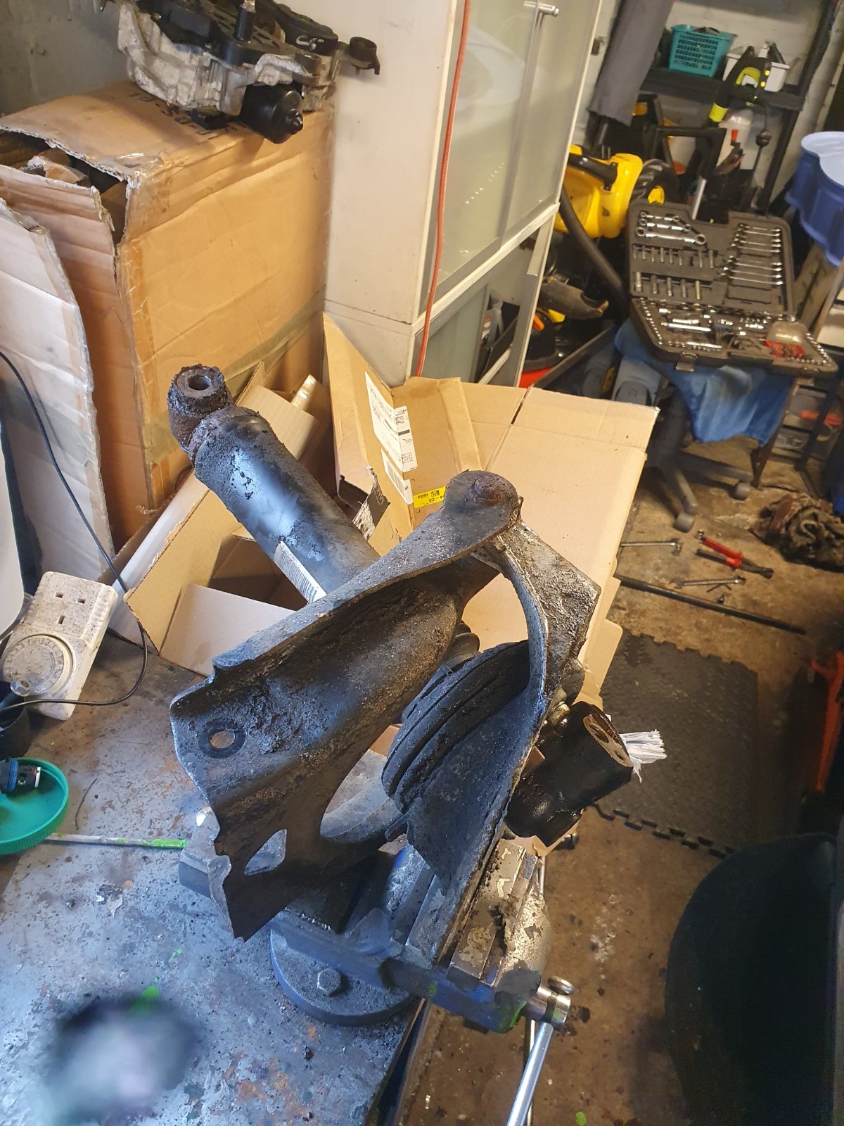

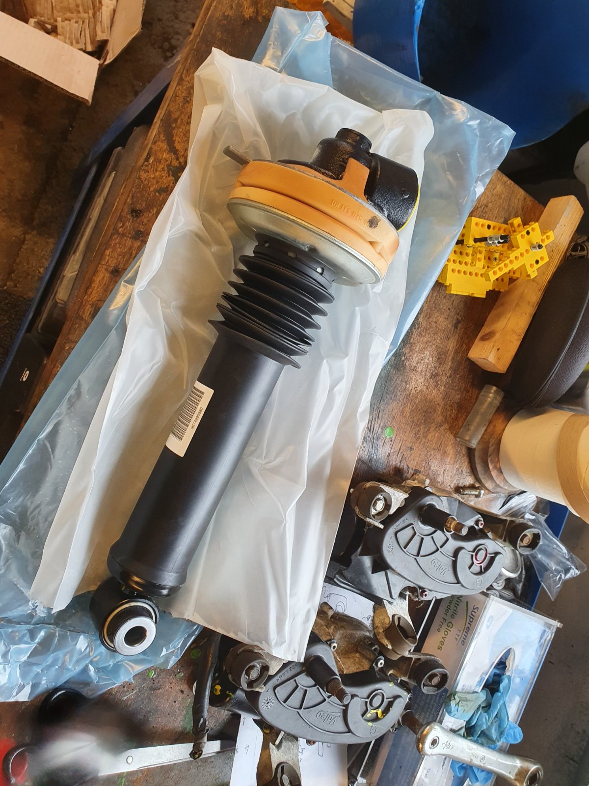

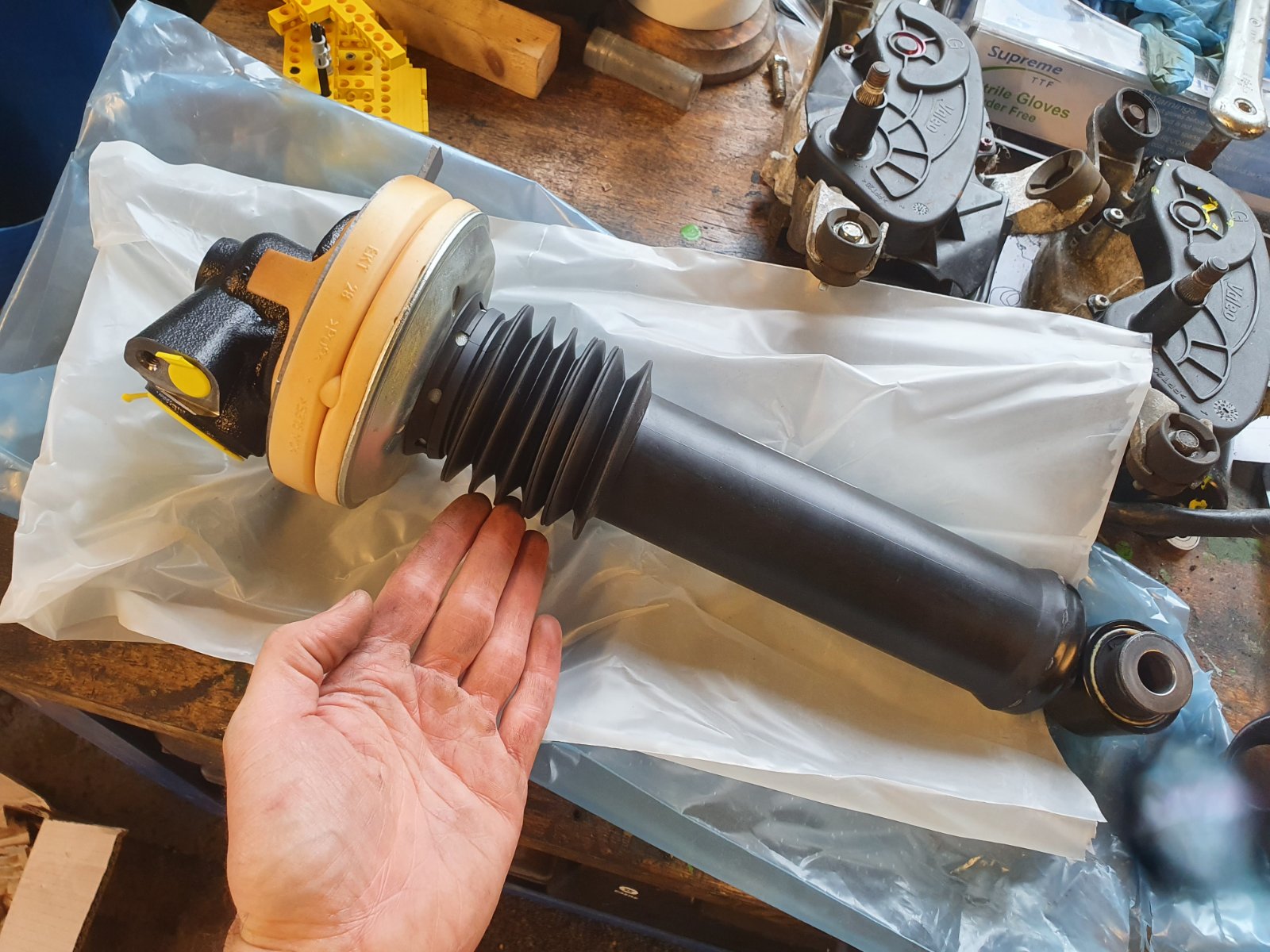

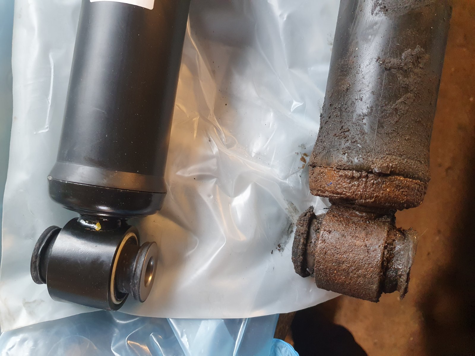

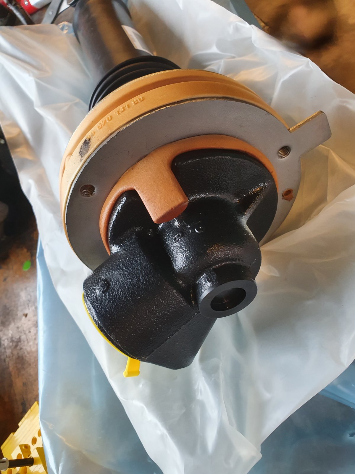

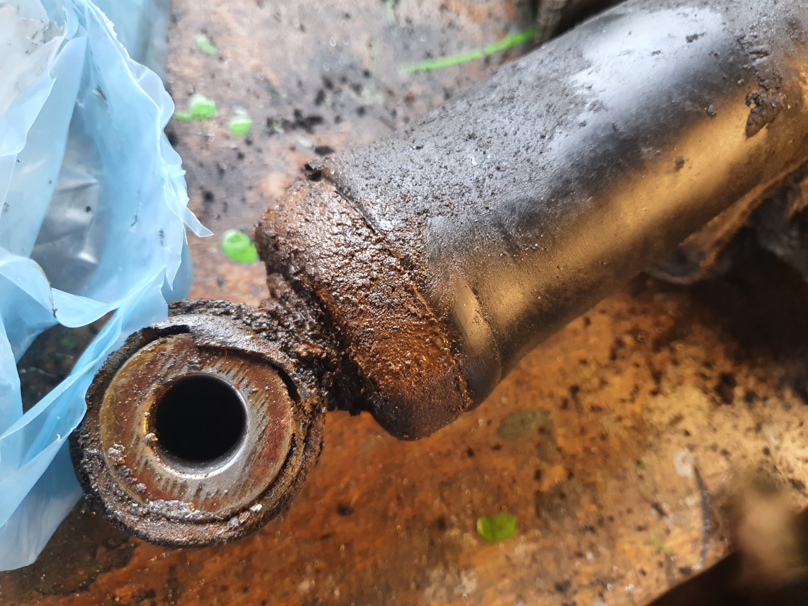

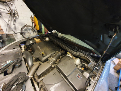

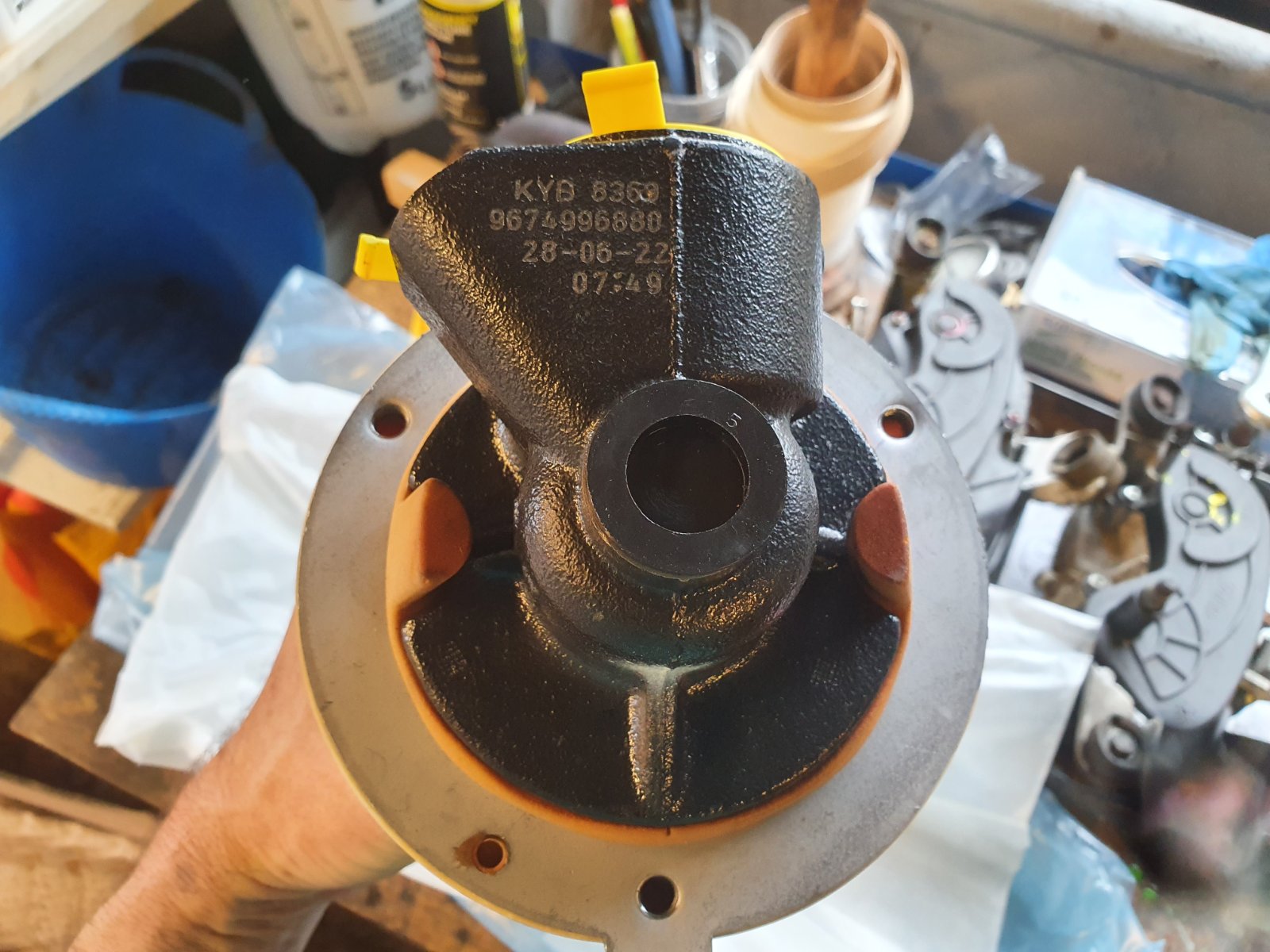

Hi all, my plan to start work on the rear suspension was scuppered by the sudden leaking of the front left strut. This was the original factory item whereas the OS one had been replaced at some point just before I took the car on last December. The manufacture date 2018 is clearly seen etched on the casting at the strut top.
I searched for and was pleasantly surprised to find the strut available (although the first one found on ebay from a Citroen garage was cancelled by the seller due to being out of stock..)

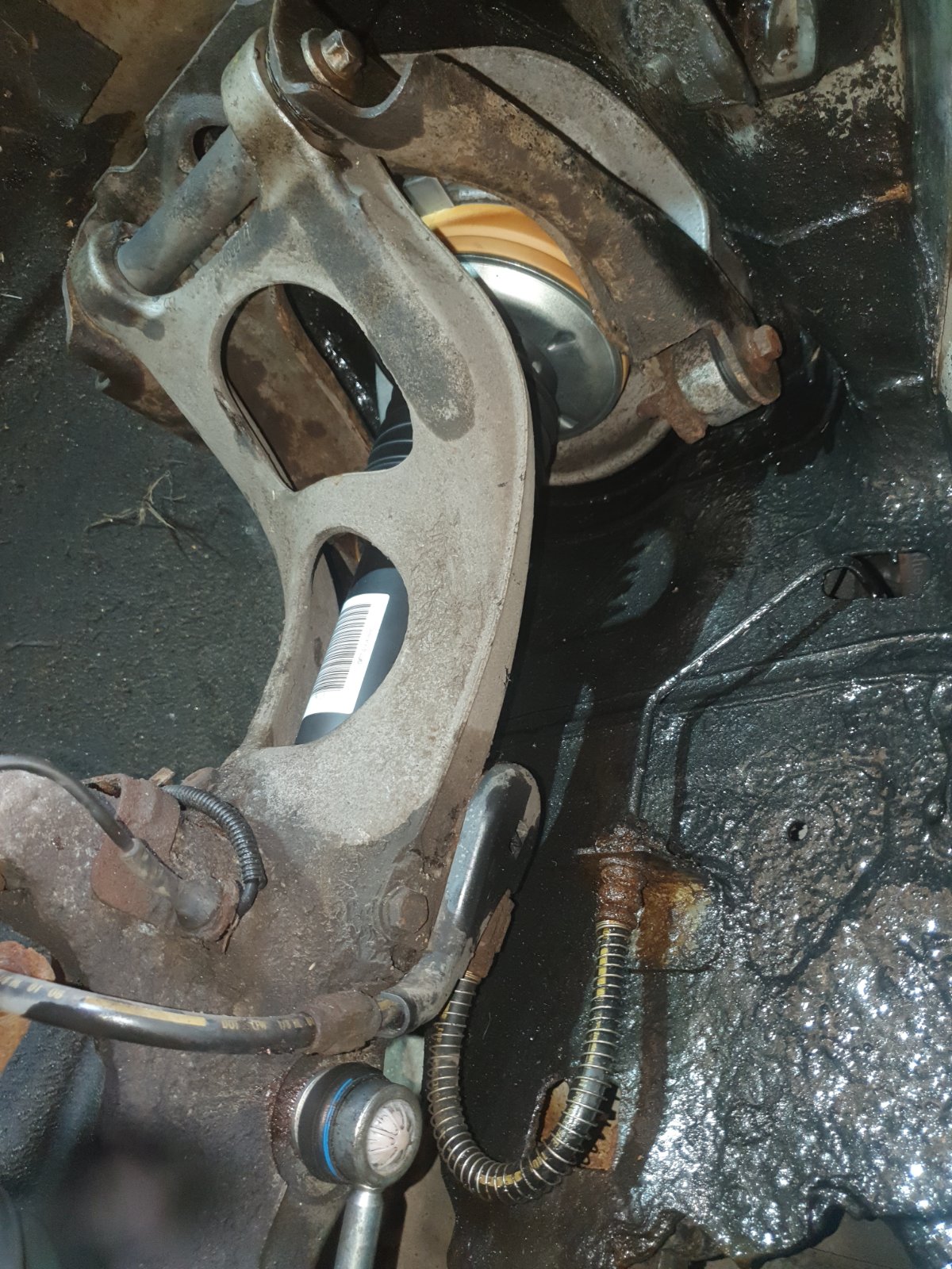

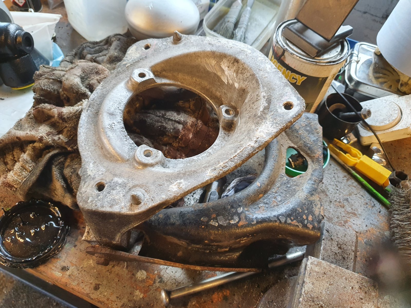

I didn't find it too difficult to change apart from the 3 upper fixing torx screws were seized. I opted to remove the upper strut plate with the strut itself.
Anyway I took photos for my records and here's a few:

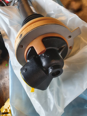

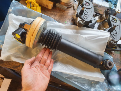

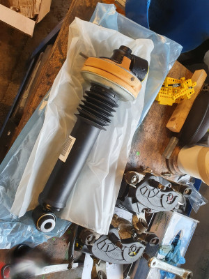

New LH strut.

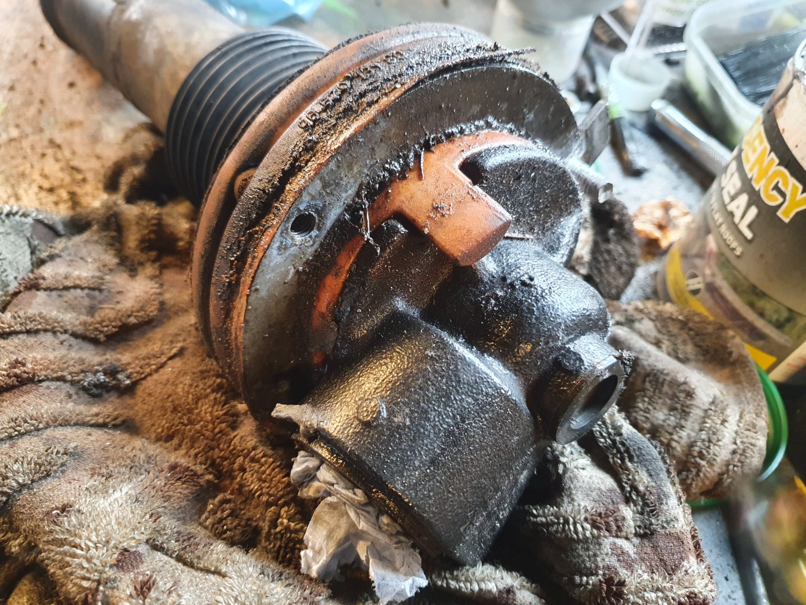

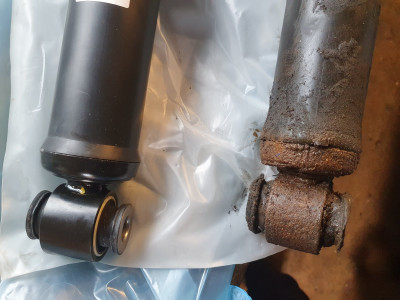

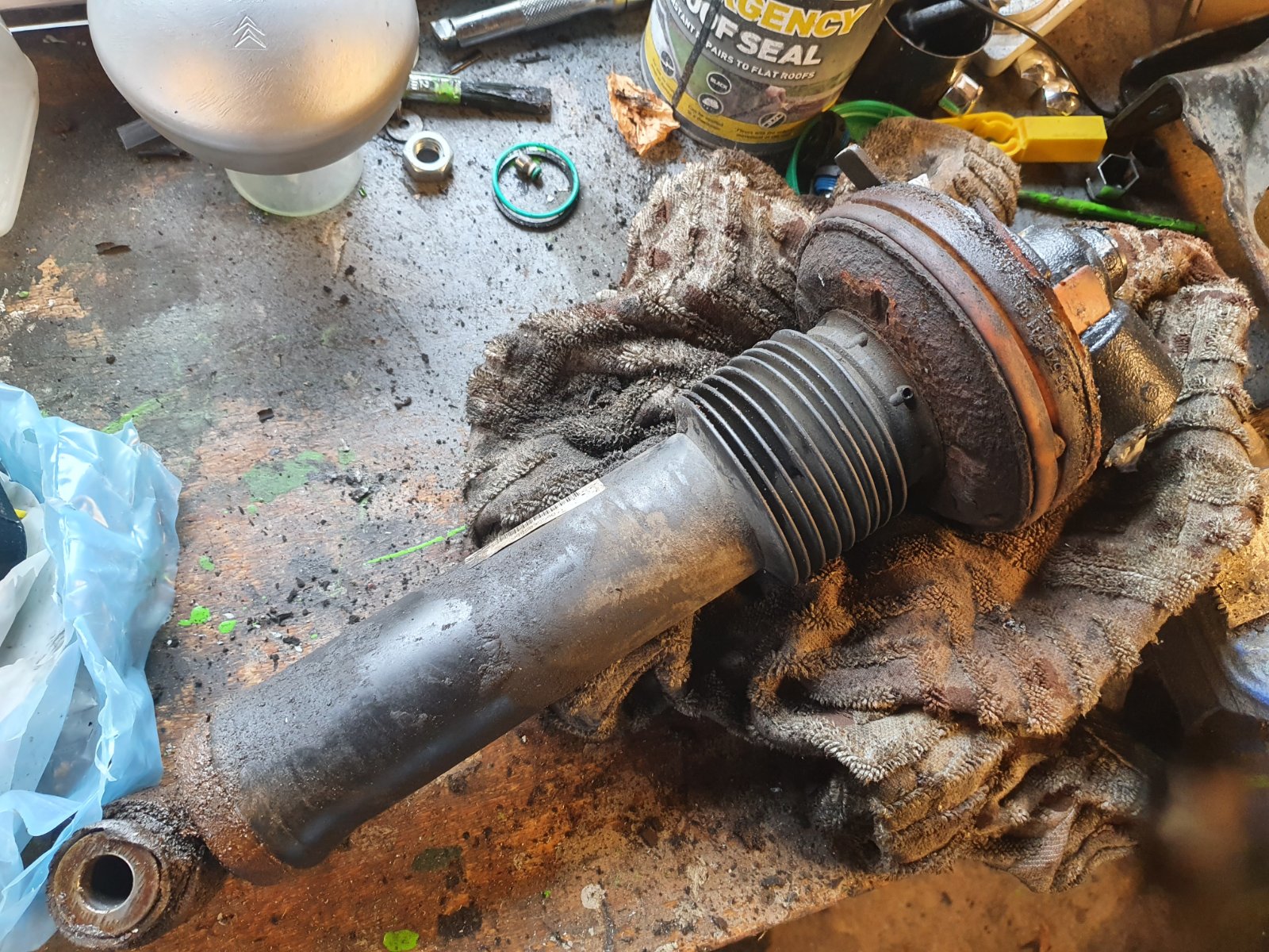

The old, leaky strut.

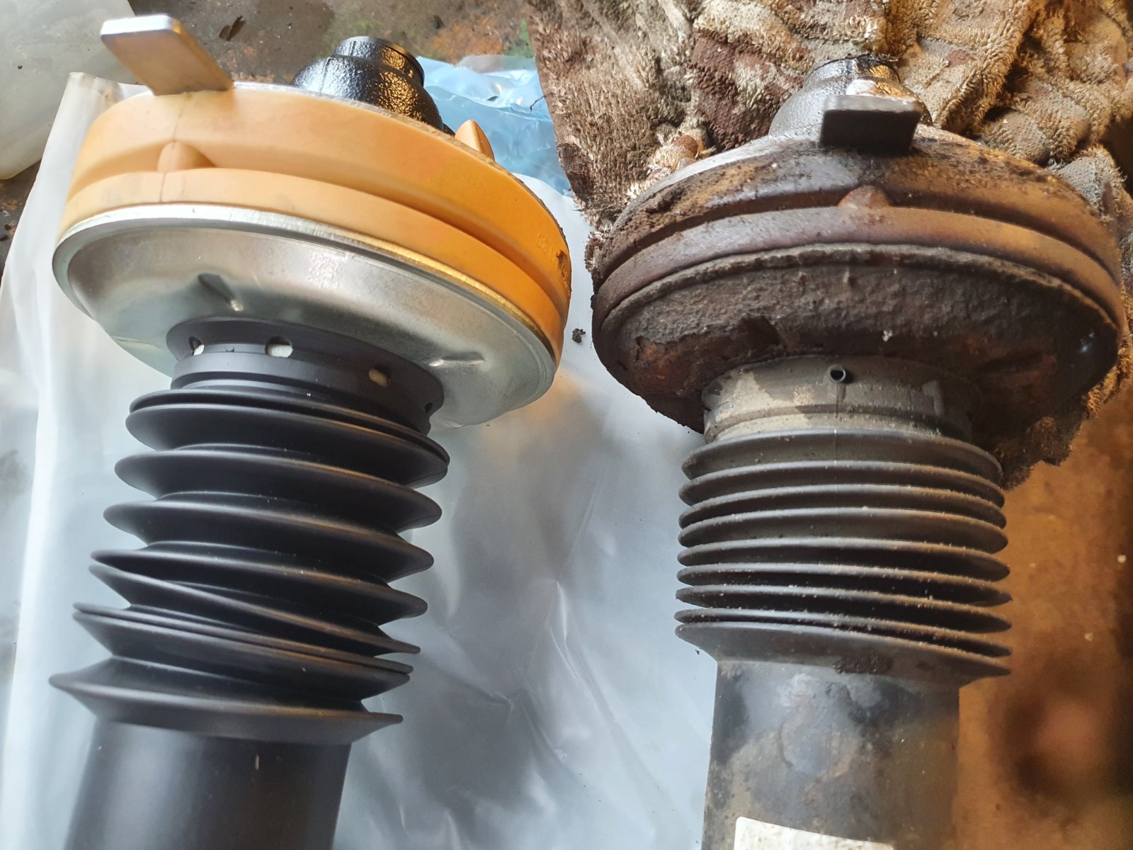

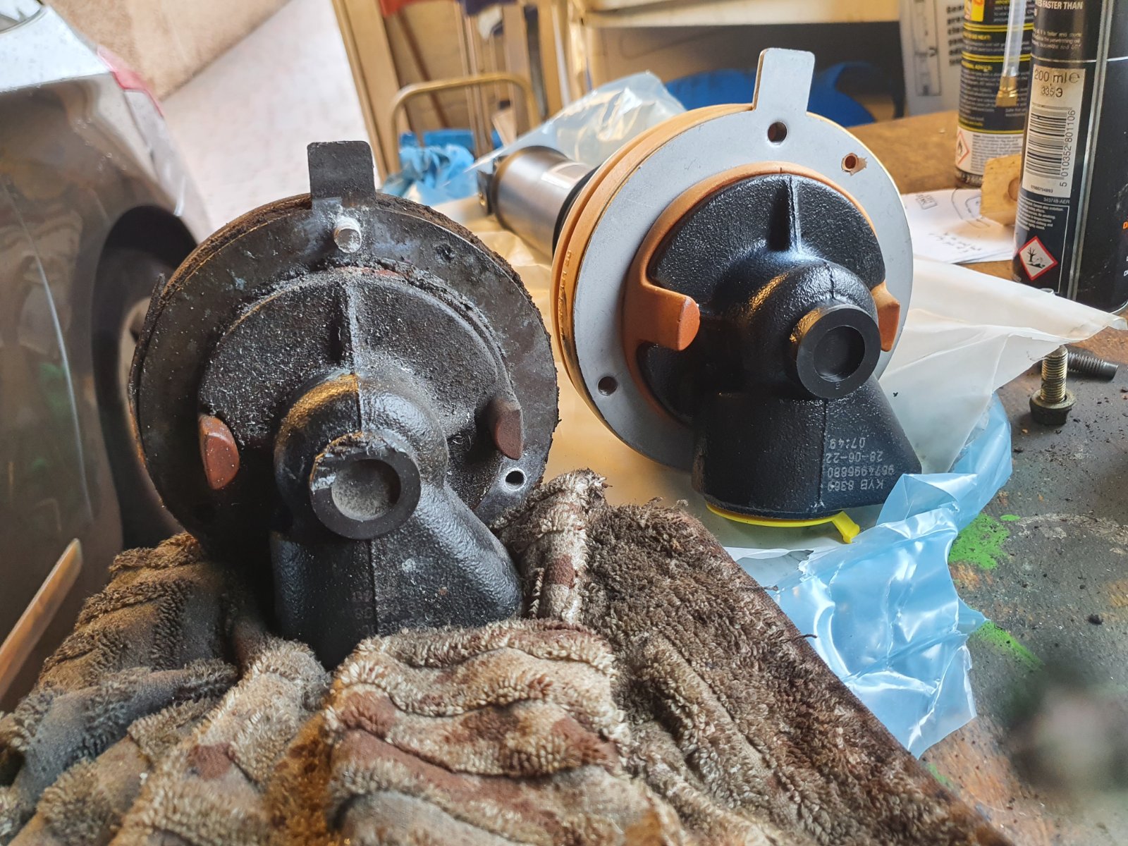

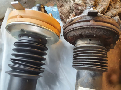

Comparing old and new:

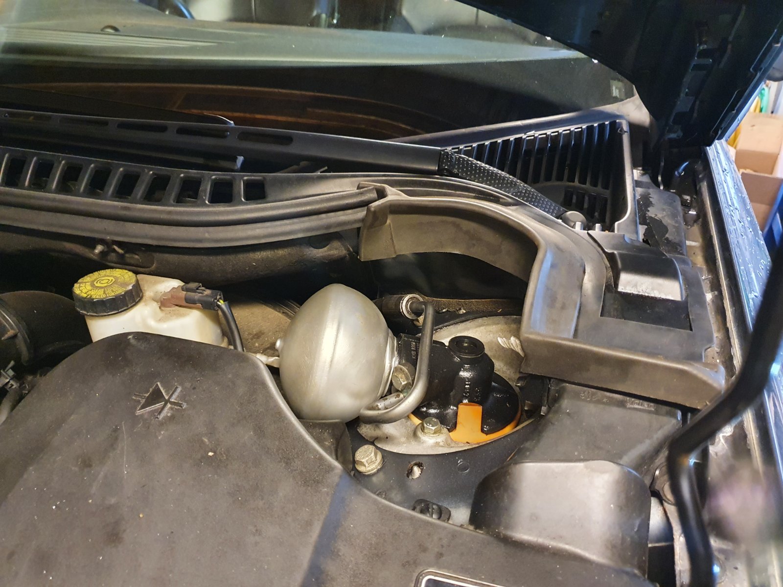

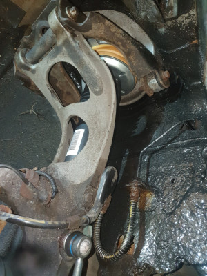

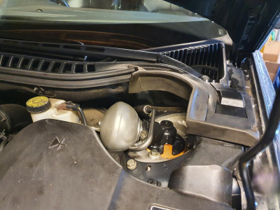

Refit:
Bled and repressurised the system and all good.
It's kind of bad that the hydraulic struts are not repairable like they were on all LHM citroens. You could replace the outer rubber bellows etc fairly easily. It's strange that the old LHM system was kind of 'allowed' to leak fluid that was caught in the rubber bellows and slowly fed back to the LHM tank. The X7 doesn't have this arrangement although I think the C5 I and II did. Anyone know how the X7 set up works? Do all four hydraulic struts simply not leak at all and hence don't need the low pressure leakage return circuit? Just curious really.

Thanks for great pictures. Excuse my ignorance - is that the common failure mode for these then? I've read of "leaky struts" = unrepairable but hadn't realised it was the steel corroding (had in my head some odd unobtainable seal, right in the heart of the strut was what wrote the strut off!)
Might slap some paint on whatever I can get access to in a bid to delay the inevitable,

Re: C5 X7 Front strut change today
Hiya Matt, well it's only my understanding of how it leaks. It seems to be that the rubber outer boot that is kind of loosely fitted along the strut length but fixed at each end upper and lower. Mine has a small gap at the lower end where the rubber has come away from the metal. It is likely caused by the corrosion but not certain because it might simply have detached from 14 years of vibrations. Anyway, slapping some thick paint on won't hurt. I took the opportunity to give the upper wheel arch a few coats of hammerite since the wheelarch liner was out.
