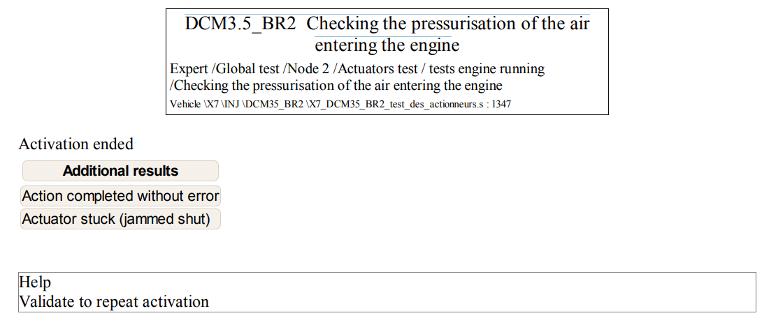

I have just tried doing tests and the ODB shows the actuator is stuck closed.
Does that mean the EGR actuator, or the Turbo?
attached photo of diagbox
