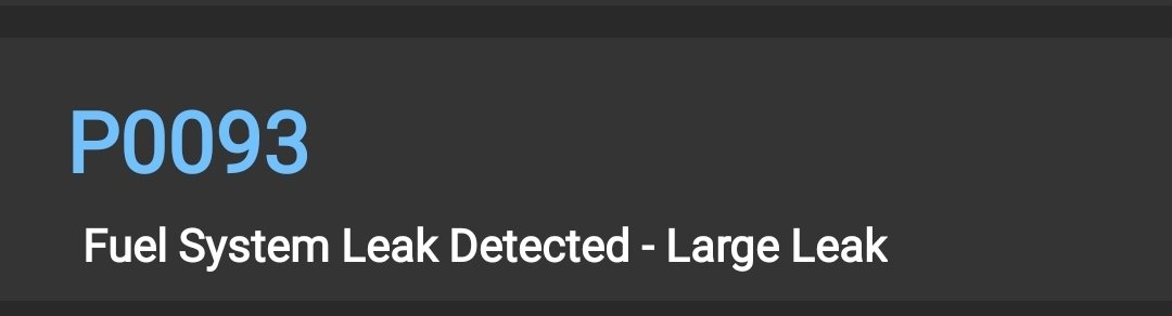

I ran a OBD simple scan that I have on it and and it
gives an error about a large fuel leak. But I can't
find such a leak. Fuel filter was only replaced 6

Got home and was having a look around the engine and ive noticed the priming bulb is sucked(kinda collapsed) in on its self - anyone know what going on here? Same error on my cheap OBD reader as above.
