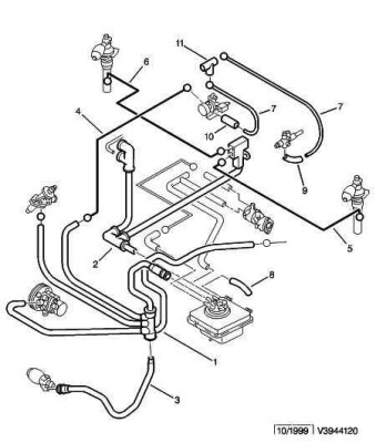

Further to my last post, does anyone know the name or part number of the LHM return 'spider' pipes that sit behind the engine (central to the 2 front wheels)?
I have replaced the 2 leak off pipes to the 2 front wheels (25 year old rubber pipes) and am thinking about the other pipes that may be cracking and brittle.
I have been researching and there seem to be several different types, have found this on eBay (see link: https://www.ebay.co.uk/itm/363676953787) that might be right but there are others that look alot more spider like lol, i.e. more complicated.
Thanks for any help.
Steve

Unread post by Stickyfinger »
stevestix8
Posts: 151
Joined: 06 Jul 2010, 20:34
x 13
Re: Xantia H.D.i. 2.0L LHM return pipes
Unread post by stevestix8 »
Hi Sticky,
Thanks for that link.
Mine is the Non-hydractive, Right hand drive.
I am not sure though when the cut off date between OPR 82820 and OPR 82801 was, mine was registered in the last week of Dec 1998.
Either way I have the diagram and will look at what other leak off pipes need replacing.
Cheers, Steve

Correction to last post:
Until OPR 08280
Since OPR 08281?
Posts: 55216
x 8462
The differences will be very slight Steve and not consequential...
