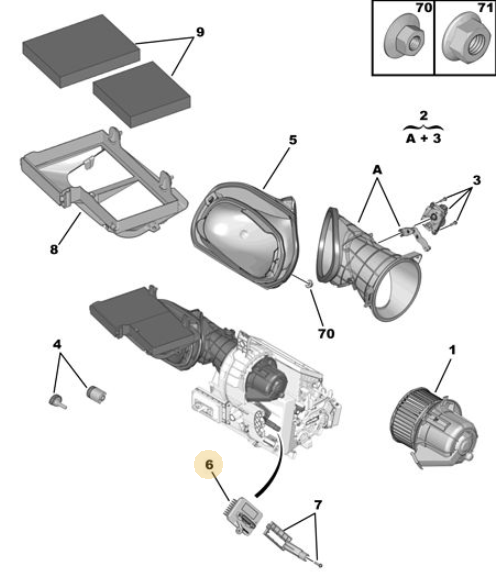

Anyway the module is located directly underneath the actual blower motor unit itself from the diagram Martin, item (6):
Part: 1610497380 if you think it is this.
I think you may need to remove the air ducting pipes to get to it though....

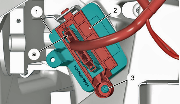

This is what you are looking for:
If it's working at all speeds, it's not that.

Thanks, Marc! From another (kind of dead) forum the item #6 with the part number you supplied is indeed what is causing the behaviour I'm experiencing. Good to know that it's actually called the blower motor control module. The part number you supplied leads me to a resistor supplied by a manufacturer called BEHR and is, as far as I can tell, just a simple resistor. Much like I already knew from my old Pug 306 which was known to need to have the fan control resistor replaced from time to time. Here's the link for anyone interested: https://bartebben.com/catalog/product/v ... ory/42440/
Thanks for the diagrams; I am now ready to have another go at locating the part. From the other forum it's just a matter of unscrewing the torx #3 in you last picture and the resistor (control module) should be accessible. I'll keep you posted.
