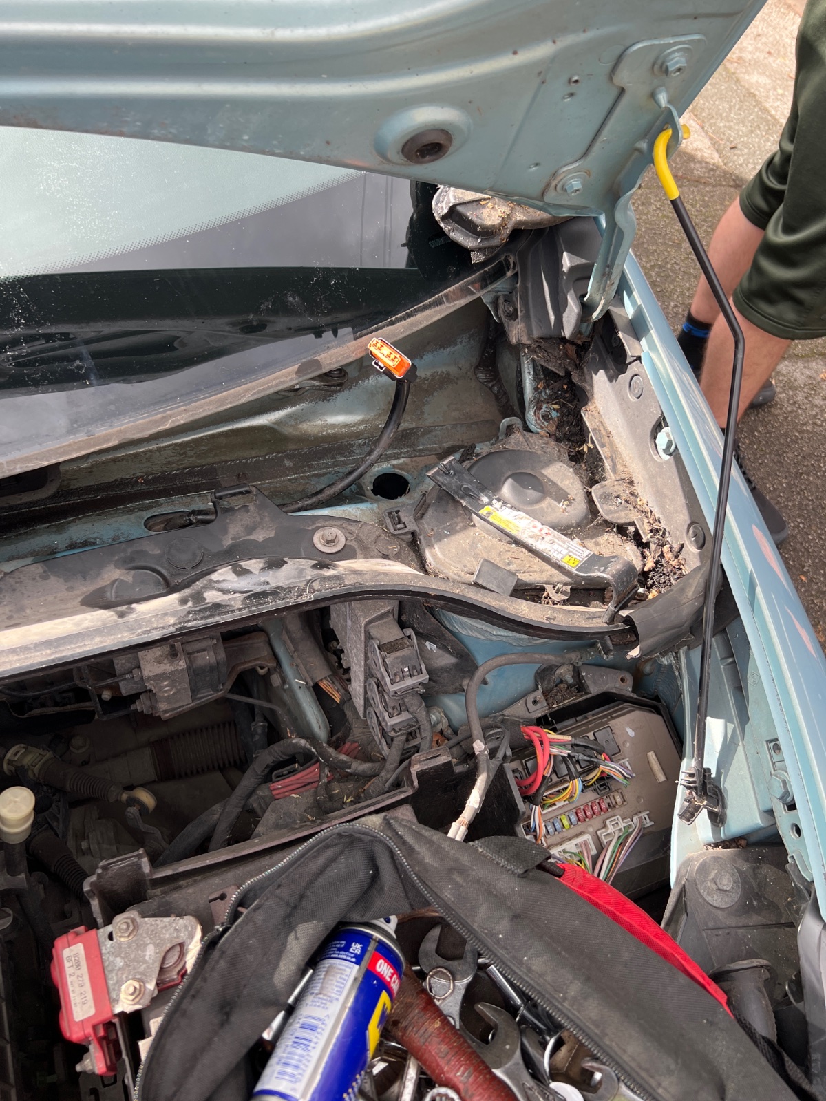

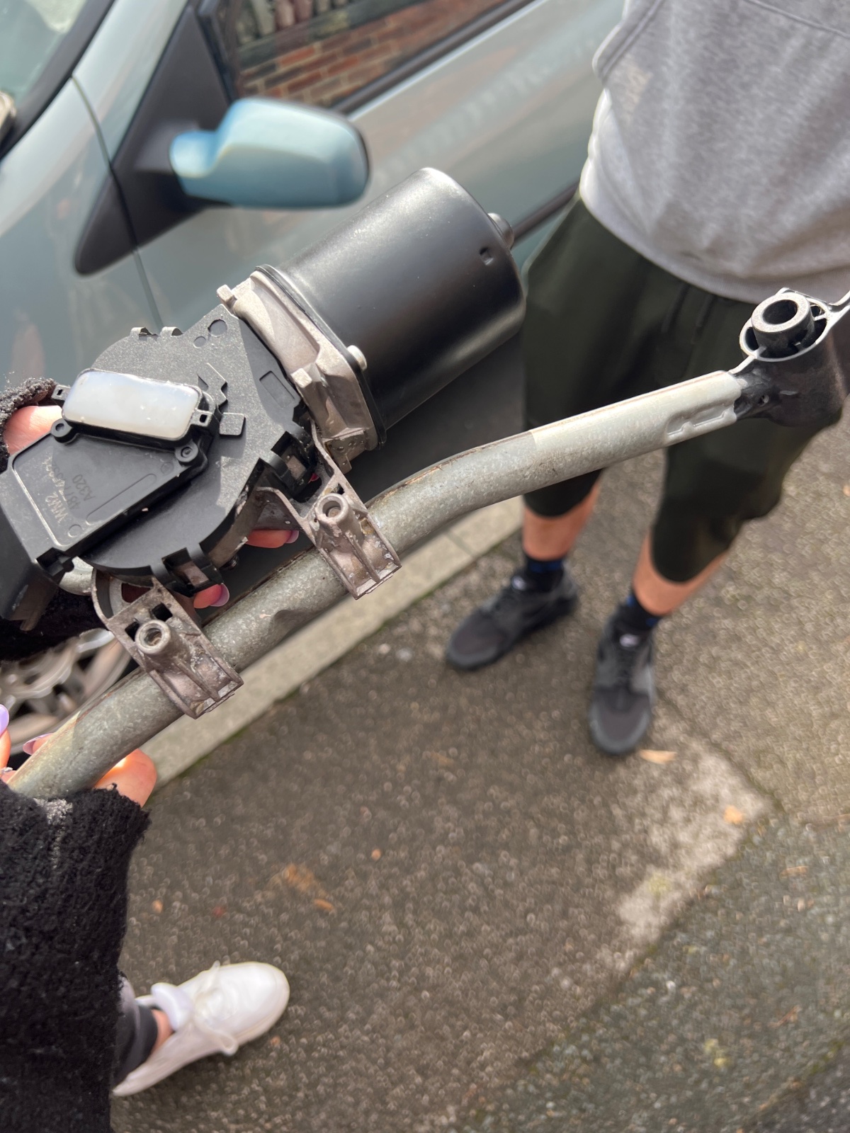

Hello everyone,
Have so far tried a fuse change, removed wipers and checked if anything is seized (motions seem fine) - the motor looks pretty new and clean so we are sure it’s not that either. Anyone have any advice?

Nothing first hand from me, but doing a query on a specific renault forum produced this.
It is one of those threads however which go on a bit, probably over complicate matters, and end up unresolved, except at a suck it up and let the dealer loose with a replacement of what is known as the UCH. With an older Renault the expense of this virtually ensures a journey to the scrapyard for the car.
https://www.renaultforums.co.uk/threads ... ng.549977/
Page 2 of the thread (last post as of now) after the OP decided that it wasn't worth going down the replacement UCH route, another poster had a problem resolved by a replacement of the motor (which had seized/burnt out) and blown a fuse in the engine compartment fuse box.
Hope you find a resolution, I would probably head for RenaultForums.co.uk or Cliosport.net and post your problem there.
As mentioned in the thread, (where there is this link), there are services which can repair UCH should that indeed prove to be the problem. I would be looking for something simpler, electrical connections, relays, wiring continuity,
wiper motor, fuse box. etc.
