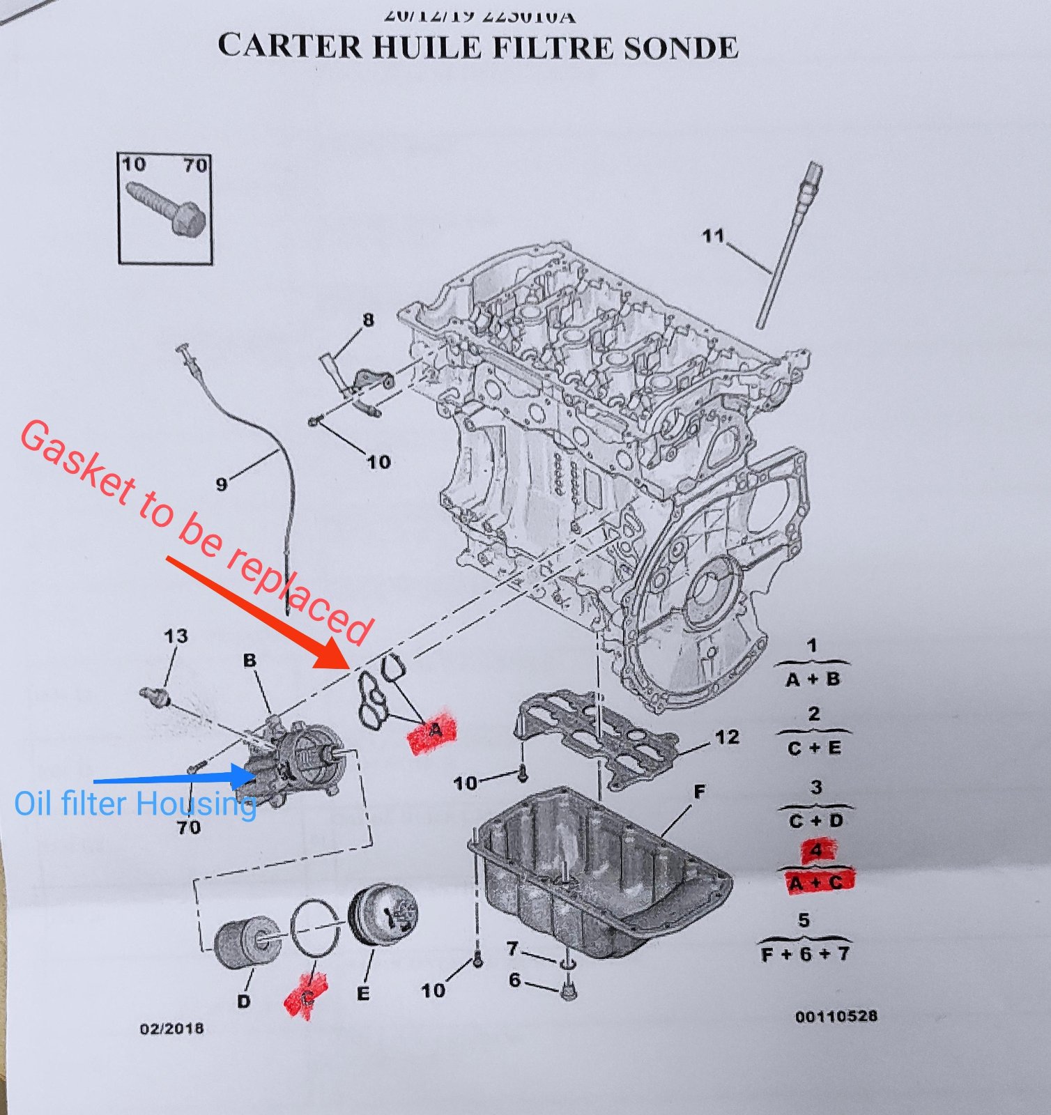

Noticed a leak coming from the Oil Filter Housing in contact with the engine and need to change the gaskets (part number:16 135 719 80)
As Citroën no longer has a dealership near me, a local mechanic said he must remove the exhaust to be able to dismantle the oil filter housing (as 1 or 2 bolts out of 4 are located behind the exhaust).
I found this strange. Why Citroën would hide the oil filter housing behind the exhaust, difficult to remove and time-consuming.
Do you think no way to remove the oil filter housing without removing the exhaust?

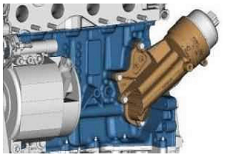

Looks like it can be from either the Oil Filter Support on the Cylinder Block:
Sealing:
- 2 separate seals
- 4 bolts
Probability: Low
Possible Causes:
- Incorrect tightening of the fixing bolts
- Faulty seal
- Absence of seal
Access: Difficult
Repair: Replace the seal (Set of seals)

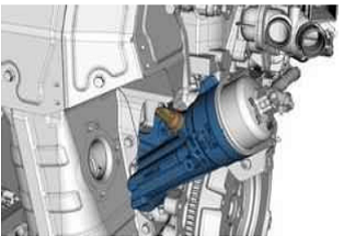

Oil Pressure Sensor on Oil Filter Support
Sealing: Sensor screwed onto the oil filter mounting
Probability: Low
Possible causes:
- Incorrect tightening : Sensor
- Sensor faulty
Access: Average

I had to remove the exhaust to access 2 bolts out of 4. Now the gasket has been replaced. Tomorrow will clean under the engine and the area around the housing to spot if new leaks occur. If yes, then that gasket was not the only source of leak.
