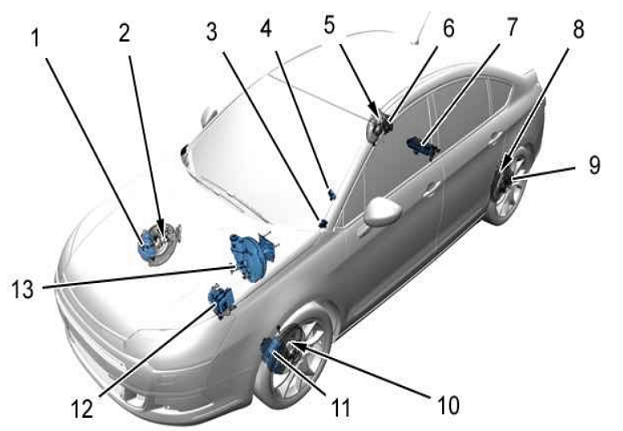

Hi Bailey
Well the ESP / ABS Block and ECU is located on the passenger side approximately under the fuse box shown at (12), so it is quite possible if you were having the passenger strut replaced on the left side (you didn't specify) that something has upset one of the wires or connectors, or some fluid has penetrated the area.
Without a fault code I can't point you further. It could be a totally unrelated issue and a red herring of course, if something else has caused the engine ECU to deactivate the cruise or speed limiter.

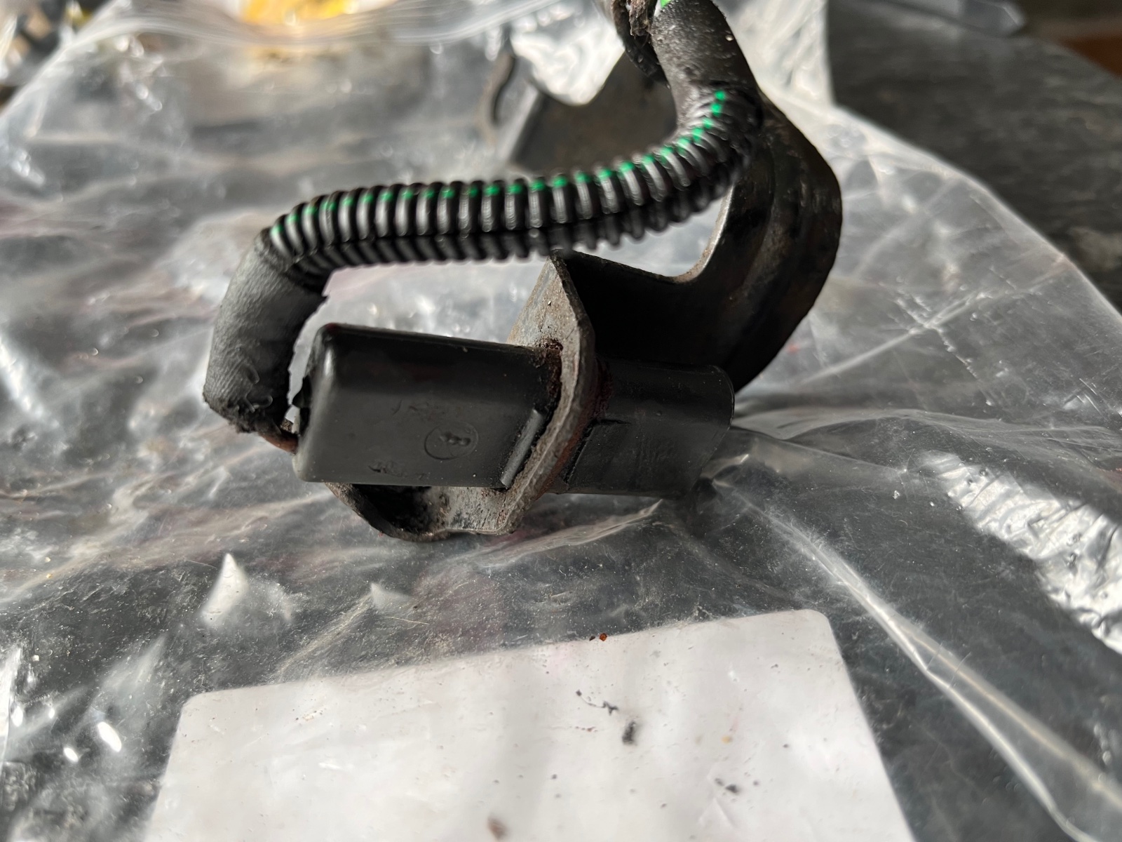

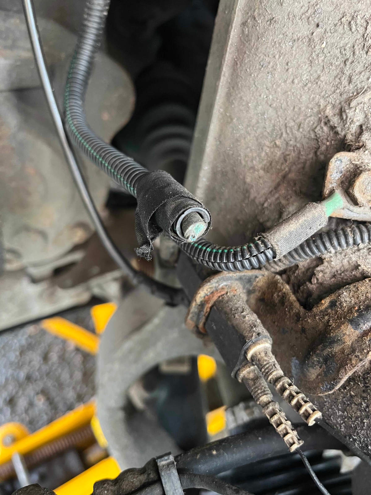

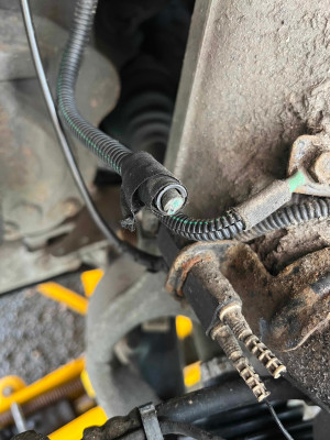

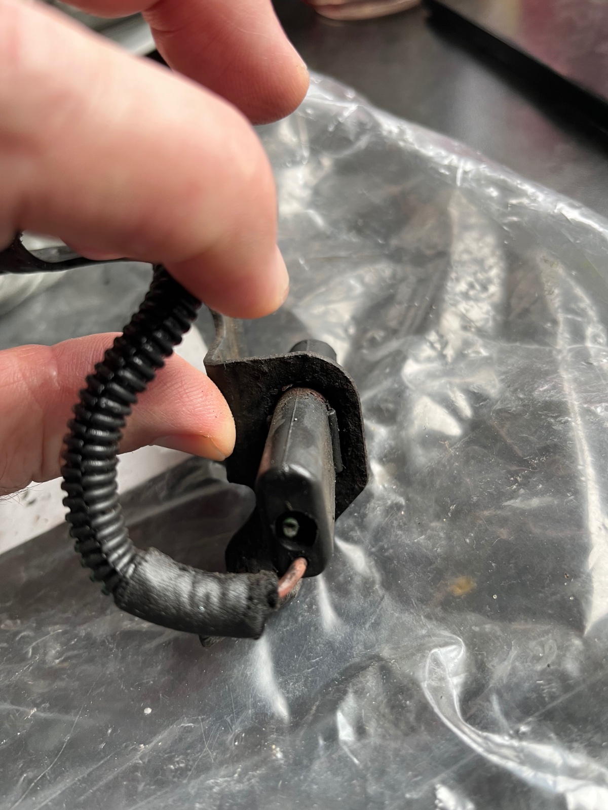

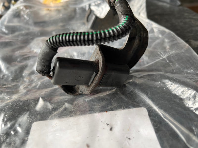

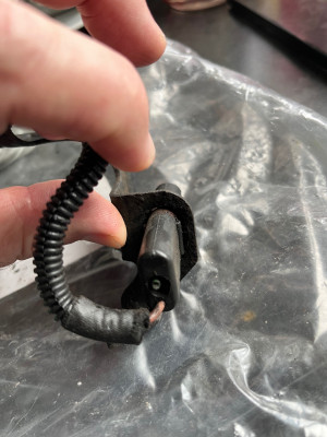

Right,
I'm hoping I've found the culprit. A broken positive wire to the brake wear indicators. Does this complete/have any influence on the Cruise control circuit?
This is the first thing I found when I took the wheel off. Have;t looked any further.
If this is the cause, how much of this cable assembly do I need to replace? I can't seem to push the main rubberised cable block out of the earthing mount frame support. This could be due to corrosion or the fact it was press fitted at the factory? Annoyingly the wire has snapped off flush with the housing so I can't even splice the 2 wires together.
Hope the pics are self explanatory.
Bailey
58 plate (2009) C5 Tourer 2.0 HDi VTR+
x 6956
Re: C5 X7 loss of Cruise Control
The only thing that would affect the cruise control concerning the brakes is the actual brake switch at the pedals which disengage the cruise when pressed.
The brake wear wiring won't impact on this as it's just a resistance-based system that changes resistance as the pads wear down to the pins and throws the light up.

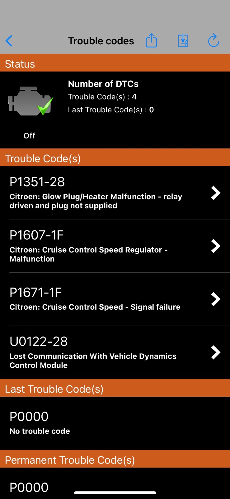

Hi,
actually got round to buying a code reader at last! Occasionally get an emissions error pop up, but a good blast for 20 mins normally sorts it. Must be related to the glow plugs.
It shows there are codes related to the cruise control.
I've tried clearing them, but even without actually driving, the errors come back.

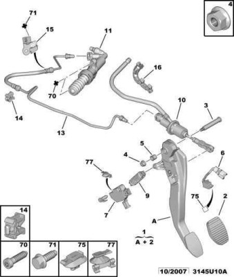

YES, there is a clutch switch as well (no 6).........if there was not the engine would over rev when you dipped the clutch (if cruse was controlling the speed at the time)
If I recall correctly the brake switch has a dual function, brake lights can still work but the cruse signal part can fail...........( ? maybe wrong on that? )

Before looking at the other fault codes, look at resolving this one first, as if there is any issue with the ESP system, cruise control and speed limiter are the first functions to be deactivated, along with others like hill start assist etc.
Fault Code: U0122
Description of Fault: CAN communication: Absence of communication with the ESP ECU.
Description of the diagnostics: Absence of communication with the ESP ECU
Conditions for Fault to clear:
  • Driving for 5 minutes
Downgrade Modes whilst Fault is active:
  • Deactivation cruise control until the next time the ignition is switched on
Symptoms: -
Suspect Areas:
  • CAN network
