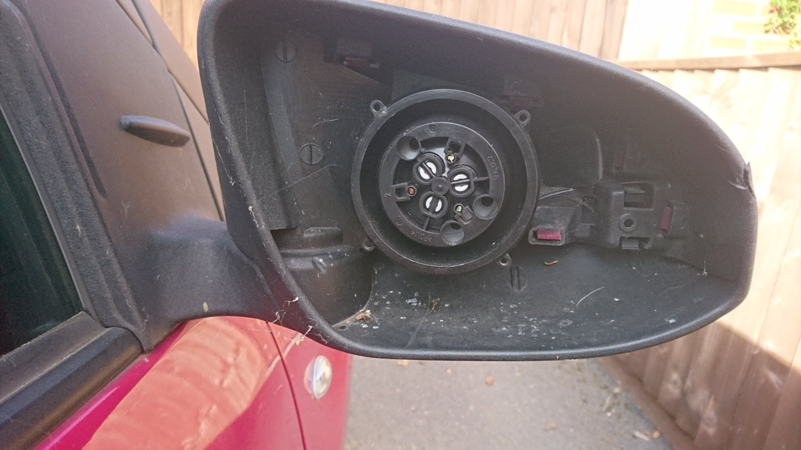

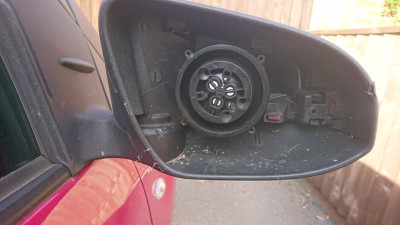

My niece has a 66 plate C1 and yesterday morning she went to the car to find the mirror glass missing from the drivers mirror.
I am unsure if it is a heated mirror but i have been told it is not electrically adjusted.
I do not have the Vin but Reg is HN66 FNZ.
Is there a replacement guide, does it have a clip securing it etc and could i possibly have a replacement part number.
She has sent me a picture of the housing which i will upload in a minute if anyone could check it out for any possible damage .

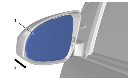

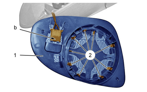

Guide:
Adjust the position of the exterior mirror glass (1) (Following "a").
Pass a trim removal tool behind the exterior mirror glass (1) and unclip the exterior mirror glass mounting lugs (2).
Remove the glass from the exterior mirror (1).
Disconnect the connector (at "b").
Remove the exterior mirror glass (1).
Replacement is the reverse of the above, so when she gets a new glass, it should clip onto the back easily enough by pushing onto the lugs shown.

No worries, I suspect it may not be heated as she doesn't have the electrical operation, but best to be sure.

Re: C1 Drivers mirror glass replacement
Thanks Marc
Looking at the photo there is no plug or any wires so i am with you on the thinking it does not have heated mirrors
Colin
