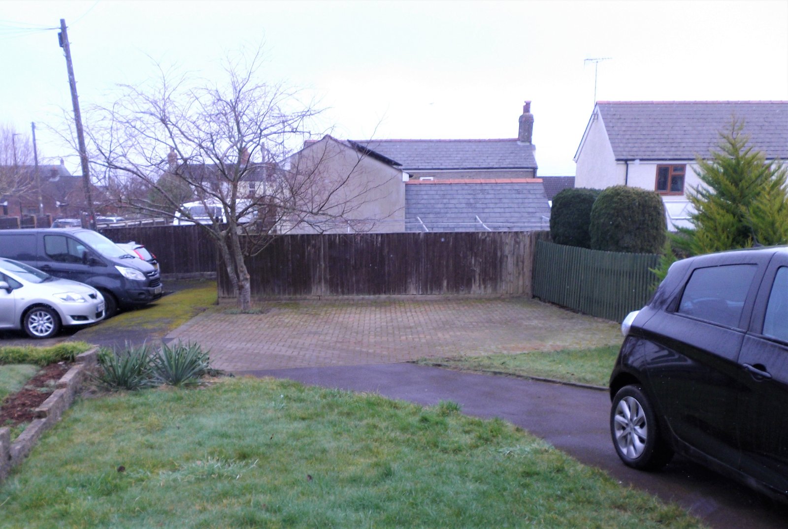

I wonder what sort of a hissy fir the local planners would have if I applied to erect a car port with a solar array like that guys here on my front yard.

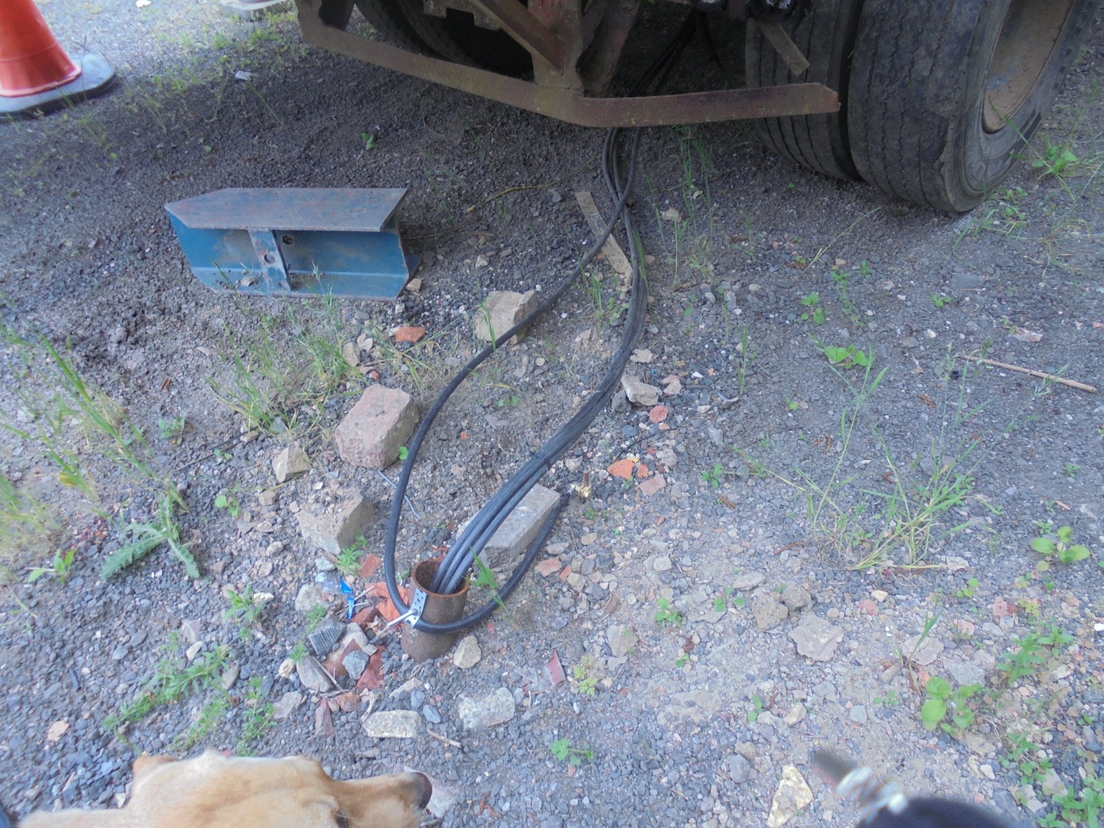

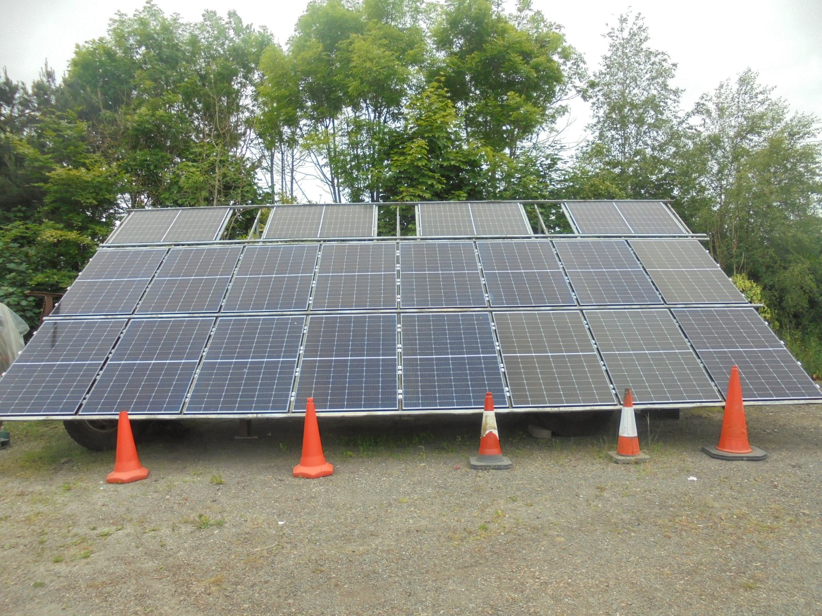

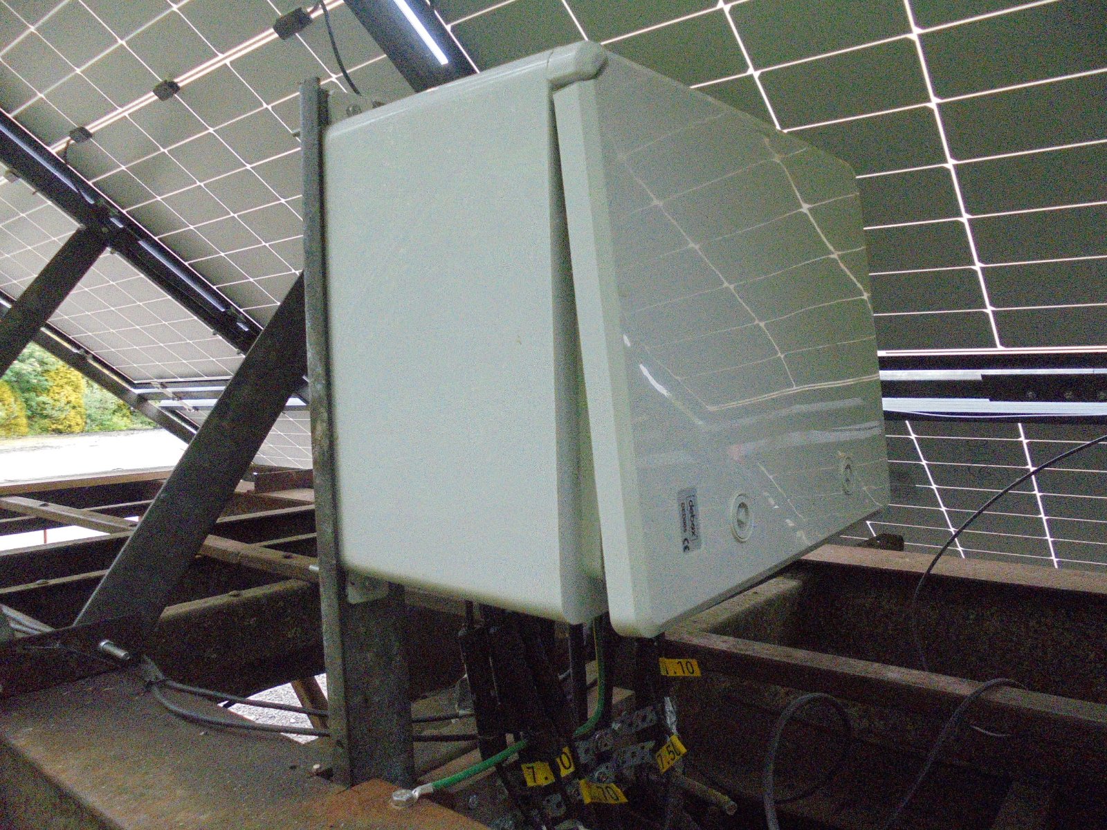

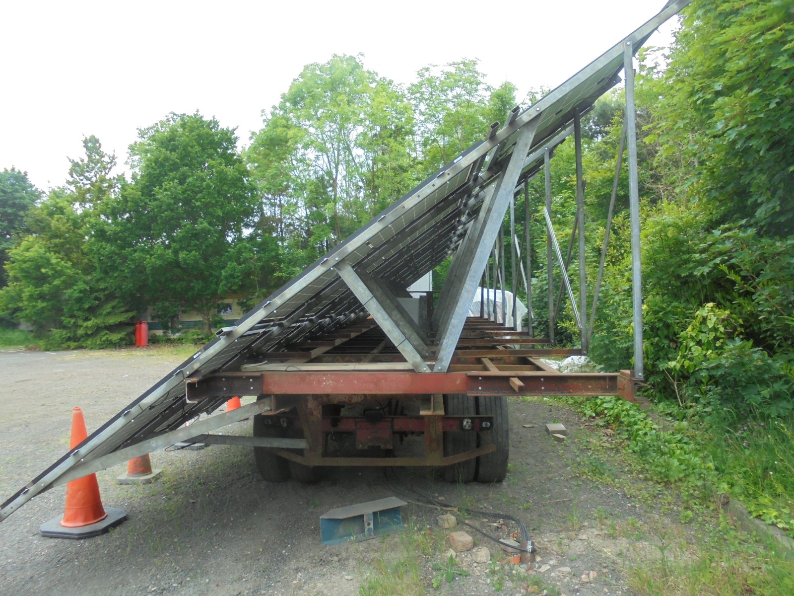

Never mind clambering about on roofs, not a ground-mounted array, but a trailer-mounted array. This nursery just happened to have an old trailer lying about and the simplest ever panel mounting structure, with the wires feeding into a small control box and onwards down a tube underground to point-of-use.
