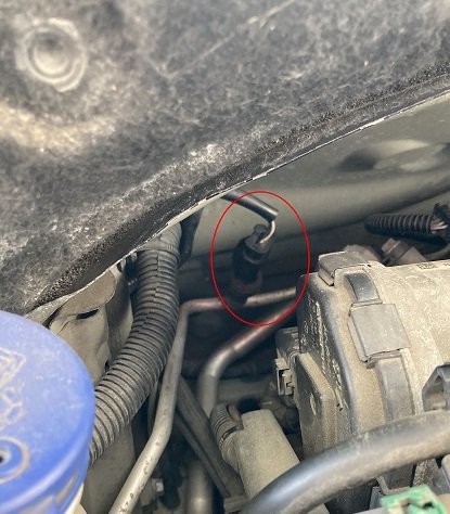

First my mechanic believed the PSF1 part was out. We had voltage in and nothing out.
So we changed it but without result.
Than immediately after he connected the diagnostic socket and the computer, he touched the pressure sensor wires and we heard the "clic" of the compressor
Airco. was working again.
Here is the photo of the sensor
Thank you very much again Marc and the others who gave me advice.
Best regards
Philou4130

That's the "high side" pressure sensor. The engine ECU reads it to determine 2 things.
1) If the pressure is too high or too low it wont engage the compressor.
2) The pressure determines how fast the radiator fan runs.
Unfortunately LEXIA does not tell you what pressure is in the AC high side. Only that the compressor operation is enabled or disabled. Not helpful!
So with no signal from the sensor your engine ECU would have read the system as having no pressure and it would not have allowed the compressor to run.
