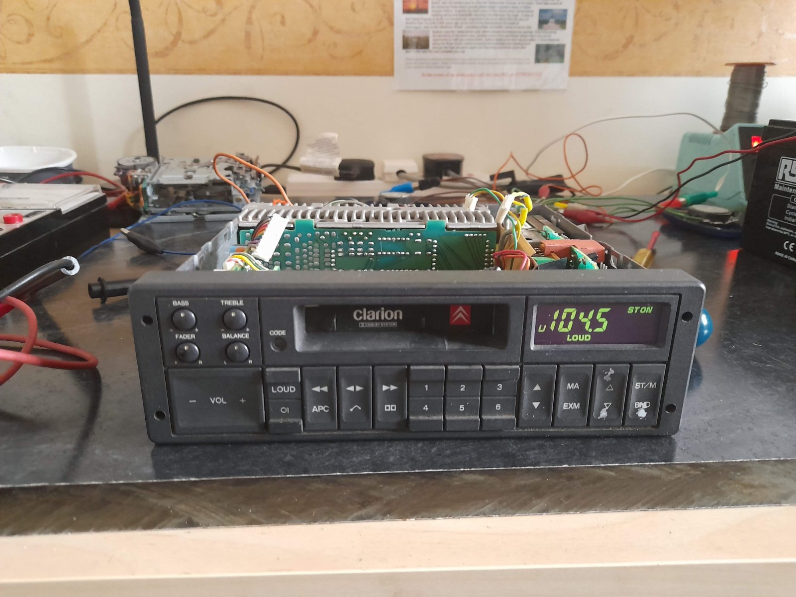

Looking at an old and long thread on the Club-XM forum detailing how to defeat the codes and reset these wirelesses, I tried holding down the BND (Band) button to do a hard reset and after a minute or so it fired up and appeared to work. FM radio good and all four audio channels good. And it never even asked for a code! Happy days :D

It was too good to last... After a couple of minutes it died and not even a hard reset would work until the power supply was disconnected completely and reconnected. A further hard reset would allow the thing to work for a further two minutes or so.

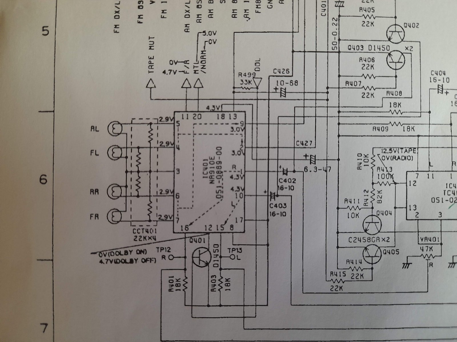

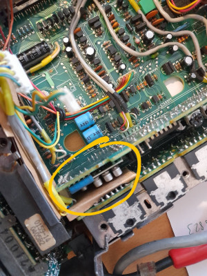

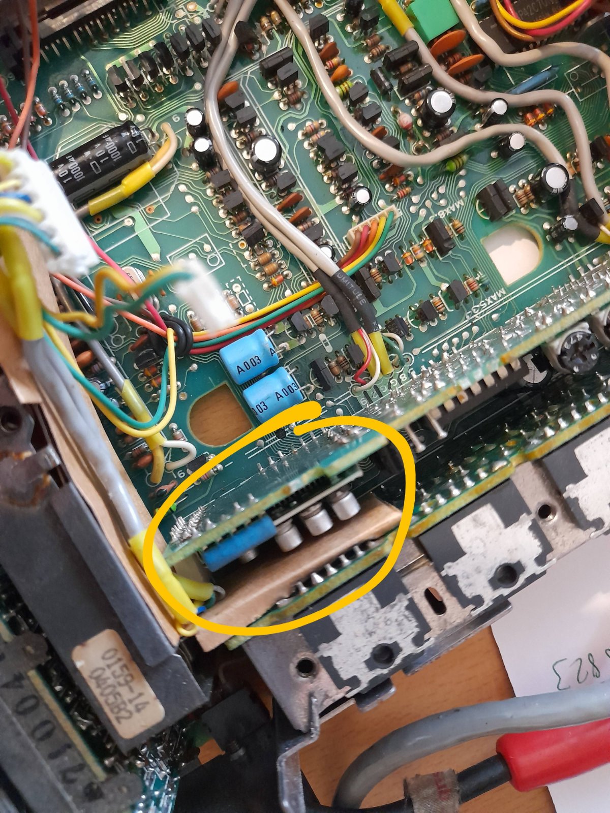

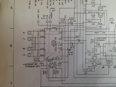

Scoping through the circuit, the audio from the radio is present at the input to IC401 - see diagram - but there is no output from IC401. IC401 is not just an Integrated circuit - it's a small module and acts as the tape head amplifiers and an audio preamplifier after tape/radio switching selection logic ahead of the audio processing IC and its onward path to the power amplifier modules. IC401 is particularly inaccessible, being a daughter board on top of a daughter board! It's the item circled in yellow in the picture... The IC on this daughter board appears to be a special as Google knows nothing of it...

I suspect this component is the root cause of the tape issue in the first unit too... Maybe the Achille heel of these radios? I'm suspecting duff electrolytic capacitors as the little daughter board is full of them and of a different style to the ones in the rest of the radio...

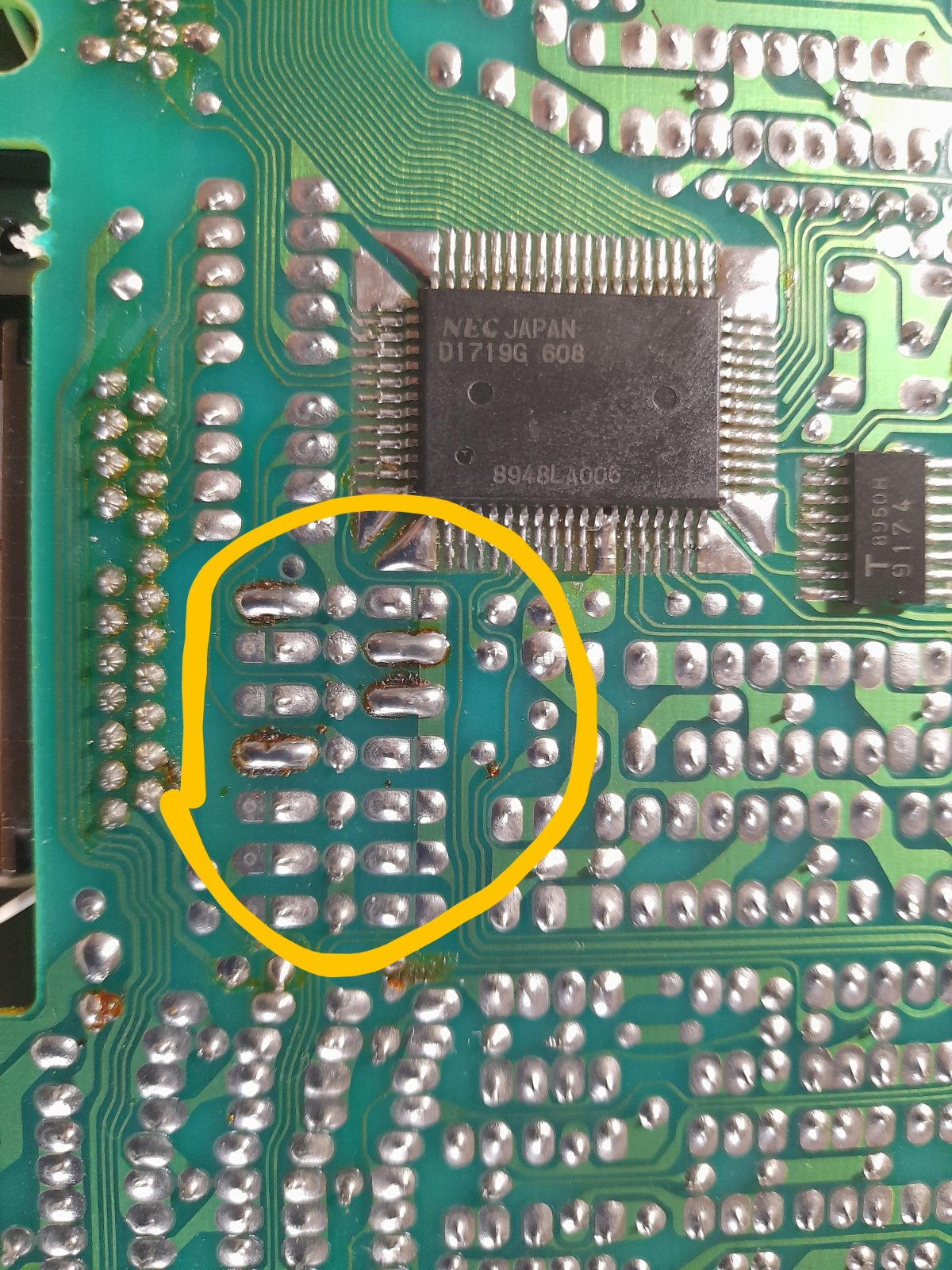

To de-code these radios, remove any solder 'bridges' in the area highlighted in the photo below... The photo shows a number of 'bridges' in place. Solder wick followed by a good cleanup with Isopropyl and a careful check to ensure the 'bridges' are all clear is the best way to do this. Don't try to de-solder the big blob on the corner of microcontroller... In retrospect I should have made the yellow circle a bit smaller to encompass only the bridgeable pads...
Radio Code 'Bridges' within highlighted area
Once all solder bridges are clear, the code will be set to 1112.
