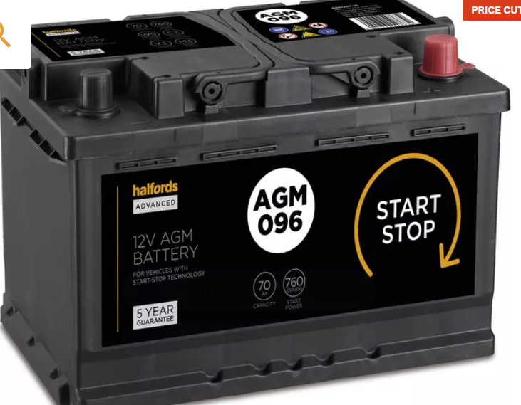

Could you tell me if this battery is definitely the one for my car please?
https://www.halfords.com/motoring/batte ... 2vEALw_wcB
Halfords suggest it is but I wouldn't fully trust them.

Re: Error message on c4 picasso app Faulty Engine Control System:
You need an AGM battery with 70AH and 760A
So that Halfrauds one will be fine.

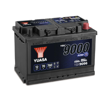

If I'm not mistaken the Halfrauds ones look identical to the Yuasso ones Richard, as I had a look at those earlier. The Yuassa equivalent of this (from the VIN) comes out at £252! That's when I noticed that the battery structure, colours and such look identical.
What do you think?
I read on a BMW forum, that the top of the range Halfords batteries, are indeed made and supplied by Yuasa and are to an identical spec.
