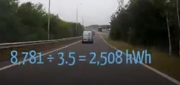

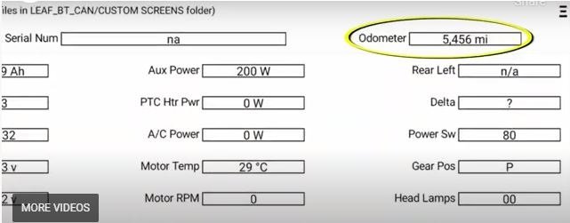

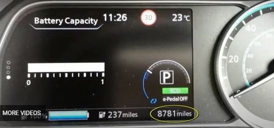

With regard to the lady's video posted above:
Clearly the discrepancy in the distance recorded is simply that the car's odometer is in Km despite being labelled miles, however the point that struck me most was the import export figures which showed a net import of approx 2000 KWh which is less than the power used for travelling although the figure of 3.5 miles per kWh should be 3.5 Km per Kwh as the odometer reading is in Km despite the labeling. That would make it 2.1 miles per KWh which is less impressive altogether. Could this be another Nissan attempt to dupe the motorist after dieselgate?

Cant see where that comes from Mick
Speedo main display large numbers in mph, Odometer plainly miles, economy monitor mile/kWh, and 3.5 is about right. (mine is showing 4.6 miles /kWh....summer and a lighter battery at 24kWh)
The thing that is wrong is Leaf Spy! A non-Nissan plug in tool which probably has the wrong formula in that box!
PS that is confirmed in the intro blurb. Leaf spy assumes the odometer is in kilometres (when it isn't) and does a conversion.
Regarding why the Odometer and LeafSpy differ in displayed mileage, for some reason, LeafSpy believes the Odometer figure is in Kilometres and - obligingly but erroneously - changes the figure to Miles for us. (My brother pointed that out about two hours after the video went live which was a bit embarrassing!) Anyhow, now we all know.

Re: Energy Matters Global and Domestic
The odometer reading in the car is exactly the leafspy reading converted from miles to km. Too much of a coincidence for me to believe that leafspy has the wrong figure because why would it be the same distance?
You can see her calculation used the 8k figure which is the issue!
5261/3.5 = 1503 kWh for reference!!
Now read your edit while compiling that so at least that clears it up!! I would imagine there is a setting in the leafspy software for you to define distance in miles and it has been set in km or something of that nature!!
