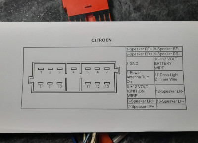

Just started on attempting to restore a pair of unknown condition S1 XM Clarion PU-9358A wirelesses to working condition...
Once I'm properly up and running I'll kick off a topic detailing my work if there's any interest...
I've searched but can find no details of the big red connector. I know speakers and power pass via this connector but cannot find details of the pinouts...
Can anyone help please?

I presume you have already found the internal schematic, I think I have a copy if you need it.

xantia_v6 wrote: 22 Aug 2022, 17:57 I presume you have already found the internal schematic, I think I have a copy if you need it.
Yes, got the schematic Mike :) And your post on Club-XM has answered my question. After doing a few initial checks I'm almost certain this is right - thanks hugely :-D I can now properly get cracking!
XM Red Connection Pinouts - Via the Club-XM Forum

The diagram above is almost right, the only bit wrong is the Ignition and Battery wires are transposed as far as I can tell..
