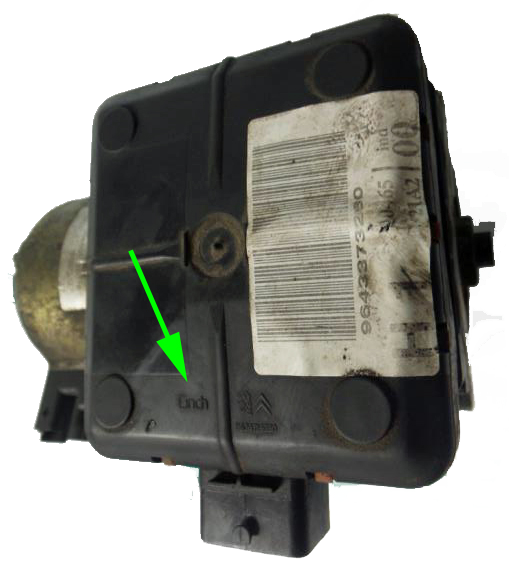

The manufacturers of the BHI units are Cinch IIRC, and they are part of the bel group - making connectors for Boeing and the Cray supercomputers amongst others ..... Oh dear, better change that next flight to Airbus.
But seriously, they do seem to have a large portfolio now - and the European Headquarters are in Chelmsford. I suspect the BHIs were a custom project and won't therefore be in their product portfolio.

It would be interesting - but I wonder if they make the whole assembly including the motor, or just the electronic interface housed in the black square unit on top of the motor. If you look below, you can see on this unit the name 'Cinch' and looking at your engine bay photo in the post of the same - you can just about see the same on the right hand side of the unit (with an electron microscope
I've scanned their literature and can't see any reference - to PSA or 'suspension, BHI, Hydraulics' so I can only assume custom build projects are not openly available and parts are channelled directly to PSA.
Interestingly, they do seem to make a lot of Audio cables and connectors too - and the equivalent of our RCA connectors are referred to as 'type Cinch' in Germany - and also in the RT45 Navidrive manual. That really is my geeky bit done for today

Doubt very much whether they get involved in making motors. As said, connectors are their forte, plus electronic modules, cases, instrument panels, etc.

All very interesting. probably one of the biggest firms I've never heard of. Could the lip on the brush have been shorting out on the center of the shaft perhaps, as it slid over the commutator bars? I'm assuming that brushes directly opposite each other are of opposite polarity?
I have a suspicion that the mechanical hydraulic pump and motor are made by someone else Marc as when the ecu is removed it appears to have been designed to allow an assembly worker to add the ecu to the valve block as the solenoid coils are in the ecu and the plungers are in the valve block:

EDC5 wrote: 26 Jul 2018, 12:54 I have a suspicion that the mechanical hydraulic pump and motor are made by someone else Marc as when the ecu is removed it appears to have been designed to allow an assembly worker to add the ecu to the valve block as the solenoid coils are in the ecu and the plungers are in the valve block:
That's correct Elis - it's only the hydroelectronic block ECU that is made by Cinch.
