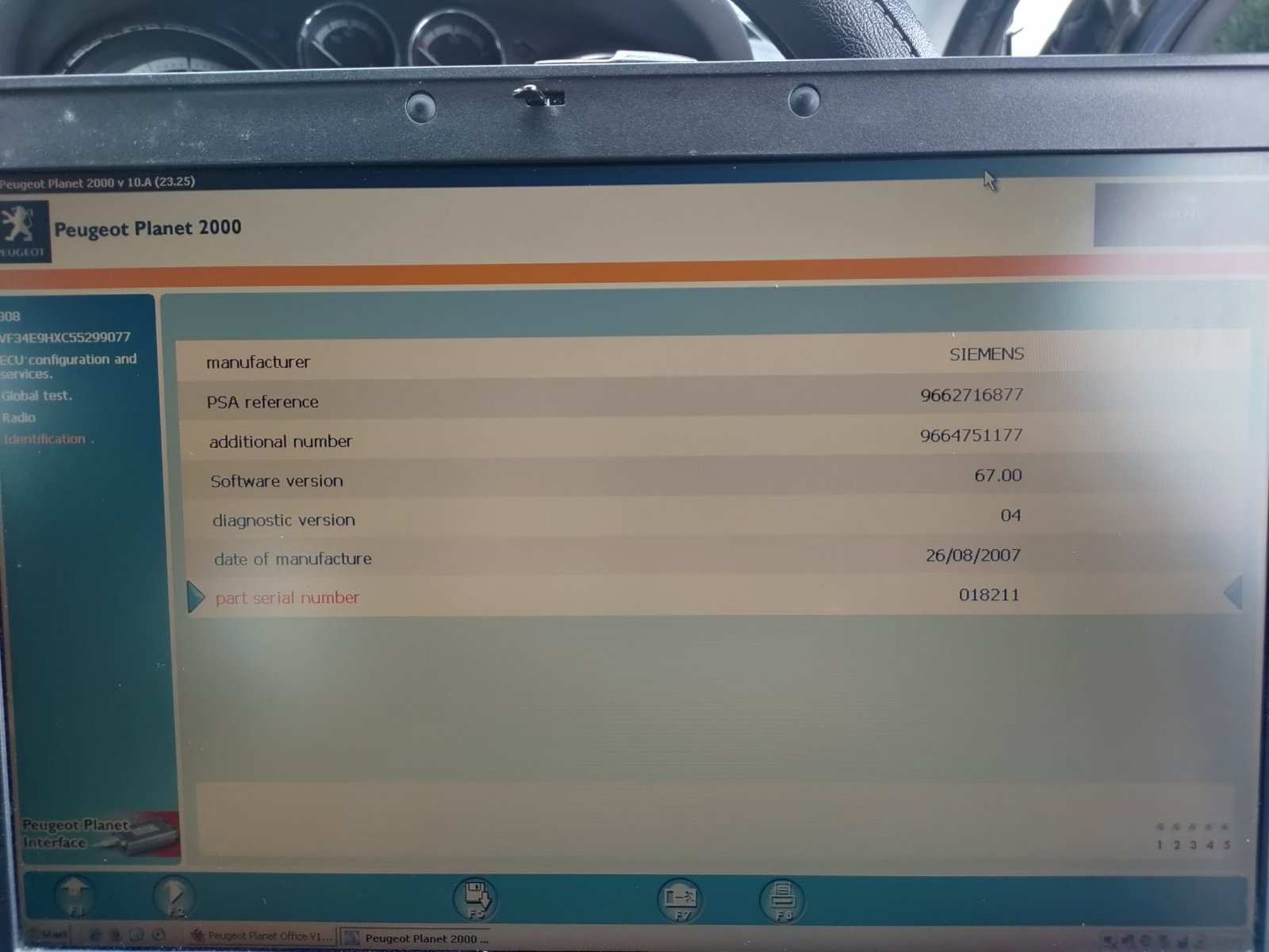

I've included a couple of snaps of the configuration options from PP2000 in hope it might help with solving this mystery.

Do you have any similarly helpful advice on how I could go about troubleshooting the no audio radio issue on my original RD4 (before it goes in the bin), does the configuration options from the attached snap above appear as it should be?

There's quite a few other options not showing in your picture that may need looking at, as you only have the input / output screen visible.. For this specific section the Aerial No 2 configuration is incorrect. Aerial No 2 must be set to 'Passive Aerial' for units with single tuners.

Thanks again, I can try that and give it another whirl with the factory RD4 unit, are you able to provide me with any further guidance as to which other config options screens I should be looking at whilst I've got the laptop and lead hooked up and I can grab some more snaps whilst I'm there?GiveMeABreak wrote: 18 Aug 2022, 17:02 There's quite a few other options not showing in your picture that may need looking at, as you only have the input / output screen visible.. For this specific section the Aerial No 2 configuration is incorrect. Aerial No 2 must be set to 'Passive Aerial' for units with single tuners.

To do that I'd need your VIN (automasked on post submission), then a screenshot of each of the pages of the RD4 configuration, which will be easier for me to check through and tell you what isn't right than the other way round.

CD Changer: Change to Absent
Lo/dx sensitivity curve: Set to Graph / Curve 2
CD Text: Set to Deactivated for Mono Tuners
