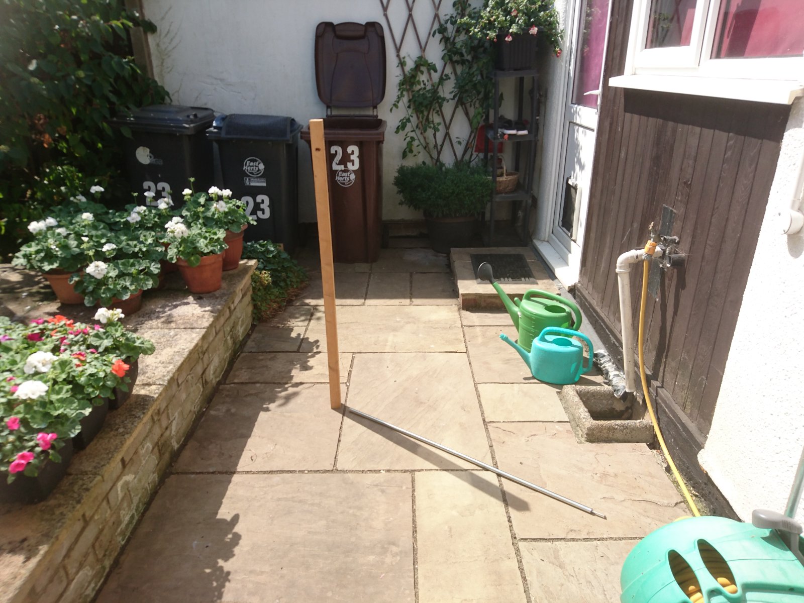

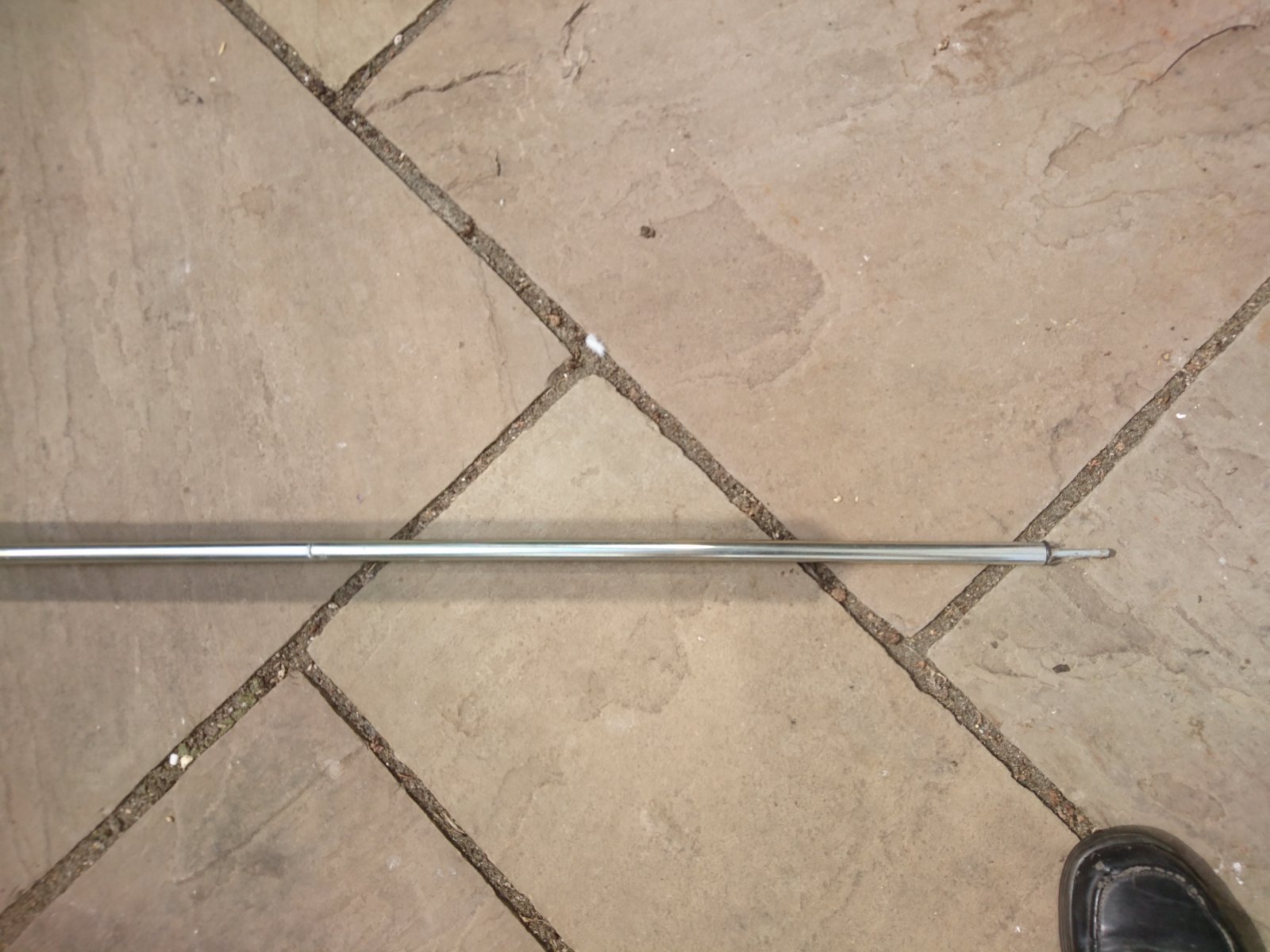

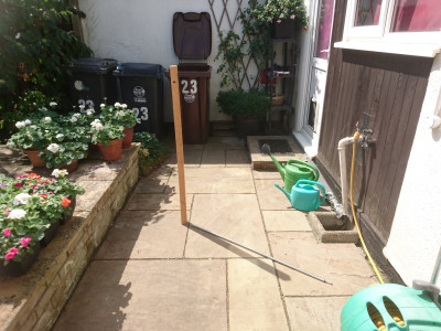

So I decided to do some measurements today a) to identify true South and b) to confirm the pitch of the roof.
I set up a very simple device to determine true south:

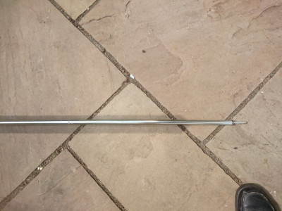

Then all I had to do was roll the tent pole in line with the timber shadow at 13.00 and photograph the position:
I then made a note of where the pole's line meets the patio wall and the house wall so in future to check South I simply join those points with a line which will then be laying north-south!!
Now for the pitch, or maybe not, too hot to get the ladder out so that can wait for another day!!

It doesn't matter if it's not spot on Mick, our panels are facing south east just means you get max power earlier in the day but they are still good for the rest of the day.

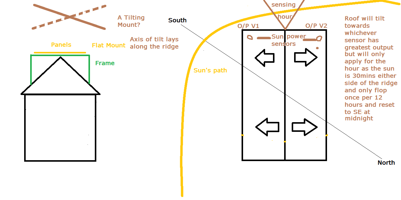

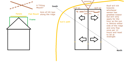

Having dragged myself away from the infinity thread and discovered true South I got to thinking about my panel array. A picture is worth 1000 words so here's my preliminary thinking:

I understand that Peter but it is an engineering challenge to maximise the output. Bearing in mind we have in house metal fabrication skills and step motor control technology in our pocket I fancy trying the idea out, although I do foresee planning issues arising !!Peter.N. wrote: 14 Aug 2022, 14:05 It doesn't matter if it's not spot on Mick, our panels are facing south east just means you get max power earlier in the day but they are still good for the rest of the day.

Fair enough, do what makes you feel best.
