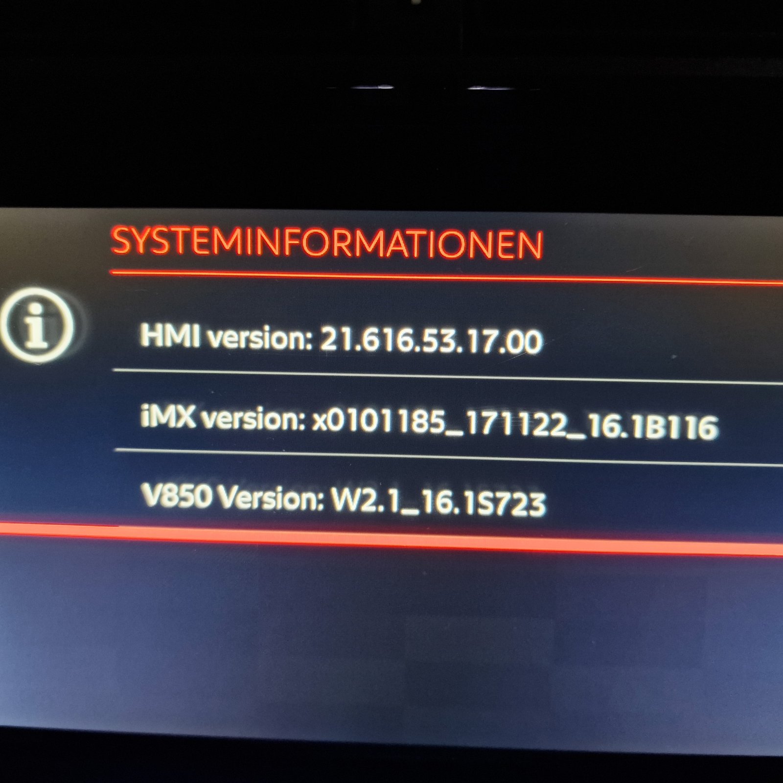

I have the same model car with a wave 2.1 NAC and MirrorLink but I can't find the correct link to the update to enable Android Auto and the Update link provided by Citroen with my vin number doesn't work
can anyone post the link to the latest wave 2.1 firmware here?
Some more info about psa version:
HMI version: 21.616.53.17.00
imx version: x0101185_171122_16.1B116
V850 version: W2.1_16.1S723
software version: 074C
thank you in advance

That looks like an RCC unit (not a NAC).
If you are not sure, pop your VIN up, but you are 2 updates behind:
1_075_16.1B116 (3rd December 2017)
1_076_16.1B116.4 (26th June 2019)
I will send you a link via Private Message.

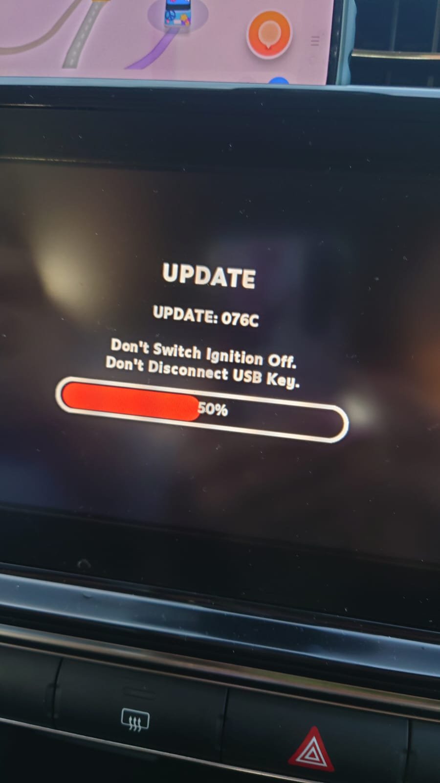

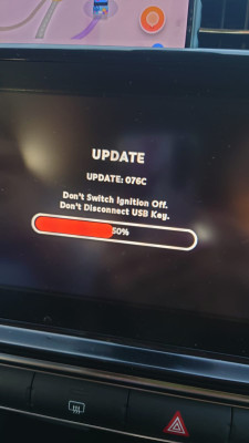

I'm now with a new problem. At Marc's suggestion I decided to download it through the my Citroen app.he downloaded the 4gb update and prepared my usb pen 16 GB. I went to the car and started the update from 0 to 50% was fast. but then the problem started. after almost an hour and a half without passing 50 the radio restarted and went back to the beginning of the update. again standing at 50. I don't know if this is normal. to what should I do. Has anyone had the same problem? Now I don't have air conditioning. Help

Ok, first I would try another USB key (in case there is an issue with it) as over time these can fail as the memory cells start failing. Also, check the download file has not been corrupted.

through the app only option 076c appears to download. the usb pen The one I used was relatively new but I've had it for a few years.So he decided to buy a new, faster one to test. As soon as I receive it, I will do the procedure again. I decided to buy this will be a good usb?

I suggest, you get the file downloaded again, then extract the compressed file to a new folder on your PC (don't use a MAC), then copy the contents over to the USB, remove the hidden system files and try again.

Hello everyone, I come to update the situation. the usb pen arrived yesterday, and I did the procedure again through the Citroen software. on a pc with Windows 10 Installation was quick. Arriving at the car, the update installation was quick, lasting 15 to 20 minutes. Everything is already working normally and Android auto is already active and working without problems.Thank you so much for your help Marc.
