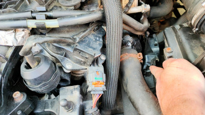

Hi folks. I'm by no means a Pro at all but got enough knowledge to at least know there is a problem with my van.
2105 2.0 hdi 130 L2H2 176k miles. Full Service. Ex Euro Car Parts van. 6k in receipts including new Clutch last week and Turbo less than 10k ago and EGR in 2020 or 14k miles ago.
Erratic rythmic idle but the needle is steady RRrrrRRrrrRRrrrRRrrrRRrrr. Intermittent jerking and stuttering at low revs or pedal position. Boost is fine in lowers gears or lower speeds but loses it later on. 0-60 takes 20 seconds or more. No Smoke (sometimes at startup it's chuffing white smoke that doesn't appear to be un-burnt diesel but can't confirm-could it be coolant from EGR?) No Engine Light and No Codes showing on my el cheapo VGATE ELM327 scanner. I'm using the FAP software from Amazon. So far I've checked for vac leaks, but I've got a vacuum testing kit coming tomorrow and booked in for a full Live data Diag on Tuesday next week. I've been trying to figure this out for 3 months. It Starts Runs and Drives. I bought it like this from the dealer who refuses to acknowledge there is a problem. The dealer is 2hrs or 110 miles away from me, However he did recover it and replace the slipping clutch. It also had an injector leaking which he fixed but must have been like that for some time as the entire top of the injector seating area is covered in a brown carbon/tar covering.
I've recently changed the Air and Fuel filter, brand new MAP and MAF. Air Dozer is clean like new and in the receipts the Inlet manifold was stripped and cleaned about 10k ago (but long enough to clog again I guess).
However, before we start down a Rabbit Hole, let's start from what I can immediately observe using OBD2 and the FAP app. I'll add the readings in the next post.
DPF 90% Cinder (it Regens fine but the left over cinder count is 90%-numbers suggest 17k miles before DPF 100% blocked). a quick Diagnostic 3 months ago showed massive backpressure, but it wasn't confirmed.
EGRBypassInstruction 0% EGRBypass Position 100% (In Red) constant. While the EGR Instruction request changes as I drive, the EGR position shows at 100% for the entirety, either at Idle or while travelling.
The EGR vacuum pushrod can be moved by hand but does feel a little gritty in operation, however it appears to have full travel and does show vacuum at cold start which releases to default position when warm. Readings from OBD2 don't change. I don't know what the default position is; Open or Closed? What does Open or Closed represent? What is Default Position?

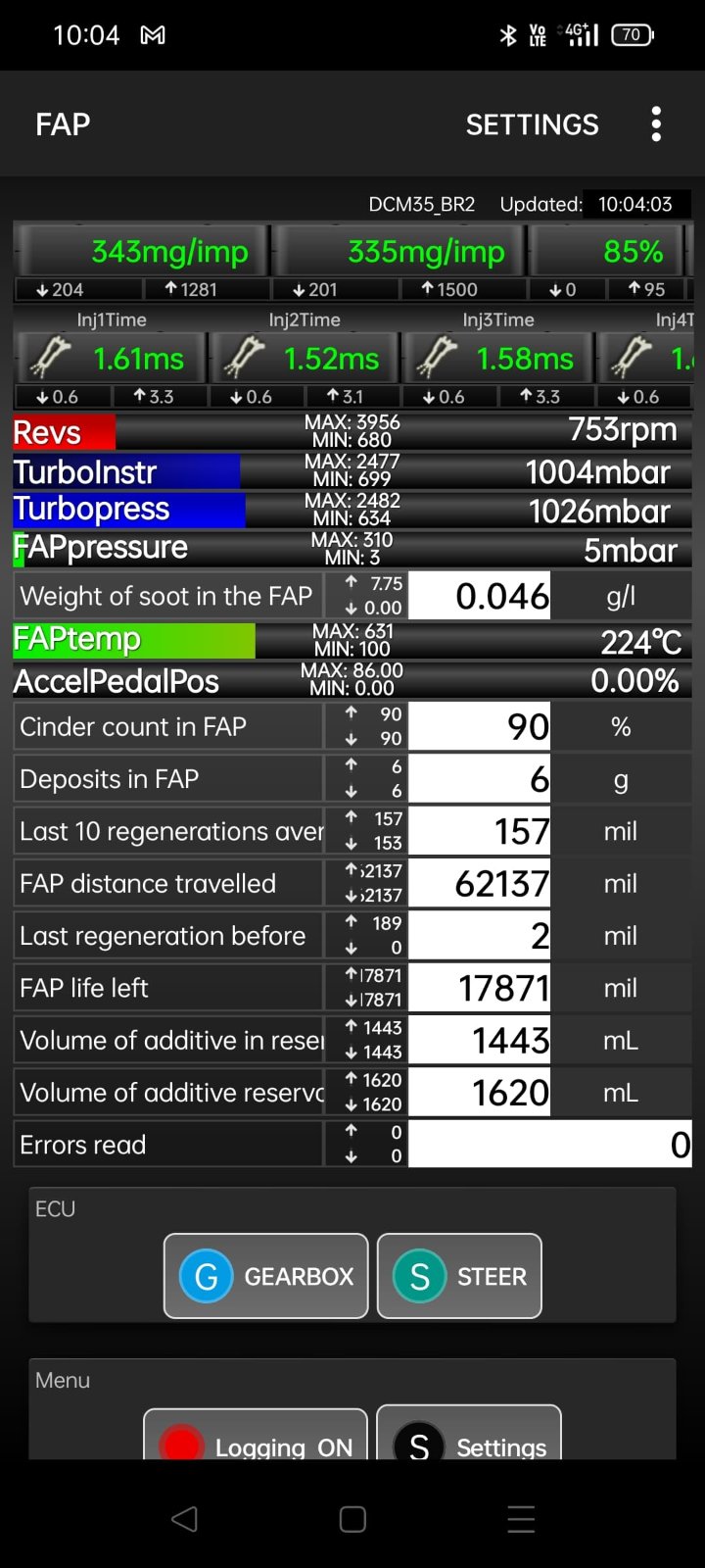

Thanks for your reply, Marc....I forgot to add the FAP readings and also mention that I've had tit on my neighbours 1.6hdi of same year and his readings are all 0% in green, where my EGRbypass Pos is 100% Red constant.
I'll post a full screen image soon.

Sorry folks I meant to add this info in the initial post. It has just completed a Regen in the last day or so.
- x 6948
Re: EGR Bypass constant reading of 100%. Poor acceleration
Ok, so I think we can ignore the DPF as that looks OK to me.

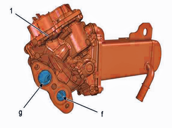

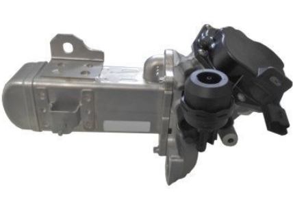

I think this will be the DW10CD engine and my thoughts are that this is a combined module Richard and can't be separated, so the cooler is integral to the module and given the dodgy always open reading, that's where my thoughts lie.
Yes, Marc that is the part on my van. Water cooled.
As Marc has said, Richard, the Cooler is part of the unit and the Valve in question switches gas to either Cooler side to be used for turbo, to Warm side to be used for Cold start etc. and is to be used freely through the driving cycle to regulate cooled airflow to turbo. you are reading the EGR values which seems correct, but the EGR Cooler Bypass is in question here. It may or may not contribute to my symptoms.
What I don't know is what the default position is. Does it start Open or Closed? What does Open or closed represent? I am going to assume that as the readings from the Scanner show 0% while running but increases when accelerating that this means the Cooler is in Operation to supply the Turbo with cooled Air. So the request from ECU to EGR Cooler valve might be working but the response is stuck at 100% but no Engine light....and it's been like this for 1500 miles!
I ask the default position as the vacuum shaft rod is extended when engine off or warm, but on a cold start it actuates to either an open or closed position. either way when it is warm the vacuum is relaxed. For this reason I believe the valve itself may be working, so it could be a sensor within the unit or ECU fault as the 100% value never changes.

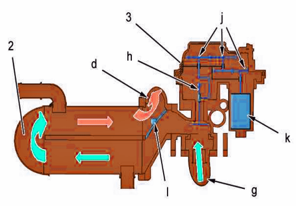

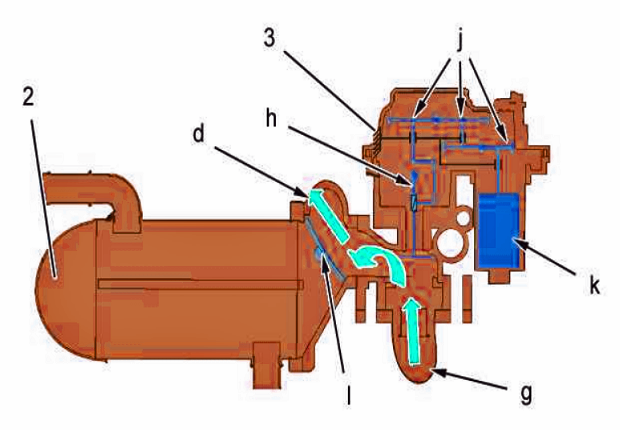

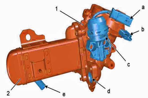

Interestingly, on the DW10CTED4 engine fitted with this module, programming is required if fitted or replaced.....
This gives a little more info on the unit that may or may not be of use concerning it's operation and the stages:
1) Electrically-controlled exhaust gas recycling valve (With integral position copy sensor).
(2) Exhaust gas recirculation heat exchanger.
"a" 3-way blue connector (Position copy sensor for the EGR heat exchanger by-pass flap).
"b" 5-way blue connector (Electrically-controlled exhaust gas recycling valve).
"c" Control capsule (By-pass flap with integral position copy sensor).
"d" Exhaust gas outlet.
"e" Water entry.
(1) Electrically-controlled exhaust gas recycling valve (With integral position copy sensor).
"f" Coolant outlet.
"g" Exhaust gas inlet.
Make: VALEO.

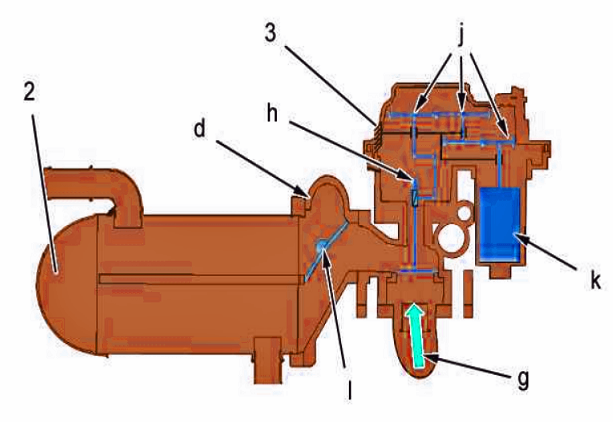

(2) Exhaust gas recirculation heat exchanger .
(3) Body : Exhaust gas recycling valve (EGR).
"h" Valve : Exhaust gas recycling valve (EGR).
"j" Gear wheels.
"k" engine.
"l" By-pass flap/Exhaust gas recirculation heat exchanger .
Exhaust gas recycling valve closed: No recirculation of the exhaust gas.
Exhaust gas recycling valve open - By-pass flap/EGR heat exchanger closed (By-pass position)
(3) Body : Exhaust gas recycling valve.
"h" Valve : Exhaust gas recycling valve.
"j" Gear wheels.
"k" engine.
The motor of the EGR valve is controlled by an open cycle ratio (OCR) signal: Opening of the EGR valve is proportional.
Exhaust gas recycling valve open : Exhaust gas recycling.
By-pass flap/EGR heat exchanger closed:

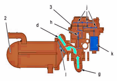

Exhaust gas recycling valve open- By-pass flap/EGR heat exchanger open (Exchanger position)
(2) Exchanger.
"j" Gear wheels.
"k" engine.
EGR heat exchanger open:

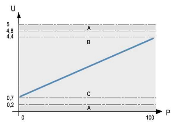

Signal from the EGR valve position copy sensor
"A" Diagnosis zone .
"B" valve open.
"C" Valve closed.
"U" Voltage ofthe signal in volts.
"P" Position of the valve (%).

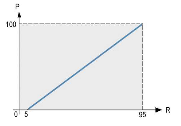

Control signal of the EGR valve
"R" RCO control (%).
N.B. : OCR = Open Cycle Ratio.

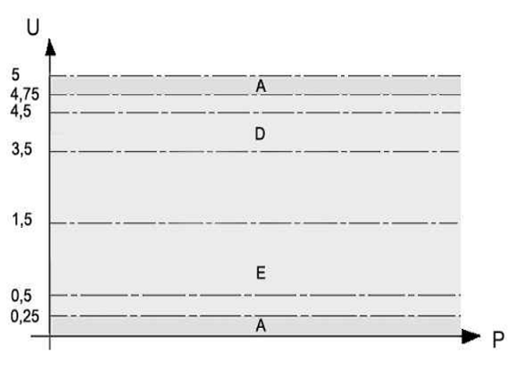

Signal from the by-pass flap position copy sensor/Exhaust gas recirculation heat exchanger
"D" By-pass mode.
"E" Exchanger mode.

(2) Exchanger.
"j" Gear wheels.
"k" engine.
- The recycled exhaust gases pass through the EGR heat exchanger
- The recycled exhaust gases are cooled
"B" valve open.
"C" Valve closed.
"D" By-pass mode.
"E" Exchanger mode.

Firstly let me just say..wow and Thank you.....where do I get access to this kind of info????
However the unit is a Valeo brand but differed to this as it does not have the extra sensor a blue 3 way.
I believe my engine is DW10CD PEF 94KW DTR 1997 DIES.
It appears that EGr may be from a Euro 6? where mine is a Euro 5. The flap is Vacuum activated. This one appears to be Electronically actived.
