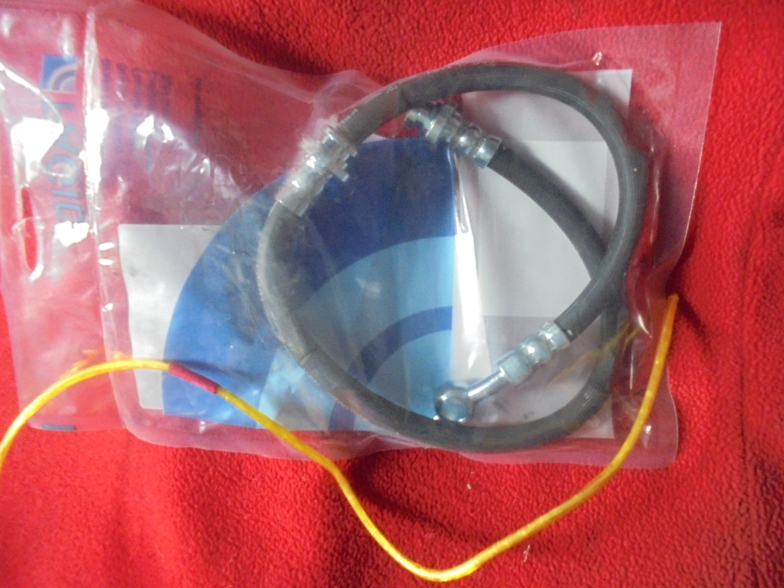

NewcastleFalcon wrote: 03 Aug 2022, 11:52 Optical illusion.
Curled up brake hoses in a packet look much shorter than the hose you need. Before opening up the packet, and maybe facing a bit of hassle returning it if it indeed was the wrong length, I measured it with a clothes line, on the car, and in the packet and it appears to be roughly right.
That has got to be the ultimate in Bargain Basement motoring, didn't even use a dress makers/fabric tape, washing line wins!! :rofl2:
