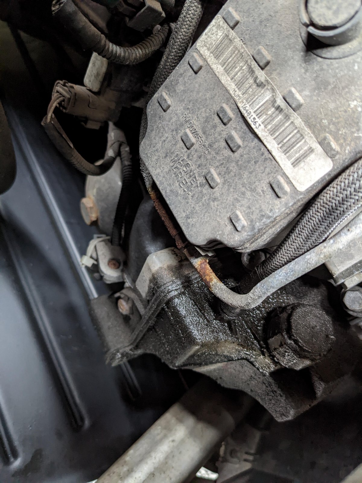

I had removed the engine undertray because I was replacing it as the old one was split and hanging off.
I noticed a large oil patch on the left side of the vehicle (opposite side to the engine oil).
I looked in the engine bay and saw some kind of leak all over the top of the gearbox actuator reservoir.
I suspect it may be the high pressure hose.
Can anyone tell me how to remove the hose (both ends), as the upper end is difficult to access, and the lower end doesn't move at all by hand. Do I need any special tools?

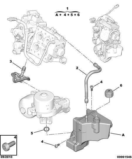

It's part number 2 in this diagram;
Is this something I can replace myself, or is this a garage only repair?
The part number for the hose is - 2090 38

So now I'm thinking that it may not have been an actuator oil leak (despite my photo in first post).
I'm thinking it may be a brake fluid/clutch fluid leak from somewhere. Or maybe even a gearbox oil leak.
I'm not getting any warning on my dash, and Diagbox doesn't find any error codes - but there is some kid of leak somewhere as I had a large patch on my undertray, and the actuator reservoir is visibly oily on the outside.
So I'm still hunting.
