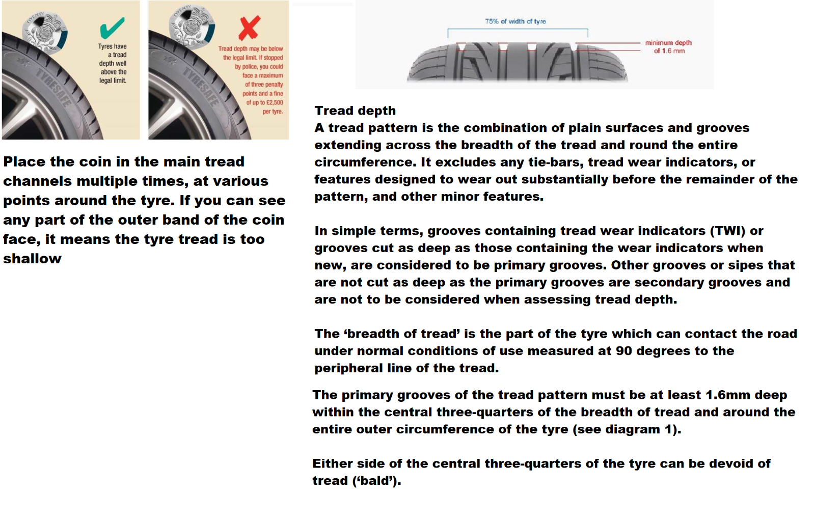

I have been out with my 20p and to my eyes, I'll call them the main circumferential grooves, are all legal according to what I have assessed from this info. The bit on the right is from the MOT Testers Manual and I see it specifically says
"Either side of the central three-quarters of the tyre can be devoid of tread (‘bald’)." Obviously not that desirable, but worn looking tread patterns on the edge not a fail point.
