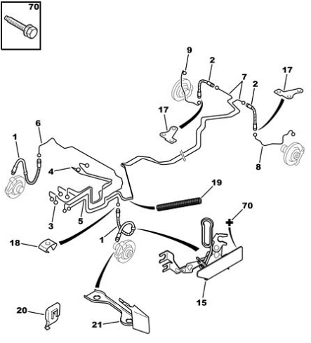

Which brake pipes Sean?

The rear right and left. But i do see that pipes are in sections.
They are 'heavily corroded'. Have already been several advisories for them.
- Posts: 42019
- x 6955
Re: C5 MOT fail, some repair advice.
(1) & (2) Brake Hoses are availableseanrx wrote: 06 Jul 2022, 18:07 Front offside shock with serious fluid leak and excessively corroded brake pipes.
(3), (4), (5) & (6) Not available.
(7) Is available.
(8) & (9) No longer available.

But for pattern parts, they are available to buy?
I've seen complete brake kits for sale and parts from several online dealers.

These are the part numbers for the ones available and the Citroen prices as of today VAT inclusive.
(1) OEM 480697, £24.82
or Cheaper 1623256580, £16.81
(2) Only Cheaper alternative available, Part: 1623256580, £16.81 (same as alternative to (1), but although it may be a different shape it will still fit and is what Citroen bring up).
(7) Set of brake pipes have an alternative indicated:
Left-hand pipe Part: 4888EN, £85.80
Right-hand pipe Part: 4888EP, £ 80.65
I can't advise about the pattern parts, but if you have identified the item number on the diagram for which I haven't provided a part number for you, let me know and you can use this to look for alternative suppliers.

Parts 8 & 9, can give me a number please?
I'll return to the MOT garage on Tues to show them this shock and if all okay we can decide on the brakepipes.
On my car, parts 8&9 are'nt so corroded so perhaps can be used again if no choice.
- Posts: 42019
- x 6955
Sure,
(8) is part: 4887N7 (DIAM 4 75 LONG 610)
(9) is part: 4887N8 (DIAM 4 75 LONG 610)

If there are break hoses that are unavalable, it might be a worth while idea to put together some plans for running brake pipe to standard pipe ends, to custom made brake hoses, back to hardpipe. Don't be alarmed by the word custom, we're looking at under £25 per hose from this site:
