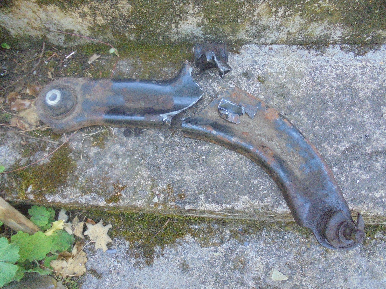

Re: Bargain Basement Motoring
The old lower arm turned out to be OK bushes were still in servicable condition but the ball joint definitely worn out.
Got a new arm from carparts4less. £6 cheaper for the identical same part than ECP, and delivered to the door free. I know there are a few on here who dont rate them but I speak as I find and I am quite happy to use them. With bargain basement motoring and little mileage, I just go for the cheapest that does the job, but there are alternative offerings should you wish to pay more.
£34, and should I have wished rather than a few days for DHL to deliver to the door I could have picked it up from any of the local ECP outlets pretty much the next day if I had chosen collection rather than delivery.
At least the MOT inspector will have some new parts and shiny nuts and bolts to look at as surveys the scene under the car.
