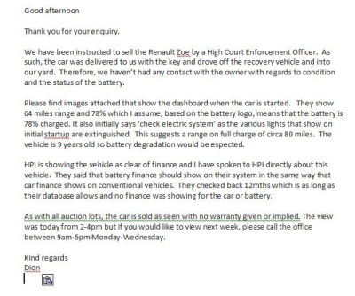

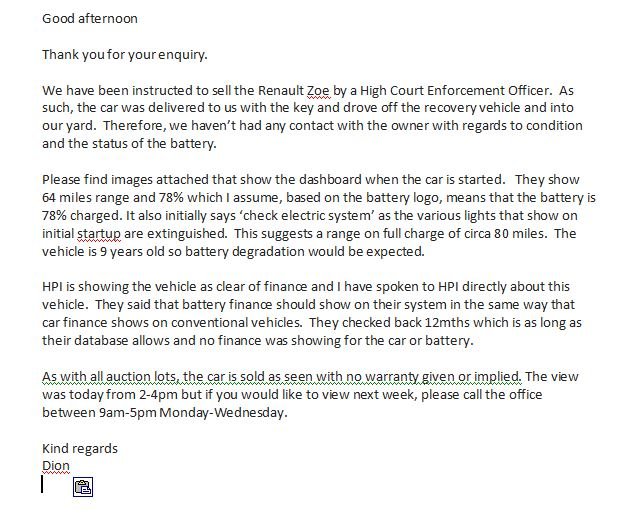

I asked the auctioneer about the battery condition and ownership status and this is his reply:
- Posts: 6847
- x 3566
Re: Used Renault Zoe-can a case be made to buy one?
That's a rather long winded way of them saying : "Caveat emptor".

I take it then that you two don't accept the auctioneers words about HPI check not showing any finance on the battery when normally they do show up?
