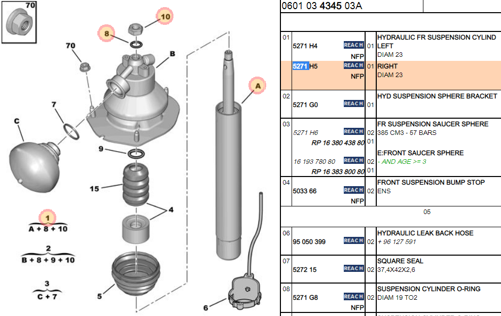

Well unfortunately, both left and right suspension struts are no longer available. If they looked properly, they would know this.
As you can see, the complete strut item (1) indicates 'NFP' (no longer available) from the live database.
The seals at (8) & (9) are also no longer available, but you may be able to order these from elsewhere if the leak is from there.
However, it depends where the leak is. If it is the leak back pipe (6), that is still available and is pretty easy to replace as it's not pressurised. See if you can determine where the leak is coming from first.

Hi Marc.
The leak I locate at top of shock under gaitor.
Around the chrome piston, there is oil but it's not running down leg.
Have cleaned and operated the sus lift, no oil begin to pool. But no actual driving yet.

If a leak back pipe, then that's not technically a suspension fault or that the suspension strut is shot - these pipes sometimes get damaged or nicked and can often, depending on where the leak is, be cut and joined onto the strut or pipe - depending if there's enough slack. As for the top of the strut, then it may be that seal shown at (9) which will need replacing if it's warped / shot to bits.
If it's a weep you may be lucky if it is cleaned up, but it will need doing, apart from being dangerous if it's leaking onto the road (and costly in LDS) of course!

Re: Citroen C5 Shock part number
Am sure it's a weep only, the seal at top of shock outer 'A'.
There is LDS staining, only two inches below bottom edge of gaitor, never seen it so wet to actually run down shock leg.
Retest on Tues, see how it goes.
