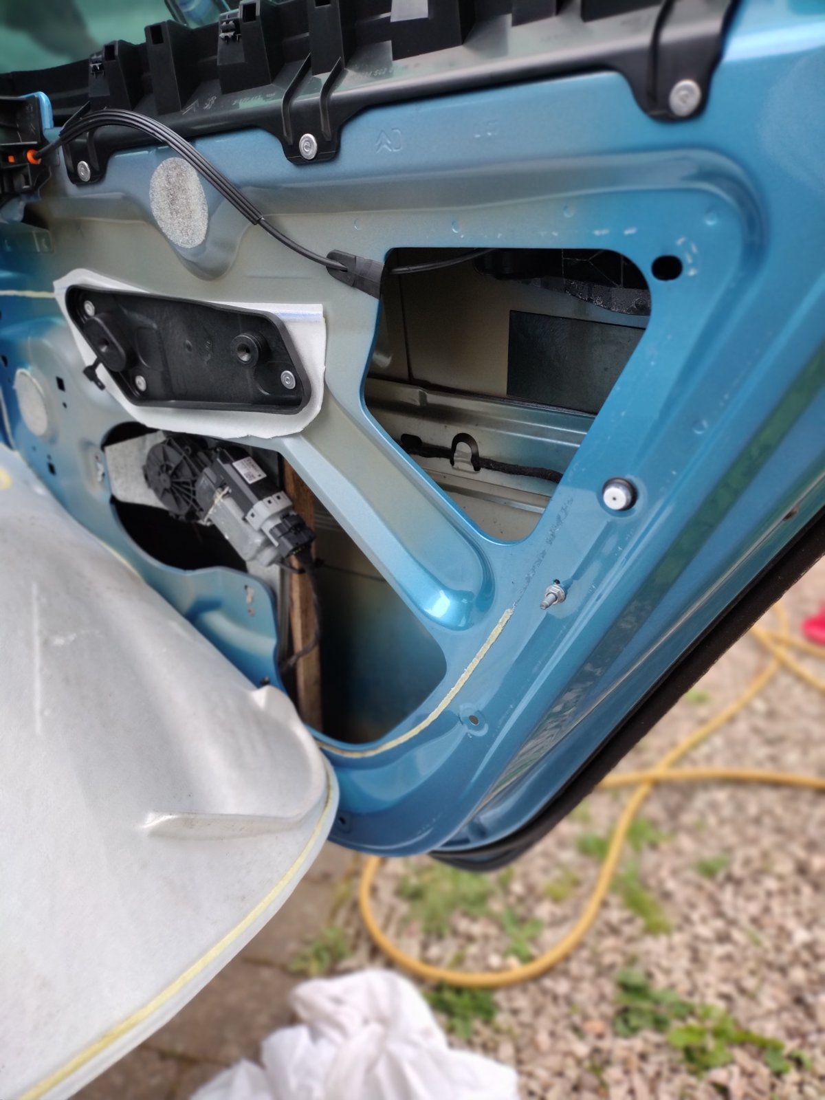

My Sister was here today in her 2011 C4 Picasso, and said the rear driver's side window was falling down. Stripped off the door panel and found as expected the wire a rusty broken mess. Since it's only the rear, and a new mech is £420, wedging it up seemed best. Piece of wood cut to length, wedged in, and cable tied to the upright in the mech. Another 'temporary' repair

If the woods been treated it'll probably out live the car!

Despite all my years in the trade I've never had a close look at these modern window lifters, could the rotted away cables not be replaced instead of replacing the whole caboodle? You could buy a roll of Bowden cable for a small bit of cash.

I've heard of replacement cables for Cs which suffer this commonly on front windows (although I've not heard of one recently), haven't investigated this one, this was just a 'temporary' repair, which is better than the folded paper and window scraper that was holding it up before. Since it is a rear window, the rear is rarely used (except when the scouts were in it and opened it....) so it doesn't really matter if it doesn't work!
