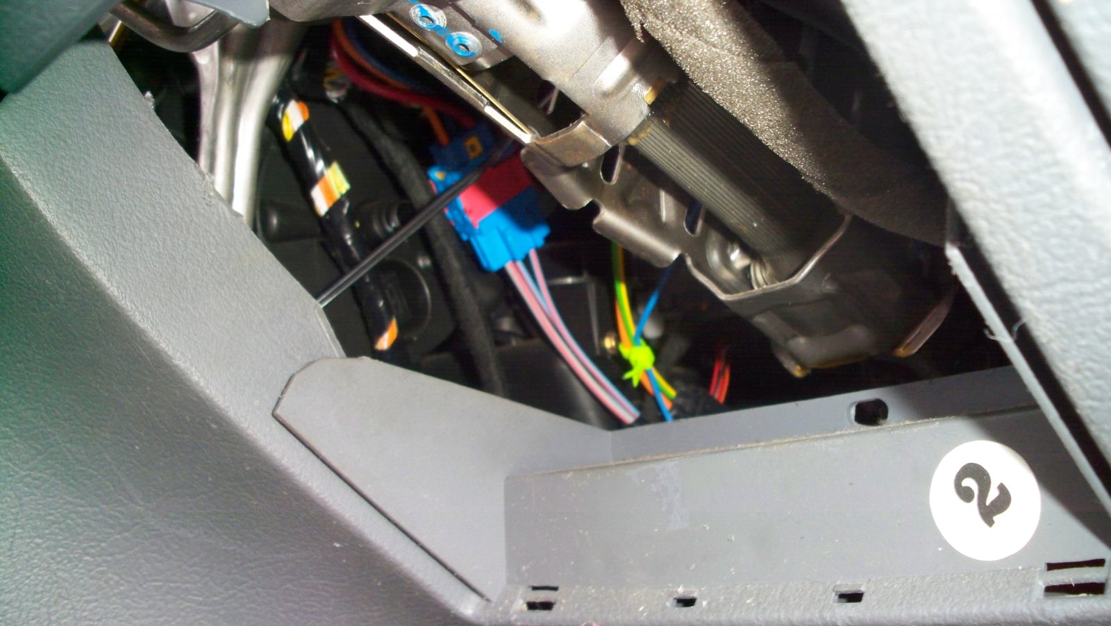

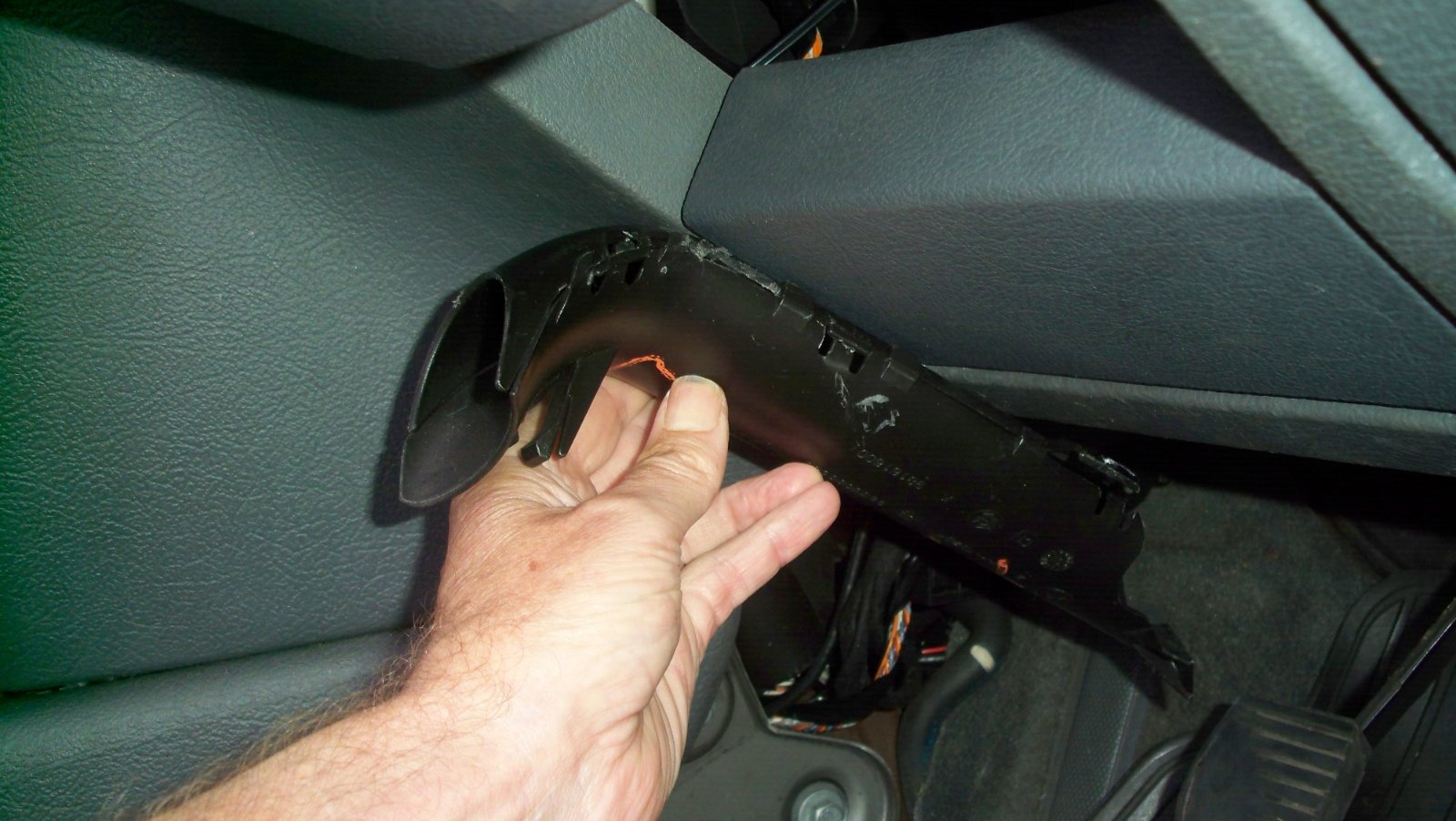

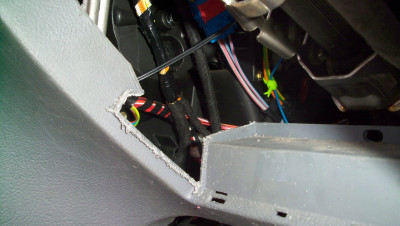

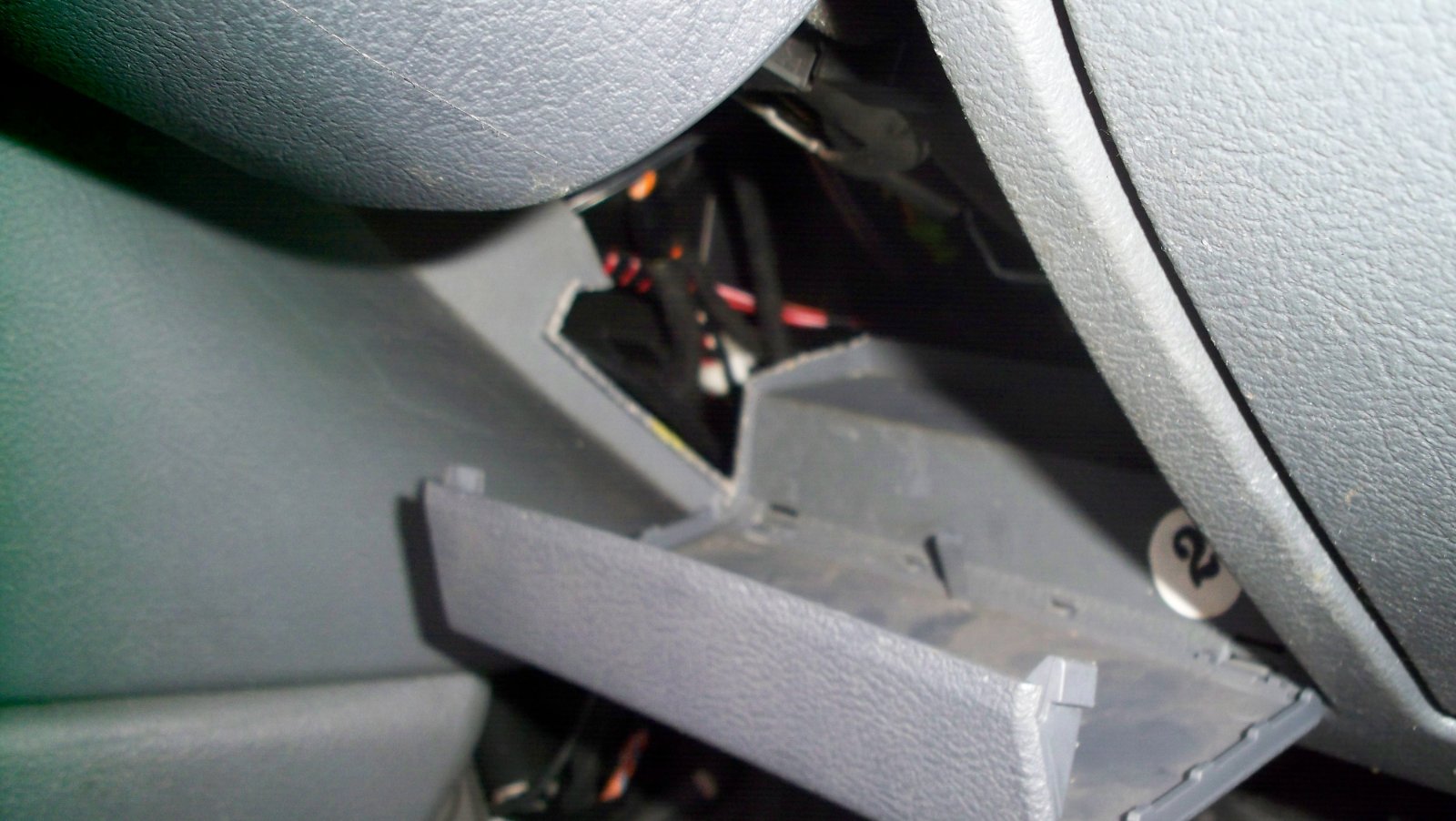

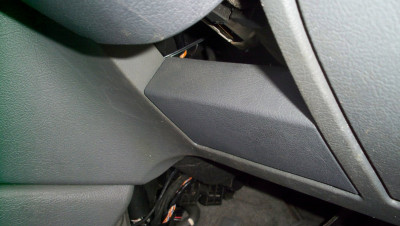

By the way, I gained access to the drivers side mixer/blender motor by cutting away a small piece of the dashboard under the steering wheel and removing a plastic tubular conduit in the dashboard. See photos. The pollen filter and inlet face of the evaporator matrix are clean and dry.

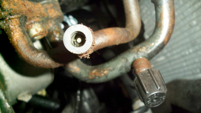

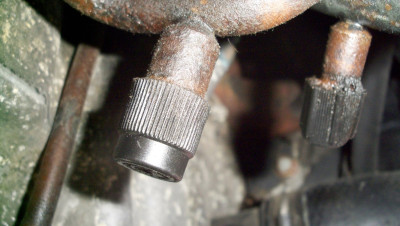

Re: C5 2001 - aircon not cooling drivers side - and rusted service ports

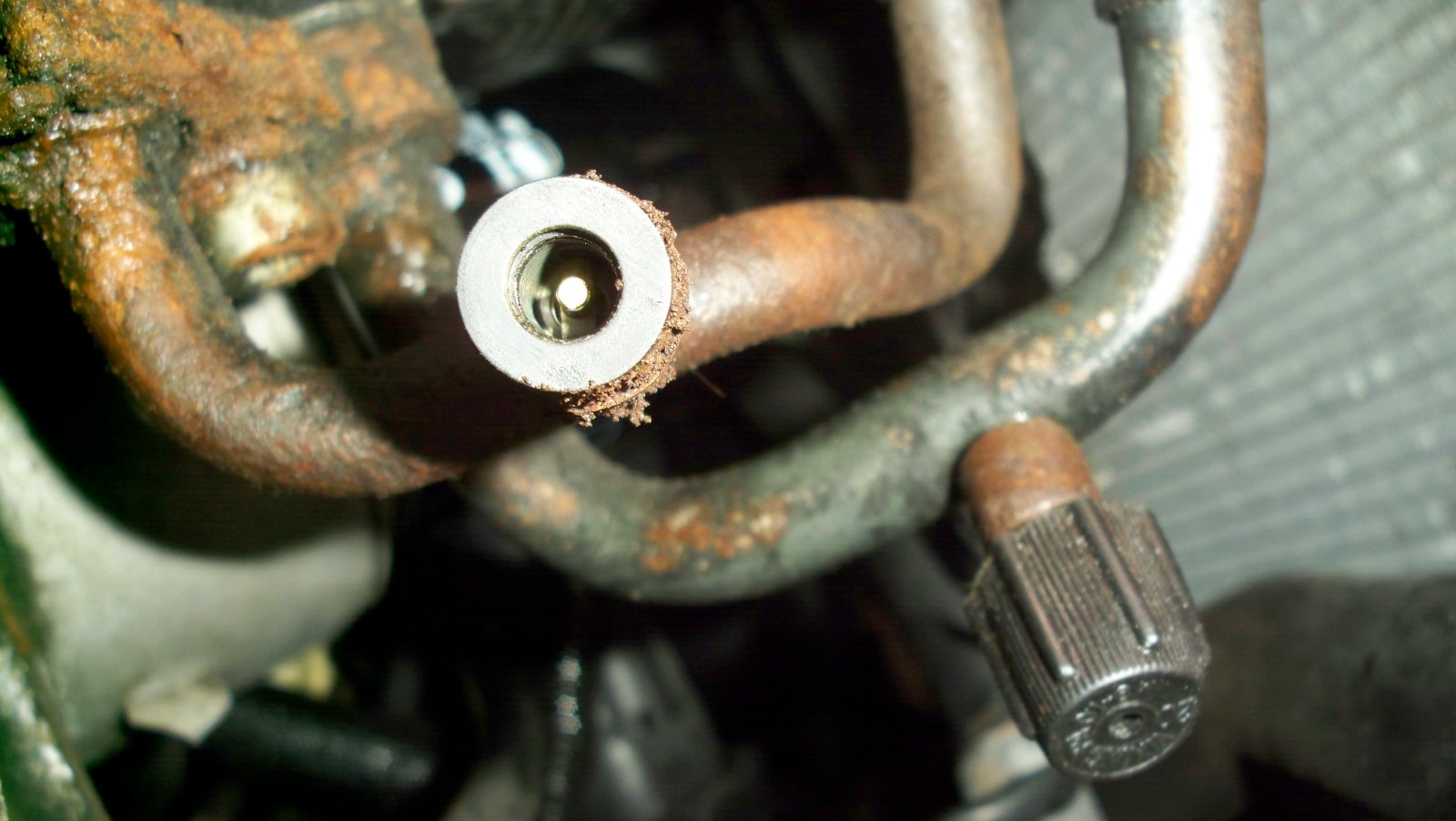

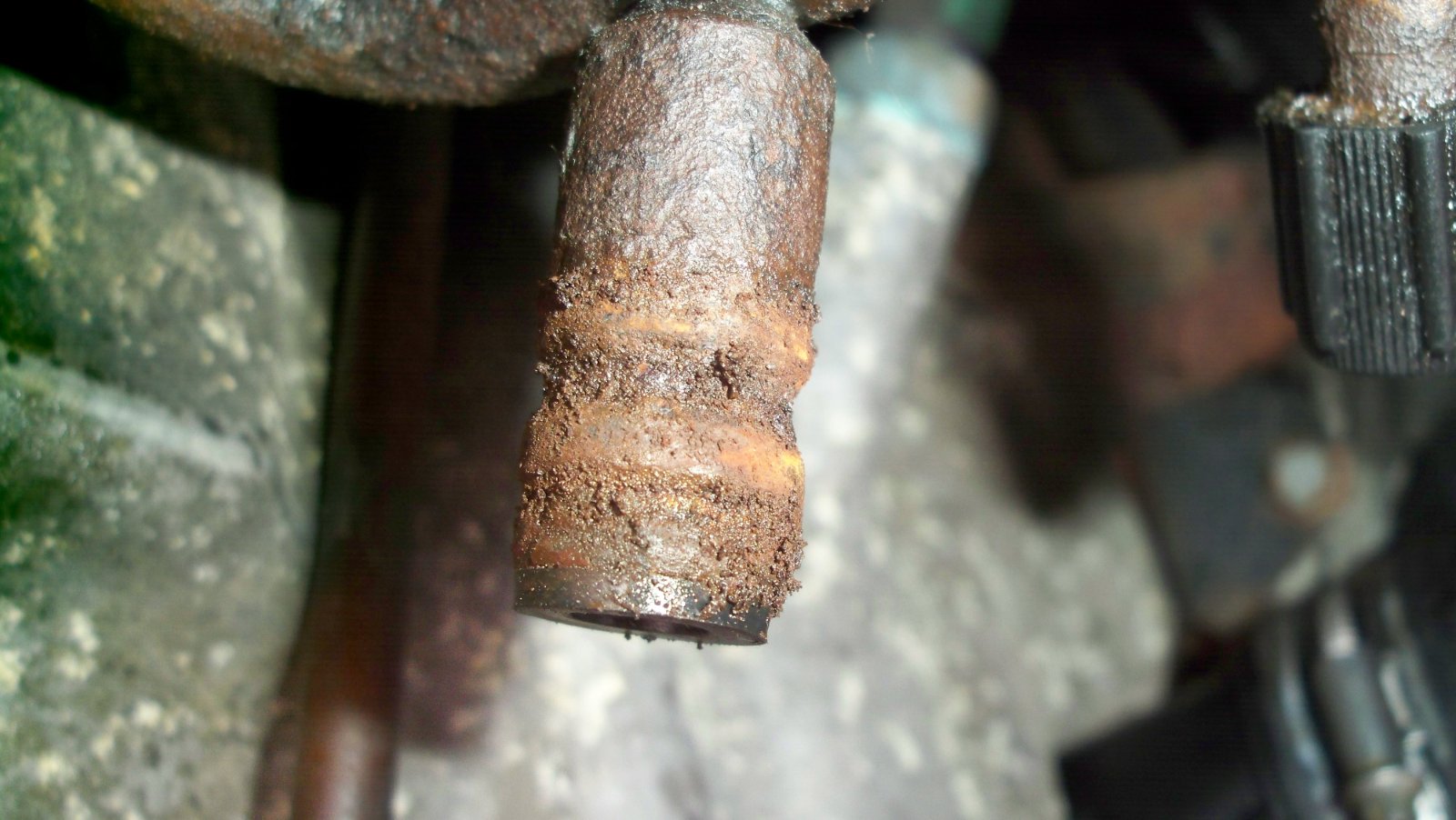

Thanks for all the info. It is always nice to hear from experts in such technical detail. Unfortunately, my first problem is that the service ports are badly rusted . The caps do not protect the external surfaces of the ports....and who thought it a good idea to position them adjacent to the compressor, facing down (with caps able to collect water!) and only accessible from underneath with the under-body panel removed!? Moreover, the expanding rust had split one of the caps. Fortunately, the cap seals have successfully protected the internal M8x1 thread and valve which look fine. I have de-rusted and smoothed the external mating surfaces in the hope that the quick release couplings will still attach and seal when I take it the aircon garage this week.
A note of advice - check the condition of your ports, and add extra anti-corrosion protection to the external surfaces where the quick release couplings attach.

That's strange. The fixed lines are typically aluminium, but those lines are 'rusting' (oxide of iron). Are they steel lines ( I wouldn't think so)? Where is the iron oxide (rust) coming from?
The service ports, and both the high and low side pipes connected to the compressor mounted on the engine, are steel. The pipes attached to the bodywork are aluminium, with the usual flexible hoses joining the two. So, why did Citroen not locate the service ports on the more accessible, and better protected, aluminium pipes?!!! ....or use caps which protected the external mating faces (standard high and low port valve caps do not). Doh.
I de-rusted the ports but they were too pitted for the r134a quick connectors to latch and seal. So, it is impossible to re-gas, or even de-gas. I am exploring options to repair, replace or relocate the ports - I have a plan to utilise thread couplers and r12 / r134a adapters....possibly without even de-gassing. If successful I will post.
