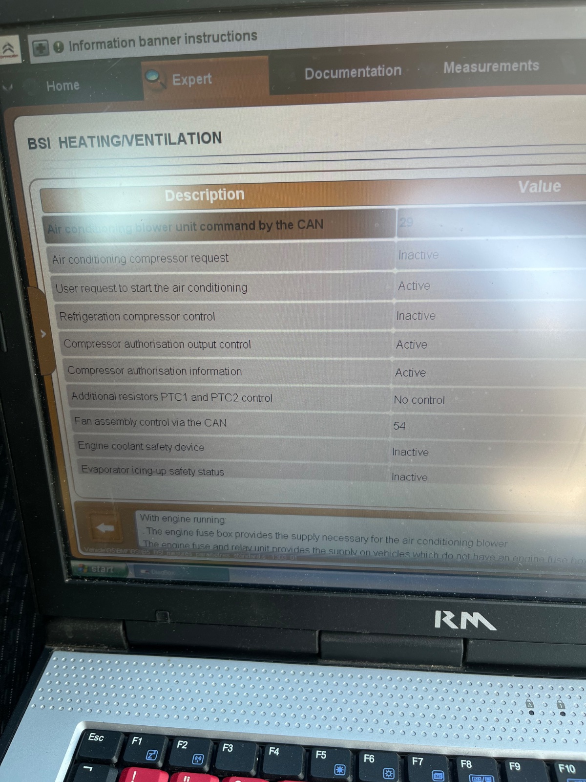

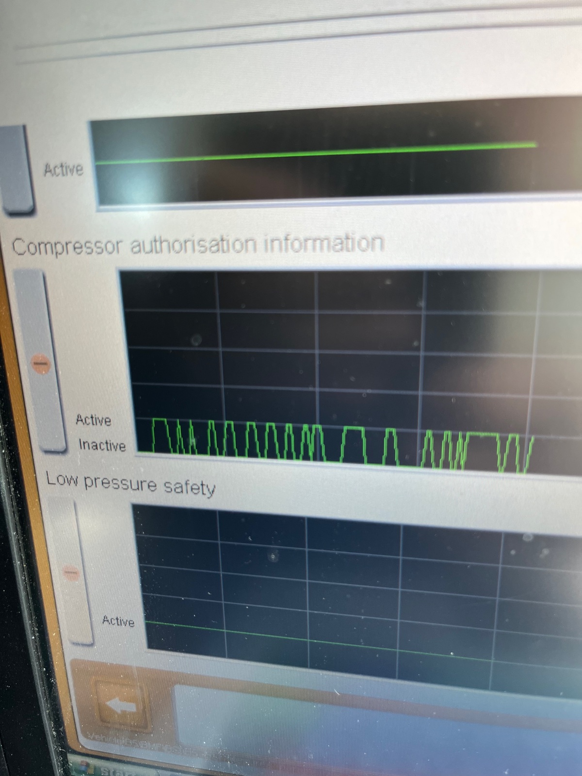

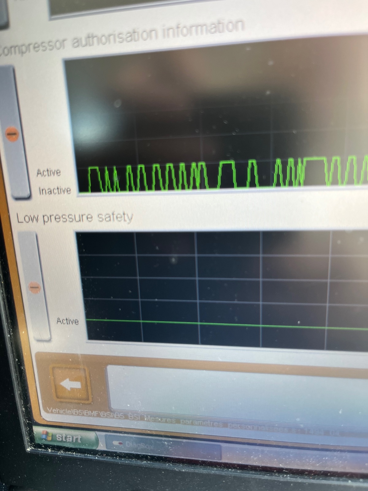

Ok, I have V and earth at the compressor modulator valve feed so this seems fine. I decided to go back to Diagbox and dig deeper with throws up that compressor is blocked due low pressure trigger. I’m starting to wonder if my friendly local garage that said they’d filled the system actually did at all. So before I start delving deeper I will head to another to check if there’s actually gas in it!! You will see from pics there is intermittent start signal which I think is start block due low pressure kicking in but thoughts welcome.

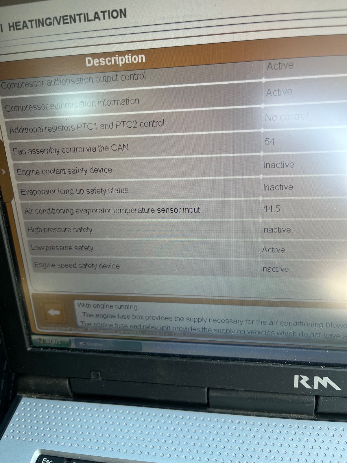

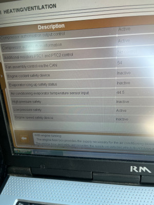

….and low pressure safety showing as active.

Yeah, it's either got no gas in it or the pressure switch / wiring is faulty.

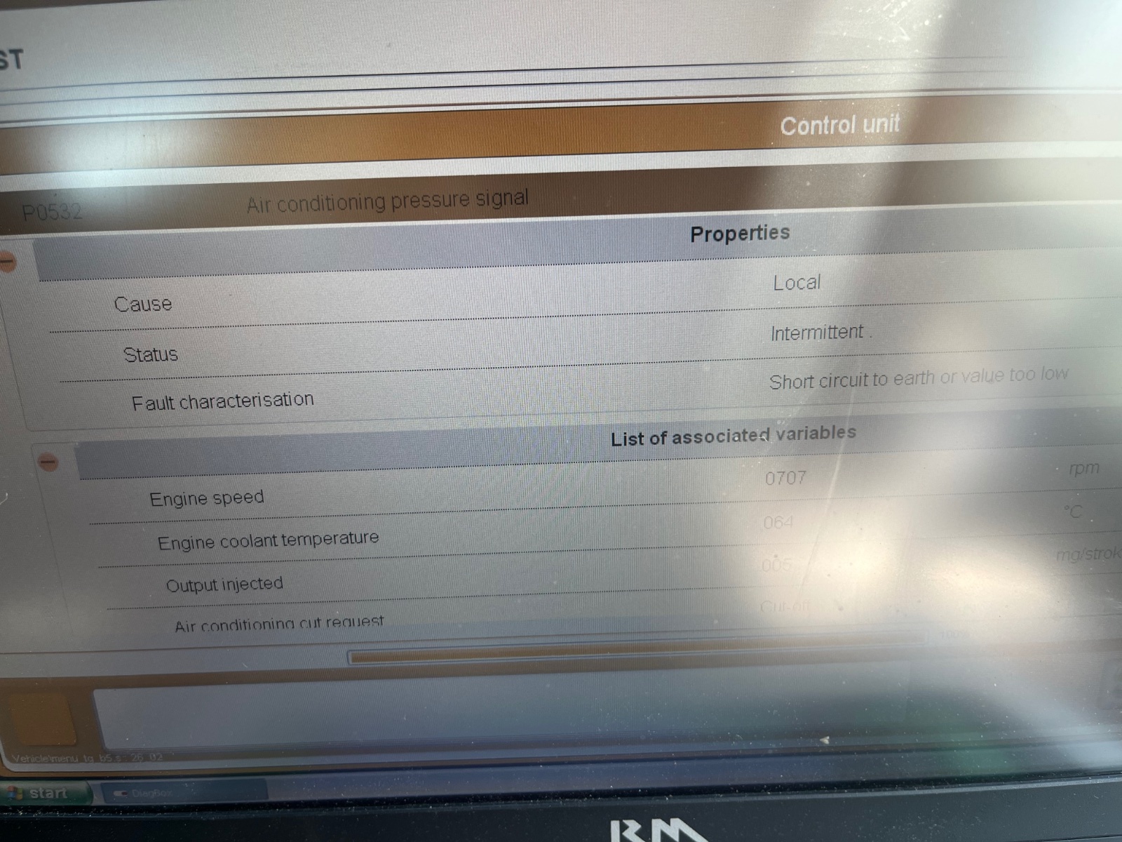

When did the P0532 code popup?
Hard to diagnose things with DUFF GEN.
Yes...what RichardW said!
Tonyl
Posts: 26
Joined: 09 Jun 2022, 12:41
x 10
Re: C4 1.6 hdi 2008 AC fault
Unread post by Tonyl »
DUFF GEN? What does that mean?
That code just came up. I clear codes to see what comes back and then focus on those.
